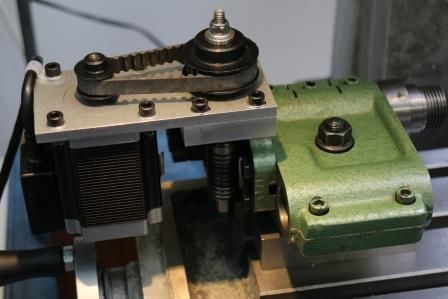

                                    Hello there, I think this is the first time I've posted on here and is definitely the first day of my retirement so don't beat me up cheeky
                                    I've received an email from Gustav asking about the CES hobber and the differential gears and he has pointed me to this thread. When I get back home tonight I will dig out a spreadsheet I did some years ago in conjunction with a chap who had sight of a Jacobs hobber with differential gear. That will maybe help with his question in some way and provide some numbers to show how the primes ratios are formed from normal non-prime gearsets.
                                    Also some great replies on the thread on different ways to do things, and thinking outside of the box. If the 127T gear is for metric cutting on an imperial lathe it may be possible get some really good approximations using standard gears that can exceed the cutting accuracy of the machine without going to primes.
                                    As I'm getting incredibly lazy as I get older, rather than try and concoct some fancy solution to cut a gear I need but will only use once or twice, the 3D printer often gets a workout.
                                    I've attached some pictures, hope they show up. There's a couple of shots of a spare 60T gear on the Myford ML7 printed in ABS and a 127T gear for the same printed in PLA. I'll post again tonight when I've tracked the spreadsheet for the differential down.
                                    Regards,
                                    Duncan
                                    60T ABS gear
                                    60T ABS gear (close)
                                    127T PLA gear

                                        My special aim is not to make a 127 teeth gear. This is only one of the possibilities. My main target is to build up a hobbing machine, which should be able to cut prime number gears to. One reason for this is, that I have made a dividing head last year. Because it should also manage prime numbers, i made a compound dividing head. But when it was finished i saw that the handling was prone to errors. So I have transformed the construction to a differential dividing head. I had to cut 12 gears for this. I made them by poor mans hobbing method. To facilitate and to get better results I want to make this machine.

                                          Duncan, Great to see a practical ME use of printing. Of course a printer is a lot of trouble and expense to make so perhaps on a par with a hobber. But lots of whirling gears – got to be a winner.

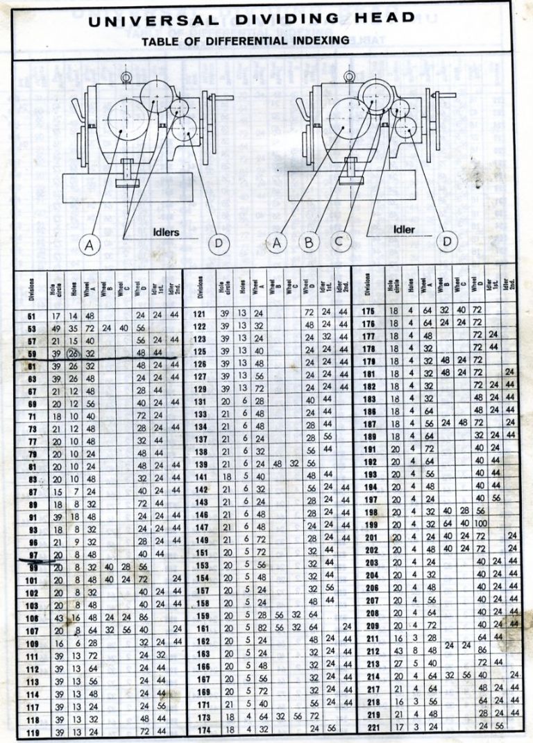

                                          Had a look at the gear trains for making 127 and one option is 125 & 126, but for 126 you need a 63 prime. So you can make a 63 using 60 and 57 – oh dear another prime and so it goes on.

                                            Looking around the professional gear hobbers it appears they often don't have a differential. Instead they may knock up a quick prime as required on a dividing head then use it to give the exact ratio. They are of course into mass production so worth the effort.
                                            Their next option is to find a close, very close, approximation perhaps using 6 or 8 change gears to get an error with 7 or 8 zeros after the decimal point. This will give a slight progressive 'creep' out of sync. However this can be compensated by moving the hob ever so slightly along its axis using another set of change gears.
                                            Even with a differential it may not be spot on. The errors in the two trains can be arranged with one + and one – to partly cancel out.
                                            It is much easier with computers now but in the past you could get tables with eg 14000 ratios from gear sets listed.

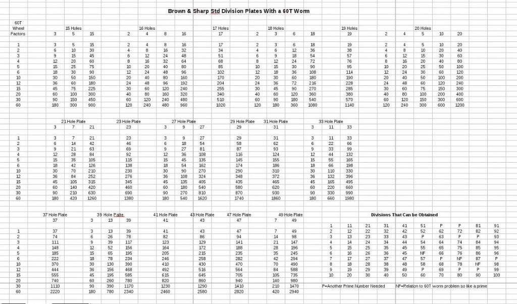

                                                    63 teeth isn't a problem with the plates Brown and Sharp came up with which gives these with 60T worm wheel. They were intended for 40T. I would have thought any design of plate would need the same base primes.
                                                    I mentioned B&S because I noticed some Vertex stuff with parts I could use that also had plates but I wondered why they had departed from the usual hole counts so gave them a miss. I think the Cincinati design had yet more holes. Dore or Westbury went for fewer holes and no 63.
