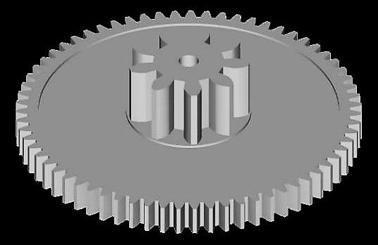

      Hi
      Can anyone in Leicesteshire help with a printing request please?
      I am a premises officer in a primary school in Hinckley and need to repair a broken gear in a projector. I've drawn it up in FreeCad and exported it to an STL mesh. It is a compound gear with 67 and 9 teeth although the 9 tooth gear may be incorrect. I had to work it out from the remnants of the smashed gear. It may be 8.
      If anyone can help we would be extremely grateful. We would of course pay for materials used.
      I've attached a photo and can give dimensions if anyone can help.projector gear.jpg

                        Not wanting to throw water on the bonfire, but with those dimensions, you may struggle to achieve decent tooth definition on the larger gear if 3D printed.
                        With a diameter of 34mm, that means a circumference of about 106.8mm and tooth tip to tip distance of about 1.55mm.
                        With a typical extruder diameter of 0.4mm and the fact that you will struggle to achieve a crest or valley that is not severely rounded at that resolution, I have my doubts as to how useable the print will be.
                        The 8 or 9 tooth part stands more chance of success as the teeth are much more defined.
                        I have printed several gt2 gears/pulleys that have 2mm tip to tip spacing, anything under 20 teeth was unuseable as the tooth definition was little more than a surface ripple and even with 75% of the teeth being wrapped by a belt, it still slipped. Pulleys of 40 or more teeth were useable, but only because of the high number of teeth being engaged by the belt – your application will be in a gear train, where only a few teeth will be engaged.
                        With the original being injection molded, a replacement may be better being cast from epoxy/resin after making the two halves out of some other material and making a mold with them.
                        Begs the question – how much is the replacement part vs cost of materials and time to produce a suitable replacement? Yes, 3D printing the part will be cheap, probably pennies in material costs, but will the printed part actually be useable?
                        You stand a better chance of 3D printing if someone has a powder based printer as this will achieve the required definition on the teeth, but I would then worry about the strength of the individual teeth.

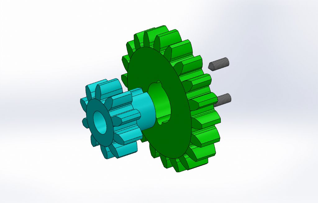

                                          Paul Lousick
                                            @paullousick59116
                                            Make from aluminium and add a spigot to the small gear. Glue together with permanent type Loctite. (You could also sdd scotch keys (screws) for extra support if required.)
                                            Paul

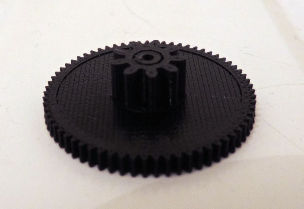

                                            #275718
                                              Some folks will know I'm reviewing a Dremel 3040 3D printer/using it for a 'first try at 3D printing' article. It only does PLA out of the box, but I've had a go at Bodge's gear, using his STL file.
                                              Without spoiling the review, here's the result. It's less than 35mm across, so I'm impressed by this, if not by my photography. It's not imaculate, but I imagine it will work:
                                              <edit> The larger gear meshes perfectly with stock 0.5 mod gears
                                              Edited By Neil Wyatt on 04/01/2017 17:11:54
                                              #275748
                                              Bodgit Fixit and Run
                                                @bodgitfixitandrun
                                                That looks fab Neil. I look forward to receiving it.
