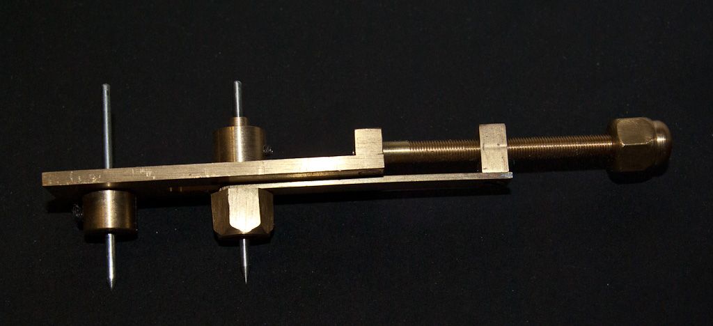

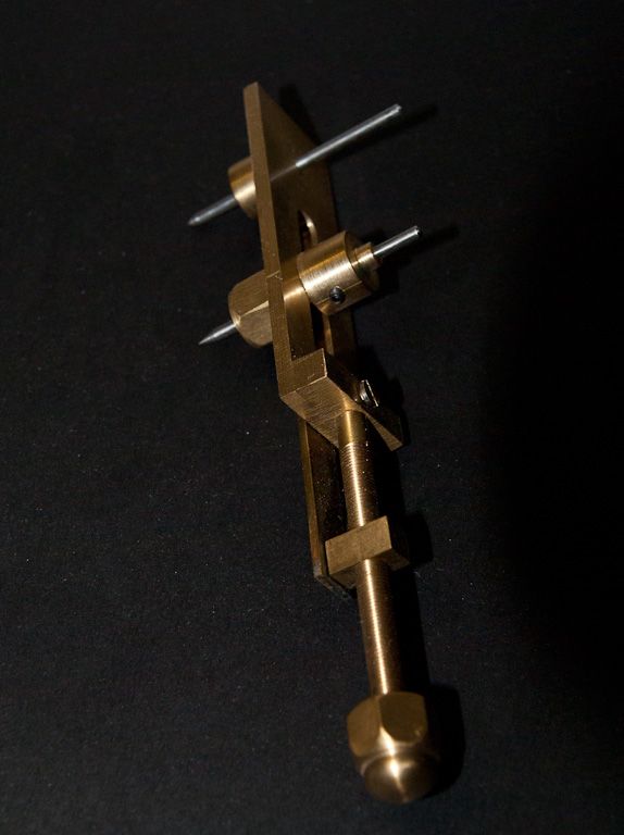

      Hi All
      After making my dividing head, I have now made a depting tool
      Next job will be making a wheel and a pinion to test my tools
      Regards
      Mogens

                      YouraT
                        @yourat
                        Hi Mogens.
                        Nice depthing tool – is it to your own design, or another?
                        How did you ensure the parallelism required ?
                        Cheers,
                        Youra.

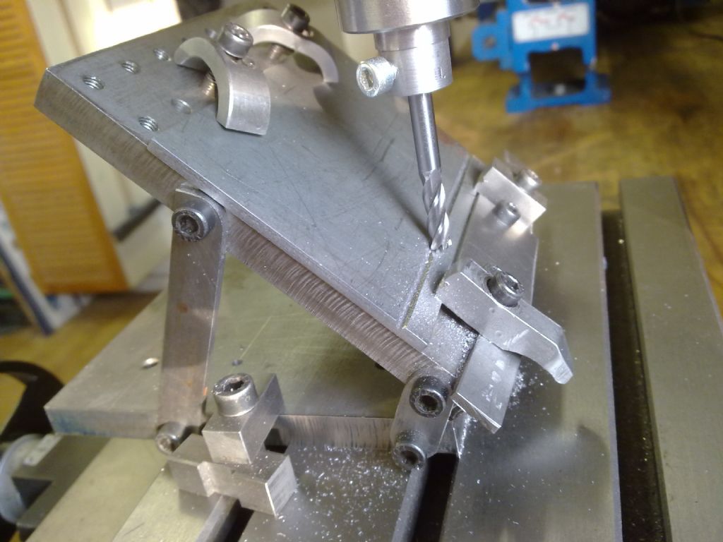

                        #68785
                        Mogens Kilde
                          @mogenskilde92996
                          Hi
                          I made a special fixture for my mini mill
                          Mogens

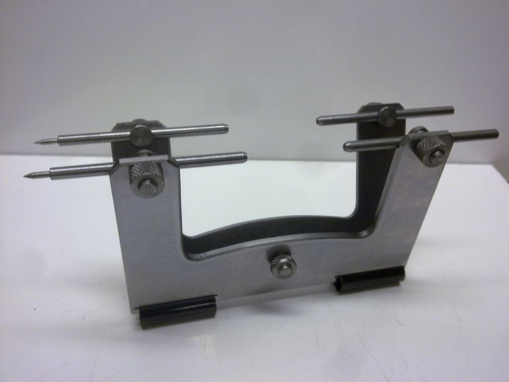

                          #68787
                          Stephen Benson
                            @stephenbenson75261
                            I did not want to upset anyone as
                            you have beautiful depthing tool which would be great for clock repair as well as clockmaking however I did not want somebody thinking they need to buy or make a traditional
                            depthing tool like yours to make a clock from scratch.
                            In most cases it is easier to
                            make the pinion as separate item and then fit it to the arbor later (I use 601
                            Loctite retainer ). The reason being that you can cut more than one pinion at
                            once and it is much easier to harden and temper the pinions if they are off the
                            arbor.
                            I prefer lantern pinions on my clocks
                            as I believe they offer lower friction but there are many that hold the reverse
                            view so the only work in progress clock I have at the moment has
                            lantern pinions.
                            I
                            have added enough views so that anyone could make one there several designs of
                            this tool mine is based on a John Wilding design modified so it can be mounted
                            in a vice.
                            Sussed the insert picture problem I had to scroll up to find the insert picture popup
                            Edited By Stephen Benson on 18/05/2011 16:47:12
                            #68790
                            YouraT
                              @yourat
                              I made a very similar tool when I constructed my first (and, it has to be said, thus far only) clock – also a Wilding design – the Egg Timer. Lantern pinions also.
                              Your vice mounting modification is a good idea – I may need to copy…
                              I still like the idea of making a depthing tool to the ‘old pattern’ as it were – but a fabricated version rather than one based on a casting seems the way to go.
                              Edited By YouraT on 18/05/2011 17:02:41
                              Edited By YouraT on 18/05/2011 17:02:59

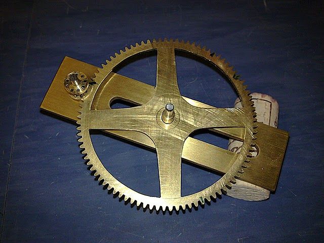

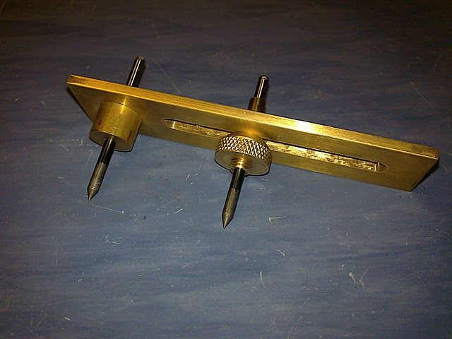

                              #68800
                              NJH
                                @njh
                                Hi Guys
                                Here is my variation on John Wildings theme!
                                I have added a “fine adjuster” as I found that tightening the moveable arbour sometimes changes the adjuustment and the need for three hands is reduced!
                                 Not any way near your standard though Morgens!!
                                Regards
                                Norman
                                Edited By NJH on 18/05/2011 19:16:15
                                Edited By NJH on 18/05/2011 19:17:38
                                Edited By NJH on 18/05/2011 19:18:04
