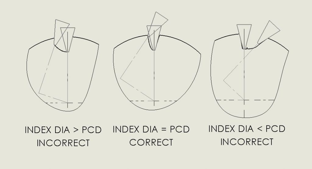

                      #284103
                      richardandtracy
                        @richardandtracy
                        As promised yesterday, I have modelled the effects of changing the diameter of the index wheel.
                        This was modelled with a 65mm diameter blank, aimed for 60mm PCD, 50mm diameter root, 1mm wide tool at the root, tool depth 12mm, 29 degree pressure angle, using 1mm traverse steps for the shaper. Three conditions were considered. On the left, the index wheel diameter was 90mm, in the middle, 60mm and on the right, 30mm. No effort was made to make a real gear wheel proportions as the illustration was made oversize to exaggerate the effects.
                        As correctly pointed out in previous posts, the index wheel diameter needs to be the same as the PCD.
                        Hope this helps
                        Richard.
                        Edited By richardandtracy on 14/02/2017 09:09:45

                          Richard,
                          Many thanks for doing this; but I remain utterly bewildered by your assertion that the diameter of the 'index wheel' is significant.
                          Before we go much further … Could I please check that we are both referring to item "D" on the drawing [described as a 120 tooth wheel, salvaged from a magneto].
                          What you describe is, indisputably, valid for the 'pitch circle disc' "C"

                            IanT
                              @iant
                              Hi Richard,
                              Sorry – my old grey cells are struggling to understand your drawing but in any case, it seems to me that the only effect of the indexing is to change the angular setting of the work – not its 'motion'. So I cannot see how the diameter of the indexing wheel would therefore effect the cut.
                              I may be wrong in this assumption (and often have been before) and maybe I need an explanation I can better understand. But I'm not convinced at this point…

                                    richardandtracy
                                      @richardandtracy
                                      Micheal,
                                      It is the pitch circle disc 'C' that is the critical item, not the diameter of wheel D in that design. I had managed to slightly misinterpret the sketch on the first page & was thinking that index latch 'L' was attached to the fixed body of the shaper. It would require fewer parts, less machining and… index wheels 'D' cut to the correct diameter but not risk the possibility of a wire being compressed and not rotating the wheel during any backlash movement of the shaper traverse.
                                      I can now understand why you were so concerned and apologise for any confusion caused.
                                      It is, however, a mighty clever way of machining gears.
                                      Regards,
                                      Richard.
