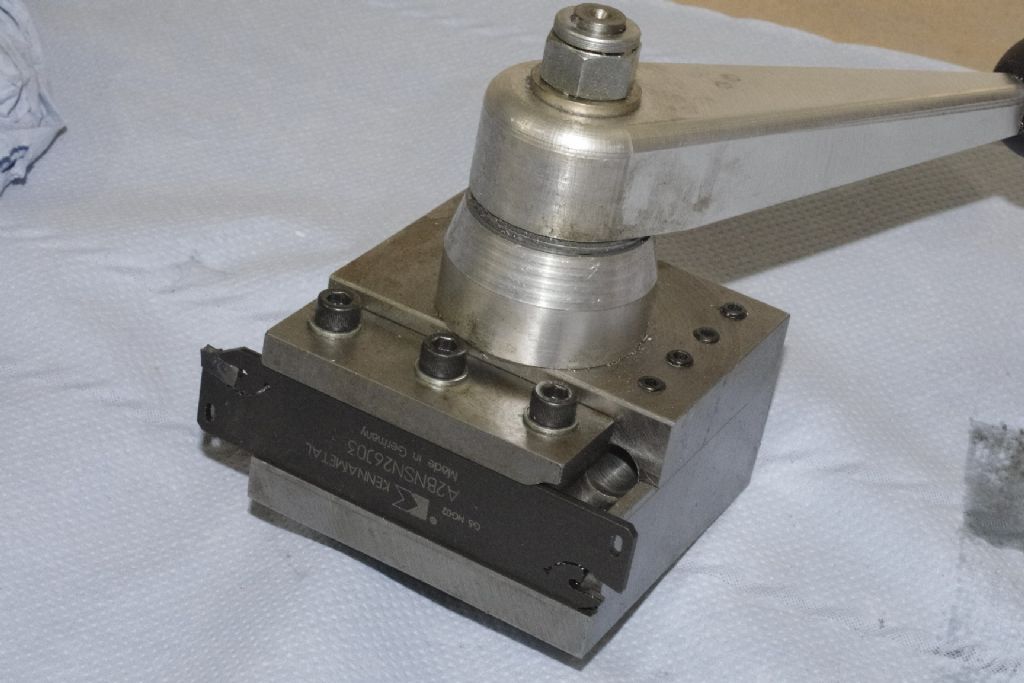

          Keep us posted with the results. I have cut a few double starts, and I finish the first and then move the compound to do the second. In your case you would move the compound 1/10". Take care of the runout for the second cut. The first one I did was the double start toolpost spindle for the fixed four way toolpost on the model A (not the type which slots into the compound). I think it was 1/2" x 8 ACME doubled, and to get it to screw in, I had to cut both starts deeper than expected. That involved removing the job from the chuck, but as the thread is so coarse, it is easy to pick back up with reasonable accuracy. It was for a special toolpost that I made. The toolpost is for 26mm parting blades and 12mm solid carbide boring bars.

            Will do! I have a bit of work to do before I pick this job up, but I will share my experience ( good or bad) once I’ve successfully completed it. Many thanks for you advice, it’s been most appreciated. I thought the old toolpost bolt was 1/2” X 10tpi, 2-start Acme……could be wrong!

              As a matter of interest, what gear configuration did you have to produce your 8 tpi 2 start thread, because that’s one of my jobs that I need to do on my lathe, is to fit a quick change tool post at some time.
                    I doubled the gear ratio and set 8tpi, which resulted in a 4tpi lead. I have also got 5,(10) and 6,(12) as well as 4,(8).You only want 5,(8), so the single 30 tooth fitted to the output will work perfectly, but to get the 8,(4) you will have to put a 60 tooth gear to fit on the input shaft eventually.
