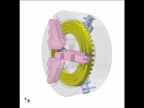

                    Posted by Andrew Johnston on 25/06/2018 10:29:52:
                    I thought the bevel gear and scroll were normally on the same side? Otherwise the chuck body would need to be quite thick.
                    Not on chucks that I have worked on. Commonly the scroll side is flat and the other side has the bevel gear on it. The whole thing is usually pretty thin due to the very shallow angle of the bevel gear.

                          The greater the angle of the bevel, the larger the diameter of the large end of the pinion. So bit of both I suppose. The type of chuck I am familiar with and referring to is like this:
                          The angle of the bevel is very shallow. Maybe 10 or 20 degrees or something like that.

                                Posted by Hopper on 25/06/2018 11:57:58:
                                Oooopsie, dunno why I thought that the scroll and bevel gear were on the same side. embarrassed
                                The pitch cone angles are determined by the tangent of the ratio of the number of teeth on the pinion and the gear. But the pitch circle diameter at the outer edge of the pinion is set only by the number of teeth and the diametric pitch of the pinion. It is not affected by the pitch cone angle.
