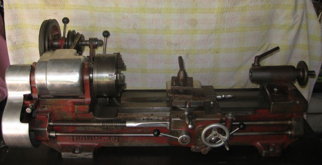

                      Hello all. This is my Wandess 4" lathe. It has a gap bed is 20 inches between centres. Although not cosmetically perfect it is in extremely good shape mechanically. It is missing it's original Dewhurst reversing switch. At the moment I have it wired for forward operation only. I can't find a Dewhurst switch here in Australia and most of the companies I've spoken to haven't even heard of one.
                      Artfully codger, that is very interesting about using the headstock for another machine. I have a broken 9×20 lathe that I am going to repurpose in the near future. If these Wandess machines are really not that well known it deepens the mystery as to how mine came to Australia.

                        Hi Archie,
                        That looks lik the one I had,the changewheel guard & the belt drive are casr aluminium,the headstock is bolted to the bed so just unbolts off [like a myford] the changewheels are 20dp like myfords,I made 90 degree bends for the oilers as it was mounted vertically along with the backgear mechanism, I've recently been to ozz to my daughters in joondalup perth so while I was there I made a visit to the local model engineering club, perth northen district model engineering society in vasto place balcatta, a great bunch of guys and a really good set up they made me really welcome with coffee & biscuits & look round the track & workshops[& the usual banter of course] thanks lads I'll call again when I'm next at my daughters.

                          Hi Graham, you mention the change gears being like myford. Do you happen to know if they are interchangeable? The wandess is missing a couple of gears and as you might imagine you can’t walk into a shop and order parts. There is myford lathes in Australia but not in great quantities. If myford gears fit I will order some from the UK. Cheers Archie

                            Hi Archie,
                            The 4 back gears on the wansess ie 2 on the mandrel & 2 on the countershaft are all 20dp,& the outer gear on the mandrel which drives the tumbler gears[one is 18t & one is 26t & the inner gear which connects to them are all 18dp, the outer gear which is keyed to the last of the 18dp drive is 20dp which is the same as my myford gears & that drives the gear train on the banjo for threadcutting & self act, I can't be 100% sure of the bore size of these gears though as I've not got the banjo & studs & my myford has a geabox hence no studs to measure, no doubt one of the lads on here will know then you can compare size with yours
