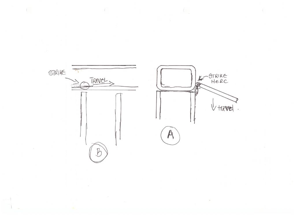

        Yes, I think that makes sense Phil – thanks for your input. What I've been doing is making a series of tacks as in A in this sketch:
        Sometimes (~70%) it works, sometimes it doesn't. When it doesn't it's because once I've blown through the cut edge the arc just runs away and makes it worse. Would you do something more like B? That is traverse across the 'non cut' bit without any weaving and let the pool melt the cut edge?
        I've pretty much given up using stick welding for this project because I need 100% success when I make the frame and I'm not going to get there in in time.
        I have now tried silver soldering, which I can do confidently, but I have never tried a joint like this before – I was worried that it would be weak because it's (sort of) a butt joint. I was surprised how strong the joins are though – after application of a FBH the tube bent and the joint just gave me a smug look. More expensive and slower than welding of course, but it'll get the job done.

          Diagram b is the way to do it. Put a tack on each corner first so you have something to weld into.
          I didnt want to get into a debate about stick, mig, gasless and tig welding as all have advantages and disadvantages.
          I have all these machines and if i were doing your project i would mig it without a doubt. Mig welding is the easiest to control.
          Dont go using pub bottles of co2 as this gas reacts with the weld pool and increases penetration. Its actually called mag welding, the i in mig stands for 'inert gas' and the a in mag is ' active gas'
          I have used pure co2 many times on thick sections – above 15mm thick for ultimate strength after preheat. It is hard on your torch and consumables, produces alot of spatter and gets really hot.
