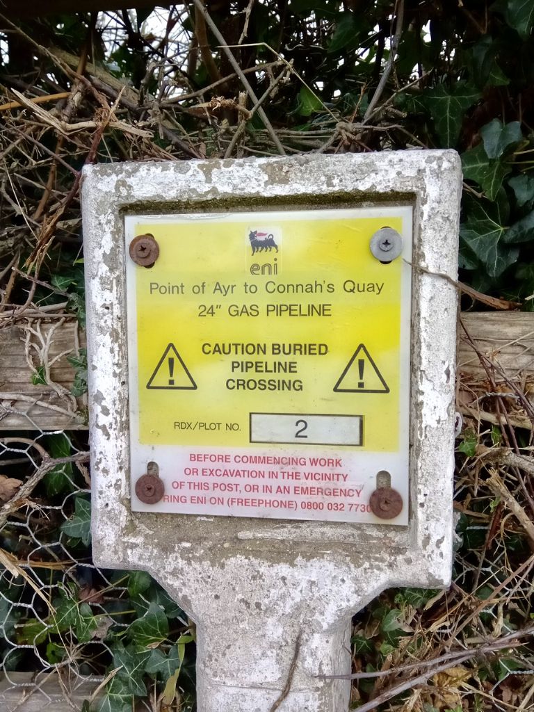

                    Forgive the intrusion please …
                    This, which crosses the Flintshire countryside kinda puts things in perspective surprise
                    Not sure what pressure it runs at … but that’s a lot of gas !
                    Edit: __ and maybe coming soon:
                    https://www.dailypost.co.uk/news/north-wales-news/energy-boss-how-firm-refill-21573018
                    Edited By Michael Gilligan on 18/03/2023 14:02:19

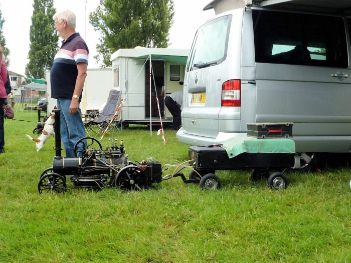

                    #638210
                    Harry Wilkes
                      @harrywilkes58467
                      Fellow club member ran his two Folwer ploughing engines on gas he had no problem with his engines or gas bottle getting tested or insured. The only drawback was running the engines on the rally field they struggled however when he ran them static they performed OK The small sized cylinder was stored in the riding trolley.

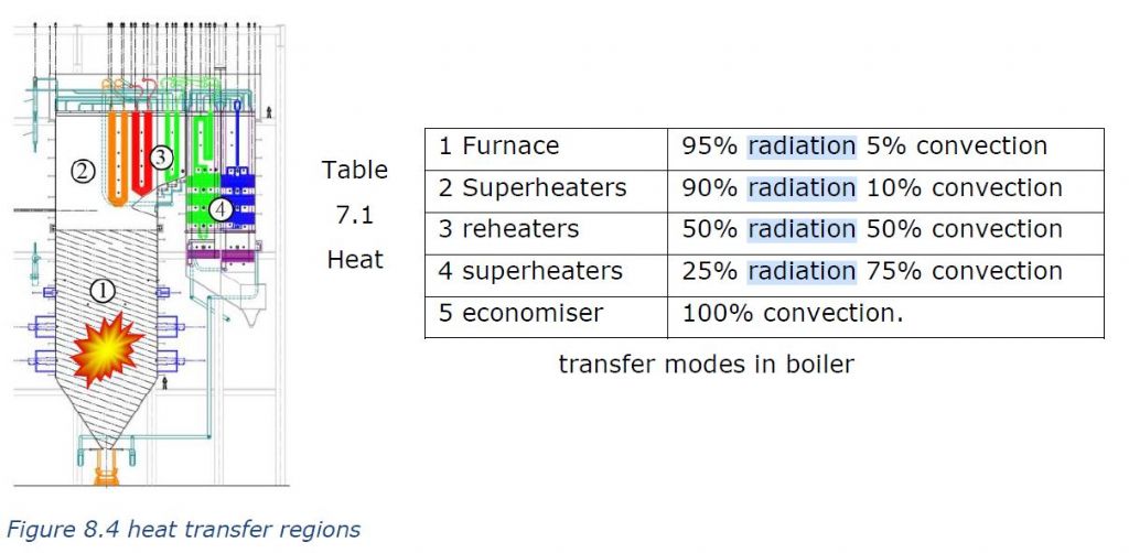

                                          Jelly
                                            @jelly
                                            Posted by Martin Johnson 1 on 19/03/2023 16:50:10:
                                            Burning a nice blue flame is efficient combustion, but it doesn't radiate so the firebox surfaces are not working as they would with nice bright flames and a yellow hot bed of carbon. That is quite a loss in heat transfer.
                                            Whilst I see what you're getting at, as the statement sort-of holds for the temperatures in a model boiler of an existing conventional design..
                                            It's not strictly true and ignoring the consequences of that statement only being true within certain conditions (bounds if you will) kind of obfuscates the fundamental thermo-fluids of how you overcome the limitation for people less familiar with the topic at hand.
                                            Most triatomic (Carbon Dioxide, Water, etc.) gasses do have an emissivity profile which results in IR (radiative heat) emission above a given temperature, even though they're not luminous (i.e. don't emit in the visible spectrum).
                                            The rub is that this emission occurs when the gas is held uniformly at higher temperatures, so any boiler design which allows for rapid cooling of the flue-gasses will not allow the radiative heat transfer to predominate and thus effectively wastes that heat transfer opportunity forcing the boiler to rely on conduction and convection.
                                            The result is that a very different boiler design is required, to take the example of the supercritical steam generator design which is typical of modern power-boilers (as opposed to heating boilers) the basic design is always a water-tube or finned heat exchanger.
                                            An example of a typical arrangement is shown in the below figure, and you can see that the design is optimised to give maximal residence time at high temperature for the flue-gasses to emit radiatively, before any convective/conductive heat transfer begins, and the heating of "streams" of working fluid occurs in the order which to maximises overall heat transfer, rather than a convenient co-current or counter-current flow relative to the flue gasses.
                                            20-03-23 Old Notes Power Boiler
                                            Crucially whether it's a water-tube/finned power-boiler or fire-tube heating-boiler (akin to oil-fired marine boilers), the upshot of not having luminous char from a fuel source to help maintain radiative heat-transfer in non-ideal geometries/conditions, is requiring much greater consideration of overall path length, and ensuring the tubes and furnace are sized correctly at each point in that path to achieve the most efficient heat transfer from the flue gas.
                                            Which of course is a completely different way of thinking about boiler design to traditional locomotive designs, which will feel alien to a lot of people who are used to a conventional locomotive "once-through" design…
                                            Although perhaps less so for people who have faithfully reproduced more modern loco boilers which used unequally sized tubes getting larger as they go higher in the boiler for similar reasons, as engineers learned to optimise the combustion of the volatile component of solid fuels.
                                            Edited By Jelly on 20/03/2023 17:20:43

                                                I'd guess that Jelly's diagram is for a pulverised coal or oil fired boiler, most stations which burn gas do the burning in a gas turbine and then pass the exhaust of that into a steam boiler (Combined Cycle). Both oil and coal produce lots of radiant heat. Even then if the space full of gas is massive, you can get radiant heat from the gas, BUT in our sizes we do not have thick films of gas and so radiant heat transfer is much reduced. This was described much more clearly in Martin's article in ME, April 2018 et seq
                                                Phillip, your grate, and presumably the firebox, tubes etc are massive by UK 5"g standards, so even if it's not producing as much heat as you get from coal, it's probably still capable of a lot of work. That's not to say it can't be done, in ME 7 Feb 2003, Mr CHJones described his gas fired Rob Roy (3.5"g) and Metro (5"g?), which by his account were successful.
                                                Finally, the model gas turbine chaps bur a huge amount of paraffin in a small space, but they do it at higher pressure. If anyone out there knows how they do it tell us now.
                                                Edited By duncan webster on 20/03/2023 22:23:16

                                                  Jelly
                                                    @jelly
                                                    Posted by duncan webster on 20/03/2023 22:21:26:
                                                    Yeah it's a generic diagram lifted from my old uni notes, which dealt with boiler design in a sort of fuel-agnostic way.
                                                    In practice I have seen both gas-fired power boilers and thermal oxideisers (with heat recovery) which use a comparable construction, usually because they're fuelled by an off-gas or vapour stream which is readily available but would be unsuitable for a gas turbine due to composition/contamination.
                                                    The challenge of available space to maintain sufficient film thickness is obviously a problem with scaling which is difficult to overcome when modelling.
