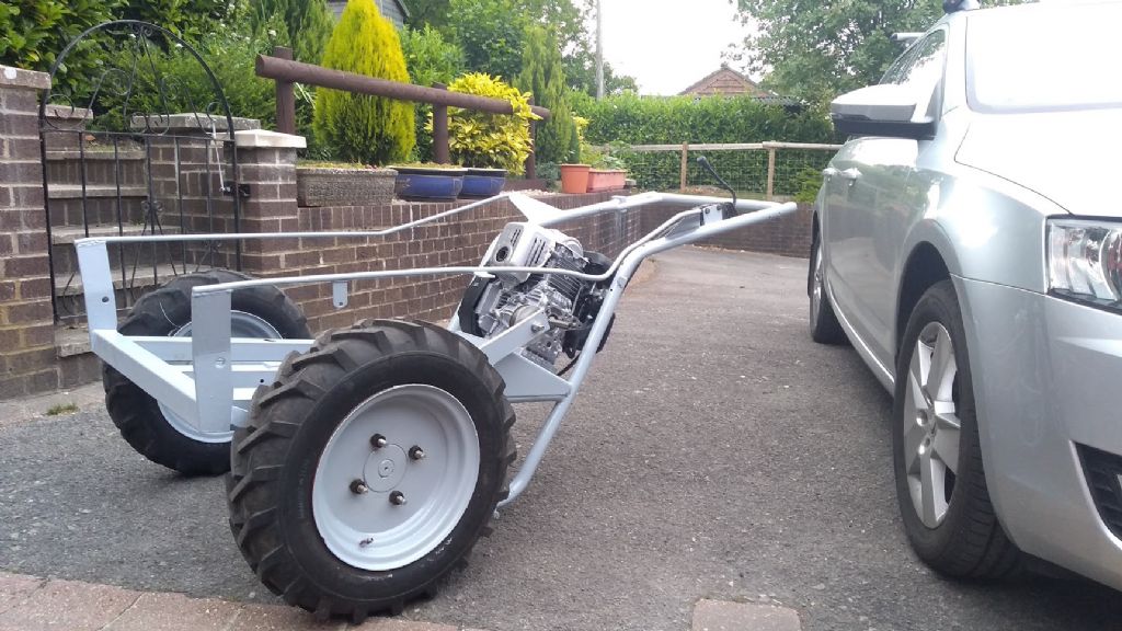

      Some progress has now been made. The chassis has been fully stripped down and some weld repairs made. It has been repainted with Hammerite red oxide primer and Lidl grey paint. I have used this Lidl paint on several projects and rate it highly – it can't be beaten on price, it's tough and looks good too. The wheels are back on and the motor is being positioned for permanent mounting.

            Just thought I might mention that I used 1/2" UNC screws with the original lug nuts and it's been working just fine. In fact, it has been a real workhorse and the wheels haven't fallen off, yet. smiley
