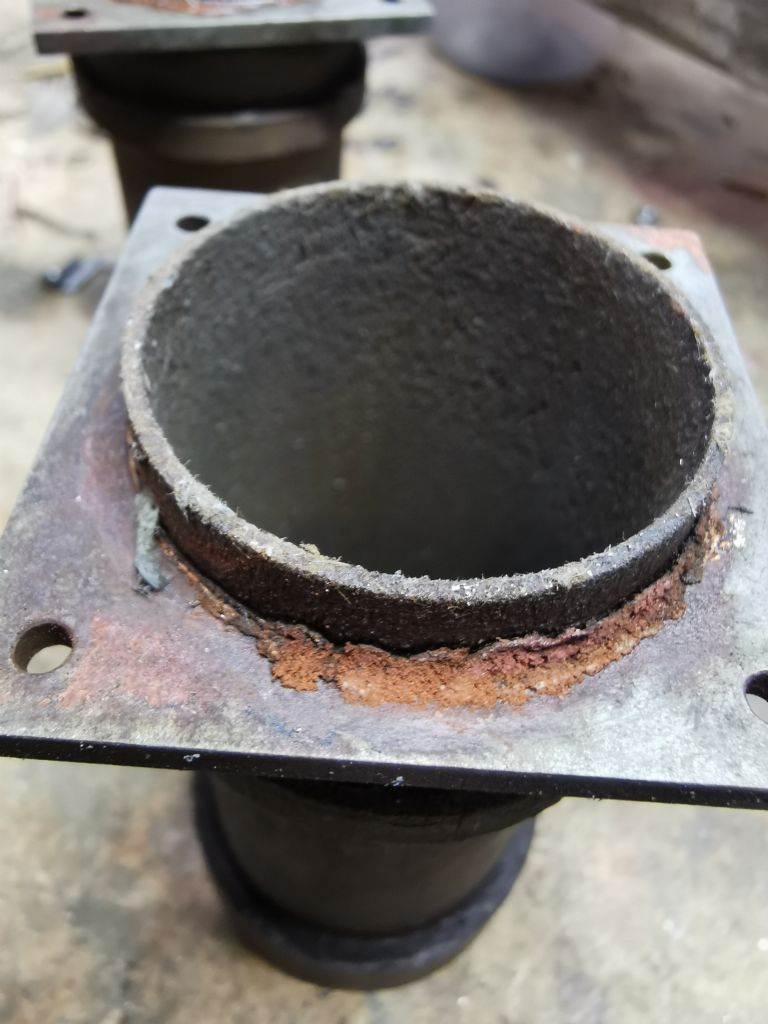

      I have just ruined 4 cylinders for my latest engine while pickling them and I am hoping someone on here can tell me what went wrong
      I had to silver solder some base flanges to the cylinders, so far so good
      I then pickled them to remove the flux ect
      Now at this point I should say my pickle is 20-1 water sulphuric acid, it was previously used to clean my allchin boiler throughout it's construction and was a deep shade of blue
      I hooked the cylinders up with stainless wire and dunked them in overnight when I went back the pickle was fizzing with copper particles floating on it
      Removing the cylinders revealed the devastation, severe pitting and even large parts of the steel eaten away
      A long time ago someone told me that steel in contact with copper would cause the steel to rot
      Can anyone on here shed any light on this, was there enough copper dissolved in the pickle to cause either galvanitic or electrolytic dissolving of the steel
      I have ordered some new steel and don't want to make the same mistake

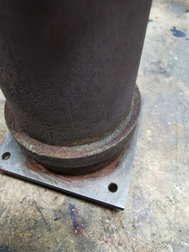

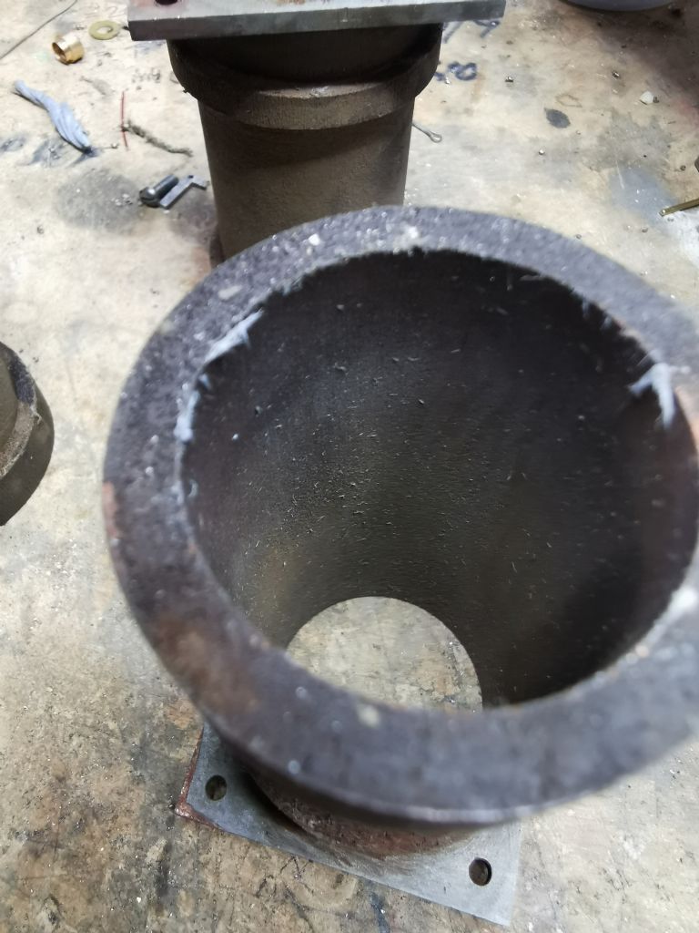

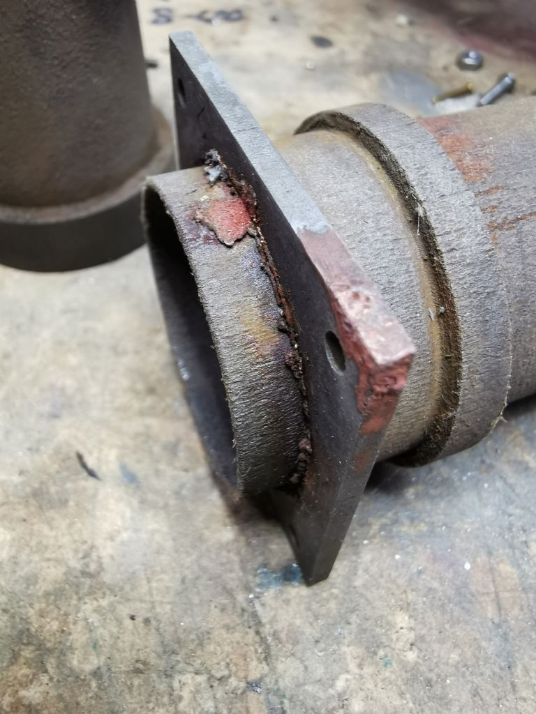

                                    img_20221002_110259.jpgimg_20221002_110253.jpgimg_20221002_110242.jpgHere are some pics of the damage, note the base flange which looks okimg_20221002_110218.jpg

                                          Anyone any thoughts on why the square flanges haven't corroded?
                                          #615782
                                          old mart
                                            @oldmart
                                            Probably the flanges are a slightly different alloy composition, and higher up the electrochemical series.
