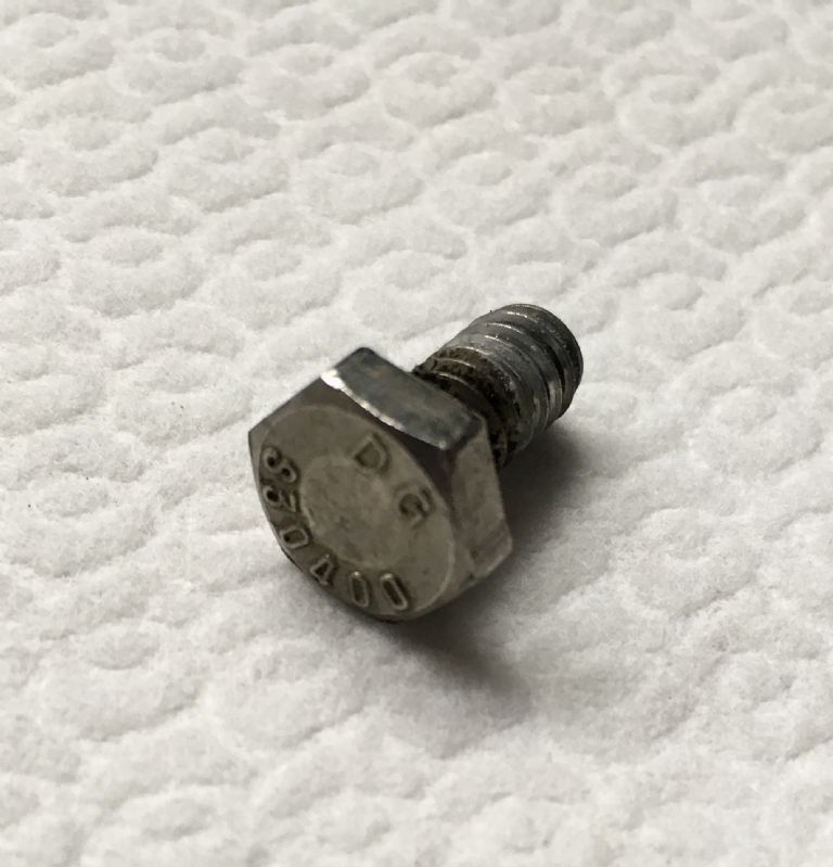

            As indicated yesterday, I am obliged to let this lie for a couple of months, and will be packing the structure away carefully.
            Meanwhile: here are a couple of snapshots
            One of the screws removed from the pole-attachment cap …
            The white substance on the thread is the Aluminium Oxide, and the quantity looks trivial; but this screw was extremely stiff to remove, even after using PlusGas. The majority of the corrosion is, I think, still adhered to the female thread, but [not possessing the appropriate Go/No-Go gauge] I cannot really check.

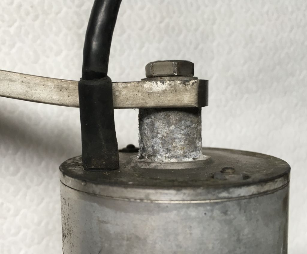

            The remaining problem [one of two instances] … Photographed upside-down for convenience
            Please keep the suggestions coming … I will report back in due course.

              You didn't mention it was a hex head set screw. I was thinking smaller Phillips head type of thing. Brute force and ignorance on the end of a long ring spanner with a bit of impact should do the job. Or mechanised brute force and ignorance in the form of an electric or air impact driver with an impact socket on it. These make quick work of such jobs and don't twist the parent assembly etc too much.
              A fresh bolt makes a handy go/no go gauge but it would be a good idea to run a tap down the female thread anyway to clear the oxide powder etc out of the thread. Or make a redneck thread chaser by putting a longitudinal hacksaw slot part way through the end of a bolt.
              Another thing you can do is go carefully around that boss that the bolt screws into with two small hammers tapping simultaneously on opposite sides of the boss. Or hold the boss on a piece of steel or the vice jaw etc and tap opposite with a hammer or hammer and drift while moving the job around between blows . This tends to expand the metal of the outer thread and loosen it up. An old steam fitter's trick for getting apart threaded pipe joints that have been corroding together for countless eons. It will loosen rusted pipework that otherwise will not budge even with five foot of pipe on the Stilson wrench handle for leverage.

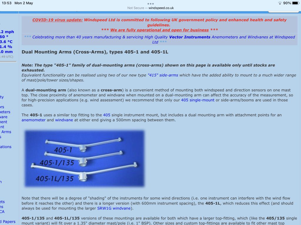

                      Oops … Just had another look at the page
                      [Edit:  __ first of the three links that I posted previously]
                      and realised that the cross-arm appears to include the pillars
                      … which would suggest that the instrument is screwed down onto it
                      dont know

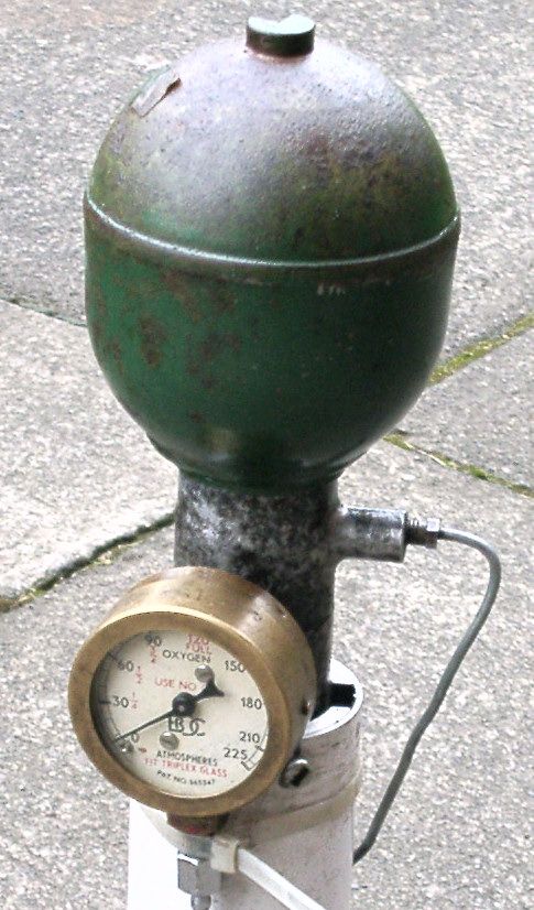

                                Despite intuitive doubts, I used this method to free very corroded hydraulic unions on Citroen rear suspension cylinders. You can see the design on this photo of a tester made from a such a cylinder. I agree that spot welder dissipation will be lower for aluminium, but with perhaps 5000 joules available over a couple of seconds, 10 grams can be heated by more than 300C. Then taking the differential expansion as 7 parts per million per degree C, we have 2 thou per inch (to mix units!), a very useful loosening of the parts. It does indeed work.
