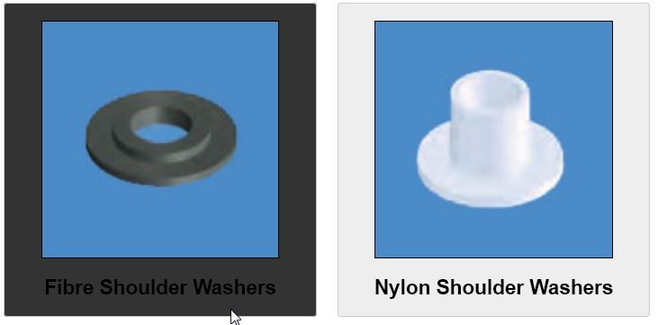

                        Insulating flat mating surfaces to prevent galvanic corrosion is easy by coating the surfaces or placing an insulation material between them but more difficult to prevent it between bolts and the side of the bolt holes because painted on type insulation is easily worn off.
                        A better option is to use a flanges shoulder washer. Use a steel washer on the outside of the flange and a steel bolt,  ( 2 shoulder washers are normally used, 1 in each of the mating parts.)
