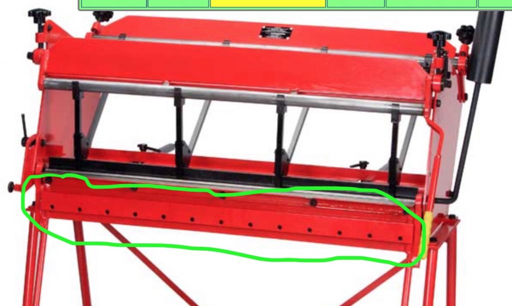

      After hauling it out occasionally and using on the bench for some simple work, I finally finished the stand for my Gabro BF620-2 folder. I need to commission it properly before making a couple of aluminium 'lids' I need for a transmission tunnel and radiator cowl. Neither is a simple pan, but one is certainly more complex and will need a little-used feature for what the scant manual describes as 'Interrupted or Selective Bends'.

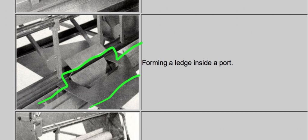

      There are no images of this in the manual, but I found one photo from the web which shows the Gabro being used in a configuration like a 'normal' box and pan folder. However, there is descriptive verbage about this in the manual:
      "Selective bends i.e. bends requiring only a part of the clamped material to be bent is made as follows:
      1. Remove the Fold Bar Angle and the bolts which hold it.
      2. Fit the Bed Raising Plate on to the Bed with the front edges level, after sufficiently retracting the Adjuster Screws.
      3. Set up the work piece in the normal manner.
      4. Select or cut a Bending Plate a little narrower than the width of the portion to be bent and stand it up in the channel accurately beneath the part to be bent (with the 90mm dimension vertical) and make the bend. The Bending Plate will operate either leaning outwards to give more leverage or flat against the fold bar. In the latter position it can be used to tighten the root of the bend. If the Plate slips it can be held by simply dropping the 3mm thick Packer into the channel in front of the Plate."

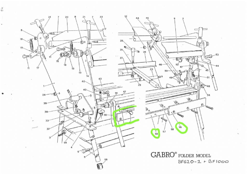

      The problem is that my machine has no Bed Raising Plate or Bending Plates, neither of which is illustrated in the parts diagram. And the Bending Plate Channel Front and Bottom, which are items 55 and 56, have also been removed and lost by some former owner.
      My challenge is to recreate these pieces, and I need the help of a kindly owner to measure them up for me?

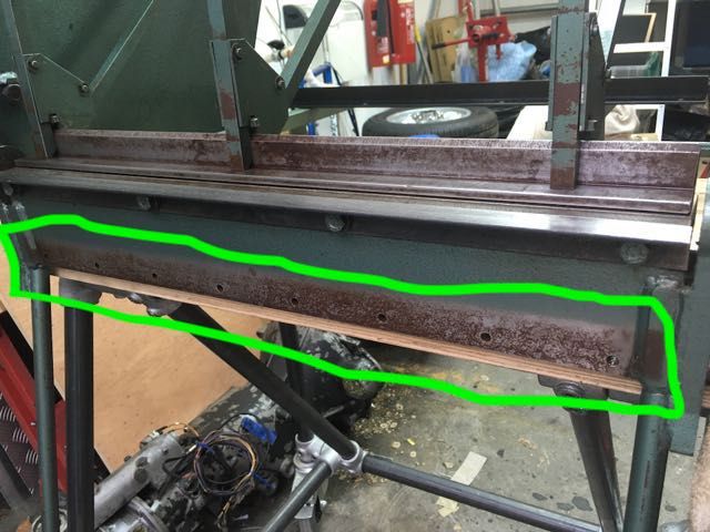

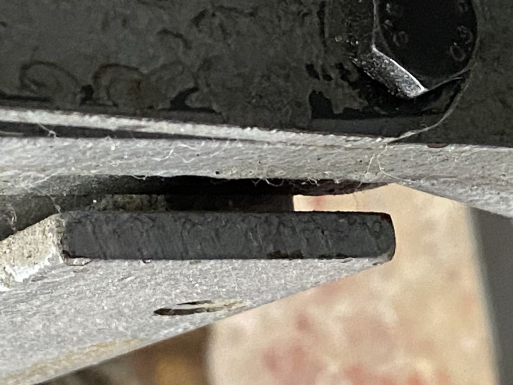

      Starting with the items 55 and 56, and ‘reading' the rust stains and paint overspray, my guess is that Plate Channel Bottom is simply a bright bar of 3/4”x1/4”? And the Plate Channel Front a similar 1 1/4”x1/4”?
      That would leave a channel of 1/4” depth and 1/2" height to drop the bending plates into, described earlier as 90mm in length. And if those instructions in ‘4’ above say there is room for a 3mm spacer, the arithmetic suggests the bending plates are themselves 3mm thick – although that sounds a bit skinny to me as that width constitutes the contact face of the bending plate?
      I am going to guess that the Bed Raising Plate is again just a piece of bright bar. This one the width of the bed and the thickness of the Fold Bar (to which the Plate Channel is fixed), hence 1 3/4”x1/2”? And that this Bed Raising Plate simply sits on top of the Bed, located by the two roll pins that can be pushed up and proud of the Bed.

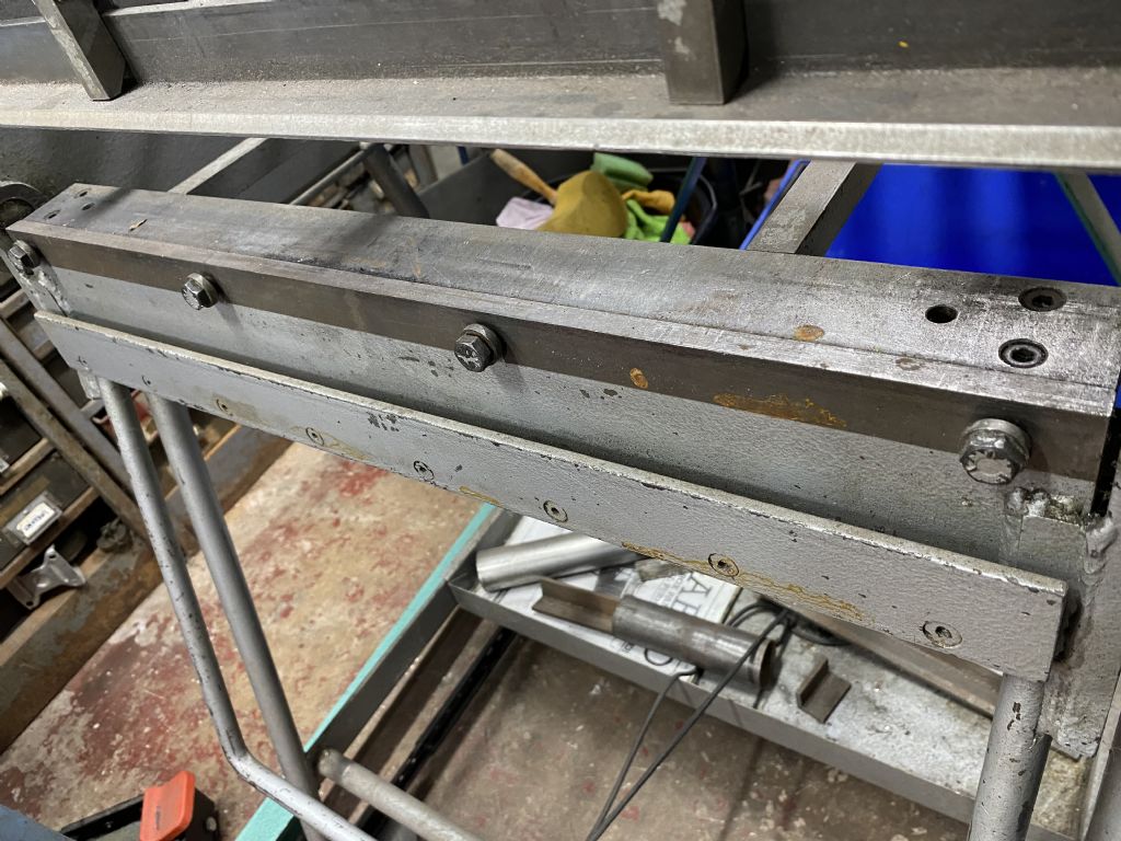

                img_0831.jpgThe top photo shows the bending channel front and in the second photo (on its side) you can just see the spacer bar.img_0832.jpg
                Colin

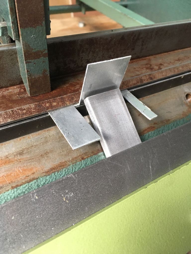

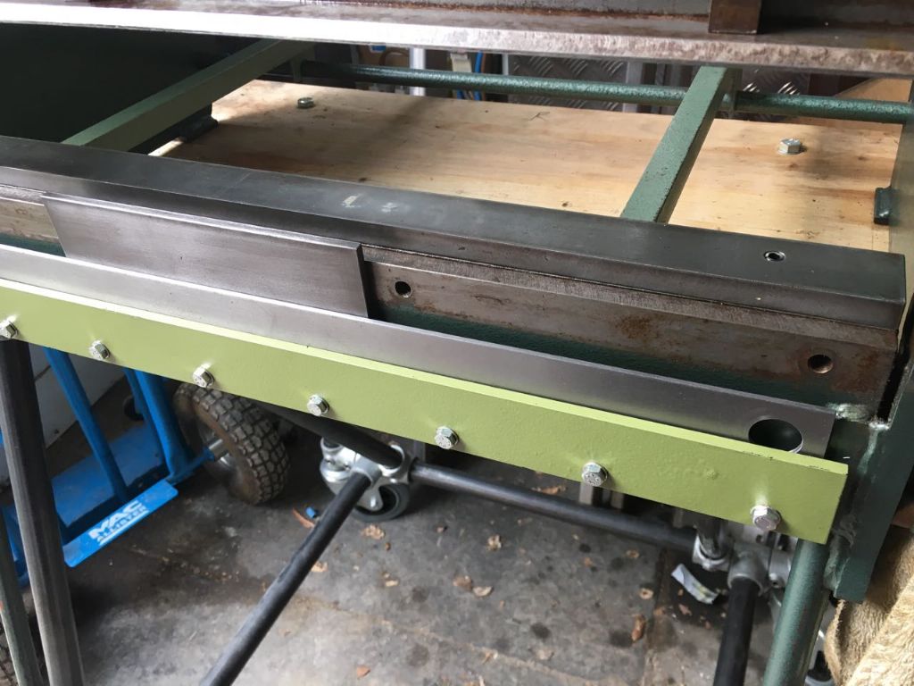

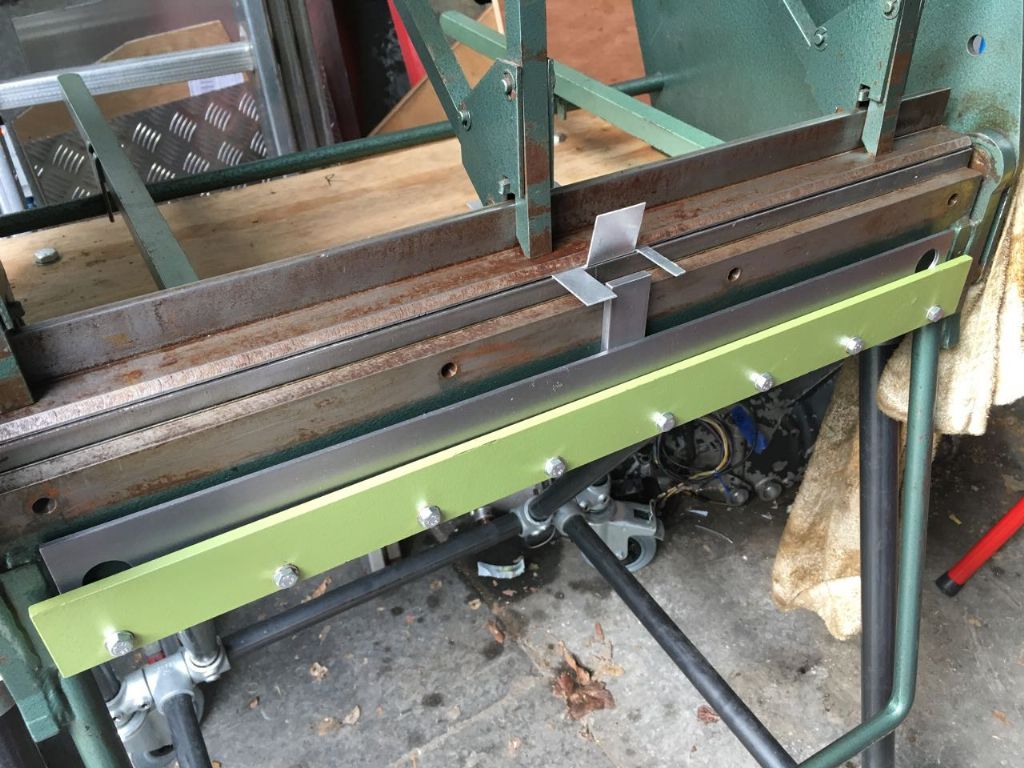

                                                I assembled my replacement components yesterday and can now use my Gabro folder to manage interrupted folds that include angular pans and some particular tabs – it can now be operated much as other pan folders, as well as 'Gabro-Style'.
                                                It's easy to see the general layout from the wonderfully-clashing shades of green. From the top: the bed-raising, which sits in the conventional bed and located by rollpins; a bending plate, sized to the fold and made in a number of lengths; the Packer, my own including offset holes drilled to provide finger pulls; and the Bending Plate Channel, while the Spacer is located behind and cant be seen.
                                                There is also a picture of a knockout tab being bent on a piece of scrap, to illustrate something of what is now simplified. Looking at other pictures on the web, I dont think the older 'plain' green machines were equipped with this facility?

                                                  That looks good. Material has arrived for the packer, and the pins you sent arrived last week (thank you). Think will remove the existing top bar and clamp the two together to ensue holes in right place.
                                                  That folding looks great.
