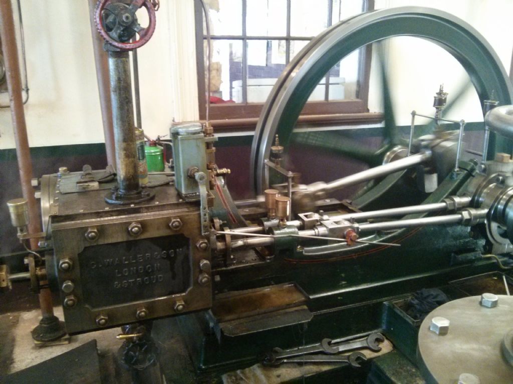

      Yesterday I visited the Dunedin Gasworks Museum in New Zealand and saw some lovely G. Waller engines operating.

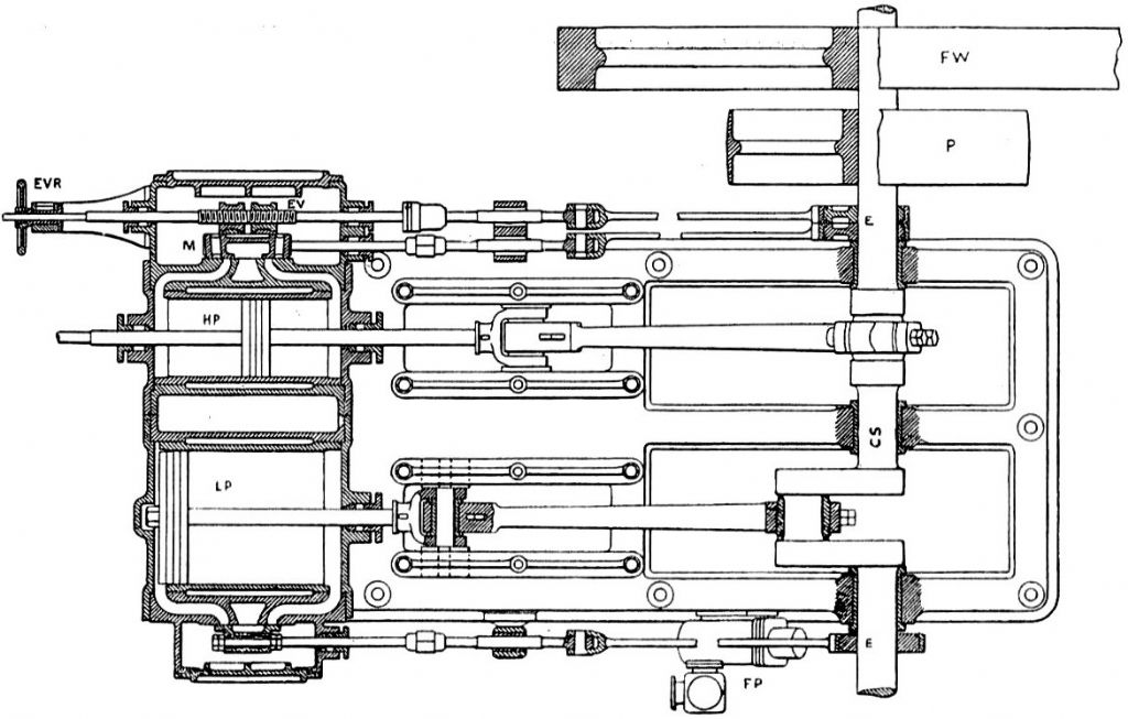

      One of these engines seemed to have 2 valves (rods and eccentrics) – The volunteer at the centre explained a bit about the dial control that seemed to be connected somehow to the outer most one but not why there were 2 systems.
      Can anyone shed any light on the theory and perhaps diagrams to explain how this valving works?

          This is a variable cutoff system. There were a number of systems for this. There is a Tangye compound pump engine at MOTAT in Auckland that has a variable cutoff. We did work out how it all worked when we were working on the engine, but now that they have sacked all the steam section volunteers I can't remember all the details of how it worked. But the effect is that you can change the cutoff so that the power is matched to the load, while running at full steam pressure for best efficiency. I think also the systems like the Dunedin engine has with two valves give a faster opening and closing of the ports, so less wiredrawing.
          #185675
            Quite possibly Meyer valve gear to conserve steam. The easton & Anderson that I made a while ago had that arrangement.

                Thanks Jason
                A quick search on Meyer valve gear return this image which explains it quite well
                The Waller only has one cylinder so likely to just be the HP cylinder

                    So to get back on topic, I could go back and take a look at the Tangye to remind myself of the external arrangements, however I could not take off the cover and look inside as we did before. I should have taken a photo but that was before I had a digital camera.The essential details of that one were that the external control worked a screw with left and right threads to move two port blocks together or apart, changing the timing of the cutoff, but not the admission.
