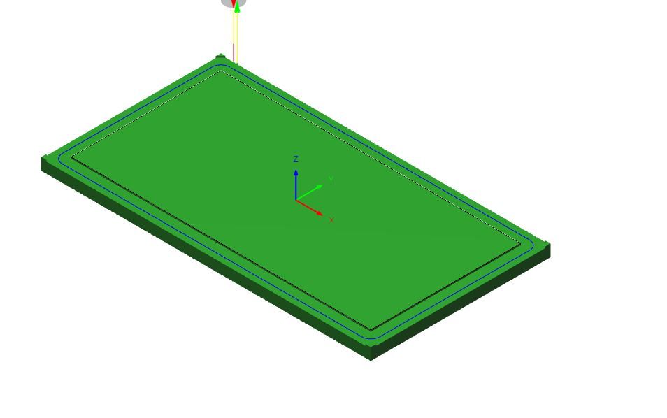

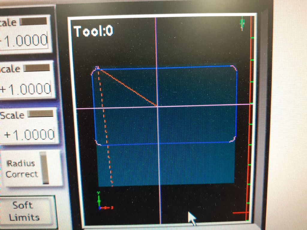

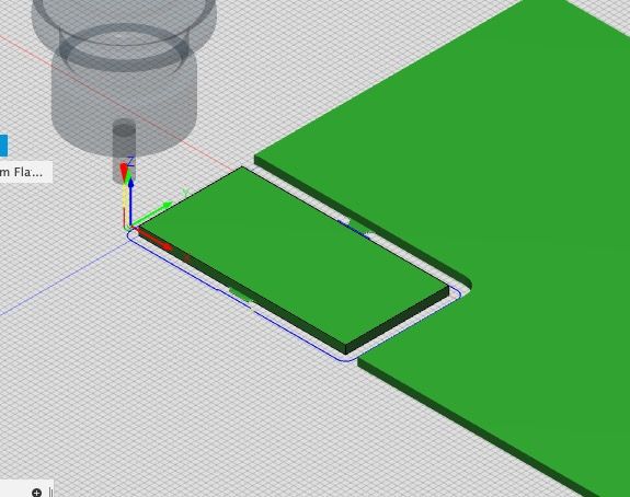

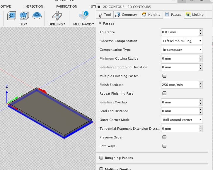

I've got to the stage of attempting a first run with my cnc router. I drew up a 100x50x4mm cuboid in Fusion360, and generated the g-code file attached below. Loading it into Mach4 the preview of the path shows that the tool is going to describe some large arcs at three of the corners – possibly the lines which include I and J codes such as G2 X105 Y51 I101 J51.
Am I right in thinking that this is because I have added or omitted something in one of the F360 dialogs at the manufacture setup stage? Maybe something to do with lead-in and lead-out??
