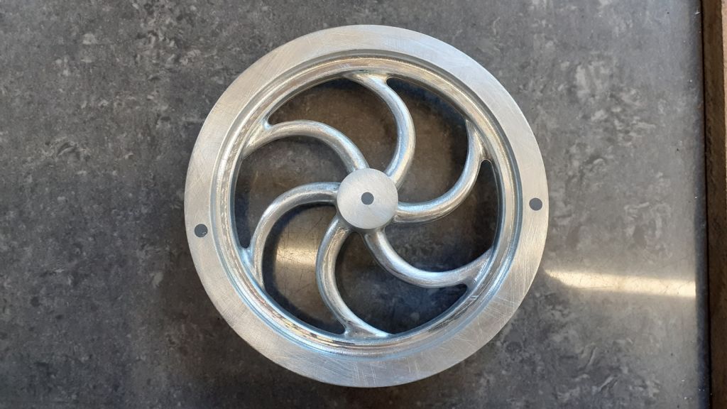

          A bit more pattern making completed today. The aim was to try and produce a flywheel pattern that had a similar look to the curved spoke flywheels used on National Gas Engines. I made this one out of aluminium so it would be a bit more robust than timber as the spokes are quite thin section towards the rim
          Quite pleased with how it turned out
          More details in the video. Ramon best look away as there are some fast feed rates upto 650mm/min and cutters spinning at 5000rpmsmile p
          I was the first time I used the peristatic pump fed fog buster in anger and very pleased with how it performed giving just enough liquid to wet the tool and stop tip build up and meant I could leave the machine running unattended. I used about 40mls over the six hours of machining which did not leave me with a dripping pile of swarf.

                  Excellent Jason, how did you get the spokes from a square section to a round one. Was it part machining, part handwork..?
                  Ron
                  #607416
                    Thanks Ron. It's all done by machining save you a quick going over with 180g emery once the two halves are together just to remove the very fine machining marks.
                    The video only shows the initial part of the process which is an "adaptive" cut. This is done at a maximum depth set my me in this case approx half the metal thickness which removes the bulk of the material and then it goes around the shape in progressively shallower cuts again with a set depth to each which in this case was 4.5mm for the deep one then 0.5mm shallower for each of the finer steps. This leave s a sort of contoured surface a bit like looking at the lines on a map
                    I then switched to a 4mm dia ball nose 4-flute cutter and used several different types of tool path. The first is what is called a "ramp" where the tool follows around the shape gradually getting lower as it goes, again this can be set and I had it at 0.2mm spacing per pass. This is the vertical depth which works well on the more vertical surfaces such as the hub and sides of the spokes but not so well on the more horizontal such as the top edges of the spokes as you can hopefully see see (click image to get it larger)
                    The final couple of paths were a "pencil" which cleans up the internal fillets and then a "scallop" to tidy up the tops of the spokes, this moves the tool a set distance along the surface per pass rather than a set vertical or horizontal amount.
                    These final ramp, scallop, pencil are what really determines how smooth a finish you get but it is a toss up between smoothness and run time as the closer together the cuts are the smoother the surface but if you half the distance you approx double the machining time. A larger dia ball nosed cutter will help smooth things out but can only be used if you have larger internal fillets so would not have fitted on this job.
