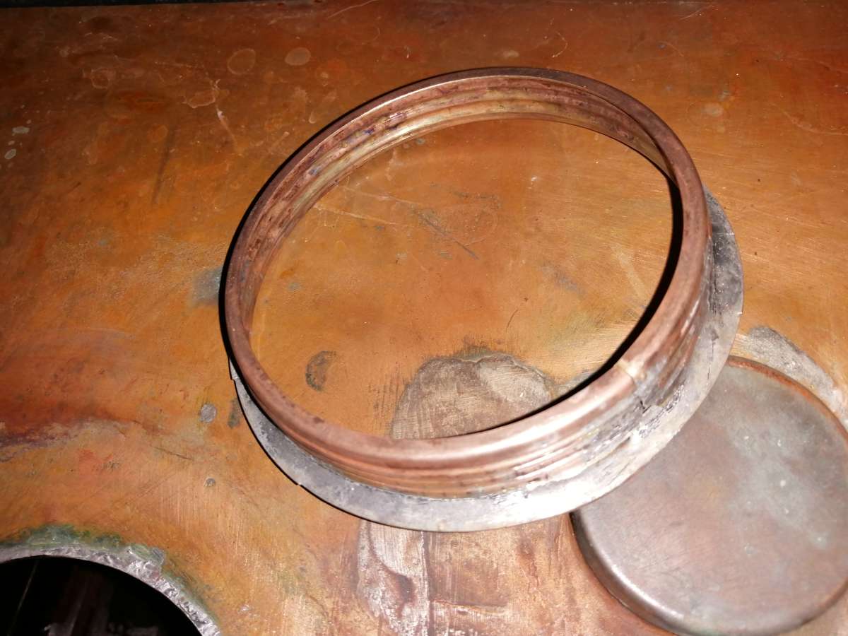

      Hello everyone I have just got some Fryolux from an eBay supplier to make a small repair to the water tank lid of our Stanley steam car. However, the label has a 08 Feb 2019 expiry date!
      Is is still usable or a rip off?

          I am using solder paint which the USAF threw out 20 years ago, I just thin it with a little liquid flux and it still works fine. I think it’s just the liquid flux element that sets the expiry date.

            It would be simple enough to test anyway, on a couple of scraps of metal similar to that being jointed.

              Thanks for your advice everyone, I sent it back & got a refund, it was nearly £30 after all!
              Managed to repair the lid  with some old solder and resin flux in the end.IMG_20231110_150513
