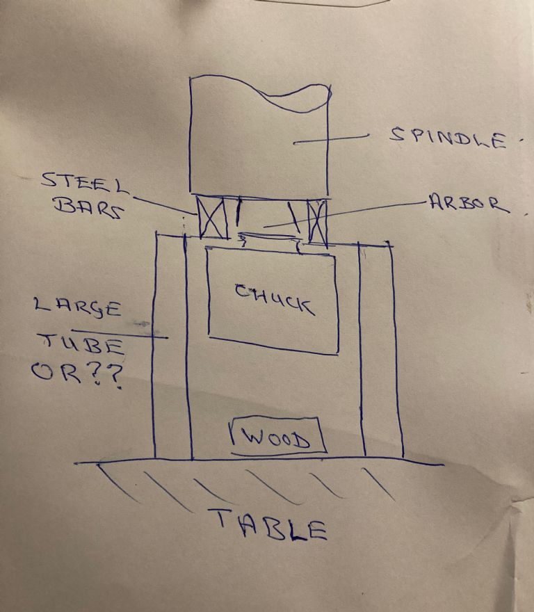

          Trevor, Worth looking at pages 2 & 4 on the link I sent for some photos of Morse taper removal wedges which hopefully may solve your problem, you can of course make these.
          I had a similar problem with a drill chuck in my lathe tailstock and ended up using extreme measures to remove it ! But of course no bearings to consider, however see the attached sketch of a possible set up to hopefully prevent any bearing damage by supporting the machine spindle thus enabling the use of a heavy hammer – say 4lb [2kg]
          You need to support the spindle using these extreme measures by the use of a large tube that goes around your chuck and if possible lower the spindle onto the tube, if this is not possible use a tube large enough for the chuck to enter or suitable bar stock "parallels" and 2 maximum size bars to support the spindle keeping everything as close together as possible. This should prevent bearing damage. Stating the obvious put something underneath to protect the table. Apply as much downward pressure to the quill / spindle as possible as you apply the hammer blow.
          To deliver the blow I would make a threaded slave bar from as large a diameter that will enter the spindle and a fairly short thread so that it screws into the arbor up to a shoulder — no or minimal load delivered to the arbor thread but the thread is protected and the shoulder delivers the blow directly to the arbor.
          Not something I would suggest lightly as its an extreme measure but sometimes needs / must ! Hope this helps if all else fails

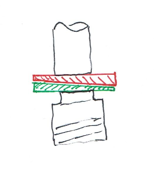

              Personally I think the OP has no idea of how wedges should be employed. These are not wedges inserted separately – they are a pair which overlap each other on both sides of the morse taper as they pass over/under the other wedge creating a very considerable force perpendicular to their direction of movement.
              I have actually surface-ground the sides of my larger pair, so they slide more easily over one another (and across the morse socket and lip of the male taper). The angle of attack is very shallow such that the change in total width increases only very slightly with a relatively large distance travelled in the direction of force applied perpendicular to the extraction direction. If the OP thinks it is just a matter of using a couple of wedge shaped levers, he is mistaken.
              The action is similar to that of an adjustable parallel – but with far shallower angle. A bit, but only a bit like that but it does give one the idea behind the principle where movement in one direction changes the size in the perpendicular dimension. If the OP had made a couple, he would have most likely already have separated his ‘frozen’ items.
              I have removed umpteen flywheels from crankshafts (with tapers), using pullers. These pullers employ a fine thread and a large spanner and can provide fairly immense force – but also have often needed a ‘bump’, when the joint separates with a considerable release of energy as the two parts separate.
              Anyone who has regularly changed track-rod ends on vehicle steering systems would also comprehend the force required to separate those joints, too. They, too, often separate very suddenly when the separation force finally overcomes the joint contact.
              I’ll rest my case for use of wedges to separate tapers. Can’t really say much more without upsetting some, if I haven’t already.

              Nicholas Farr
                @nicholasfarr14254
                Hi, like NDIY says, use two shallow wedges, as shown in the sketch below which I posted a while ago when someone else had a similar problem.
                Regards Nick.

                Hopper
                  @hopper
                  You can buy them ready made but are sized to go between the chuck and the arbor so you mught have to go a bit oversized on a collet holder. Easy enough to make if you have a mill. The shallower the taper they better they will work.
