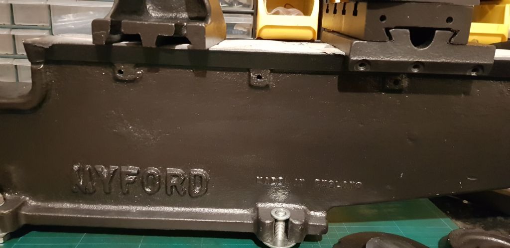

          I didn't want to go with the Myford colours nor did I want a perfect finish and too afraid to use it. I have gone with a black but the finish is like an old industrial original. Let me know what you think. All the smaller parts are going in the oven to make them heat resistant and prove them at the same time.

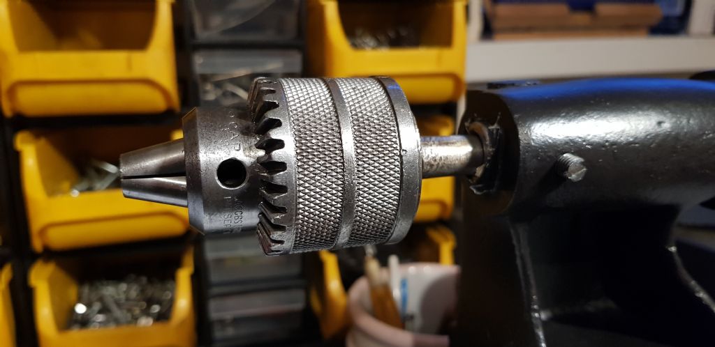

                        This Chuck was black, seized up and quite sad. That was this morning though. Rack has been cleaned and de-rusted. Just need to remember where everything goes.

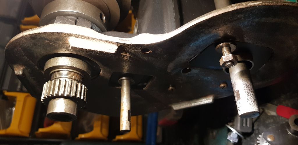

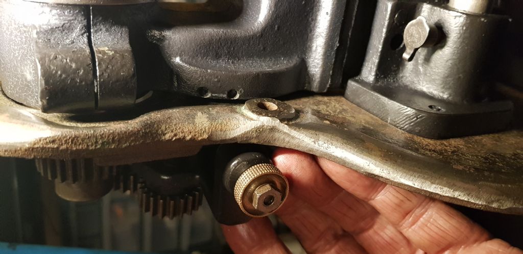

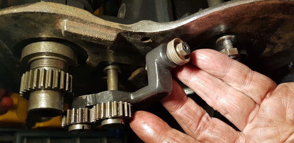

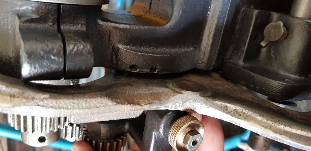

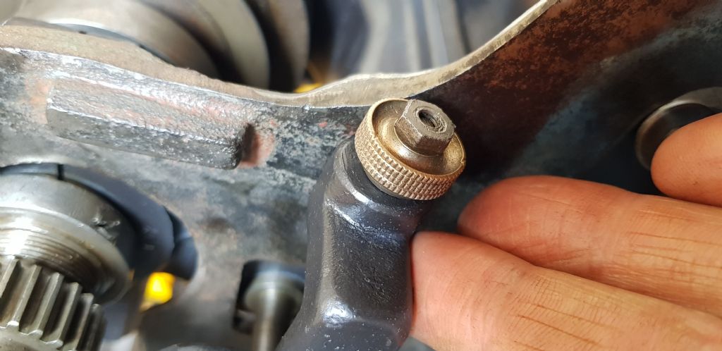

                          I seem to have hit a brick wall. I put the large mounting plate onto the end of the Lathe and found that the geared knob will not fit in place.All works well without the plate so if anyone can look at the photos and tell me what I am doing wrong I would appreciate it. If not the angle grinder is coming out!

                            Hi John, maybe you have to hook the geared knob over the plate first and then assemble them both together.

                              Thanks Nick, It must be a mismatch. I can't see how this will ever work. Will they to find some photos on G Images. #baffled

                                From memory, there was a plate but much lower down for the change wheel cover to butt up to at the leadscrew. There was certainly nothing of the size you show here
                                Brian
                                #404372
                                Howard Lewis
                                  @howardlewis46836
                                  The detents for the tumbler reverse are on the other side of the plate. So it looks as if the Tumbler Reverse needs to be hooked over the plate before sliding the Plate and Tumbler Reverse onto the stud.
                                  In that way, the gears will mesh and the plunger will drop into the detents.

                                    I am no expert but all the bits I have seen that plate does not appear on other ML4 s that I have seen around.

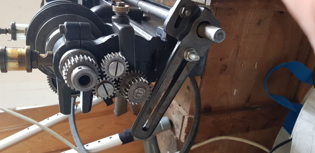

                                      I thought it was time to put it all together, more for damage control to find if any parts are missing, looks like it was a good plan. There are a number of parts that look like they belong but I haven't worked out where as yet. I may post some photos so you can help me with this later. You have all been a great help so far.
                                      The back plate has three screw holes that line up and fix it to the Lathe. After fitting the back plate the large Myford cover can then be fitted, screwed through the back plates reverse side and into the cover. When the cover is on there is no cut out for the switch lever which slides onto a spindle but it does line up with the exposed gears correctly so can not be placed anywhere else. I will take some photos or maybe a video would show it up better than I have done already with photos.
                                      thanks for all the help chaps tomorrow it may look a little clearer for me.

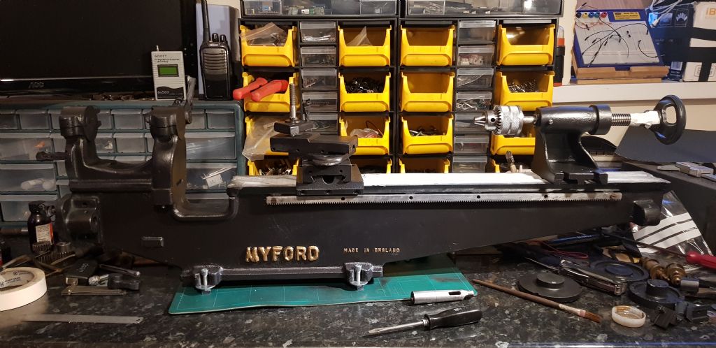

                                                  Had a week down south so nothing has been done on the Lathe. Back last night so I have painted a few parts and mainly been selling everything I have to get some ££ together for my next project. The little lathe has been sold on so only two Lathes here right now but THREE Lathes will be squeezed in here tomorrow.
                                                  I admittedly have very little knowledge but I have to think of how easy it will be to sell on after refurbishment as the Clarke Lathe is still here and needs to go ASAP. Space is a premium. Still can't work out how to post a sales thread here. Do I have to be a member for so long?
