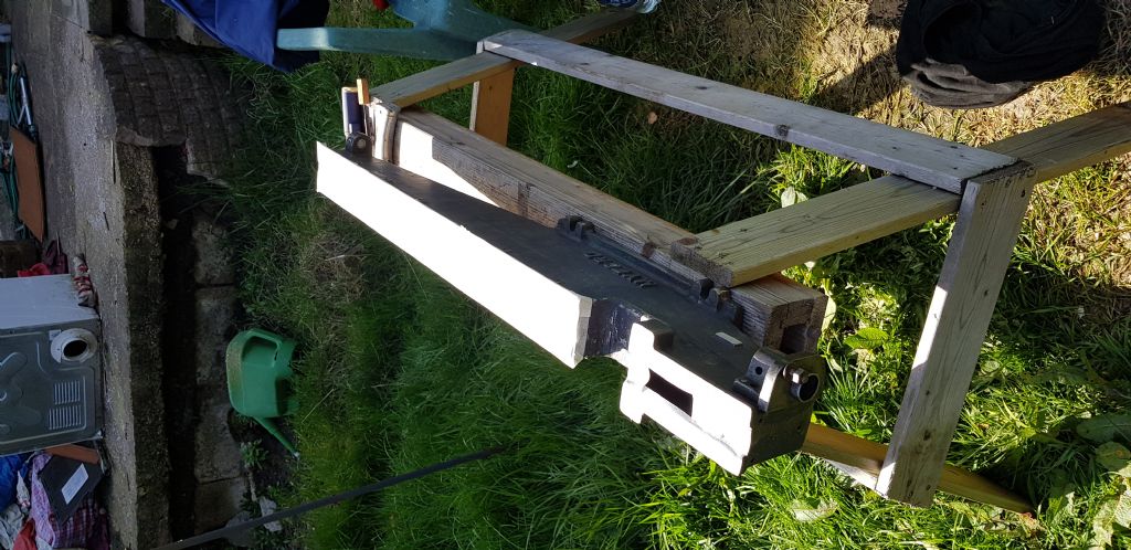

                    Thanks for all the replies I will try to work it all out tomorrow. I just found some timber running down the middle of the length of the Lathe. I presume this is as standard.20190404_233802.jpg

                      The Lathe bed does not look worn to me. Will get some decent photos in the cold light of day.

                        I have the same timber on my one too, so I guess it is standard.

                            Posted by AdrianR on 05/04/2019 07:46:15:
                            No wood on either of the two I have had, or any of the others I have seen. I think it's just a clever way of stopping swarf from dropping down where it's difficult to clean out. I wish I'd thought of that!
                            The gap in the middle serves no useful purpose except saving weight, and if memory serves, the ML10 had a bed without a gap.

                              I think the timber is Brizilian Mahogany. Scraped an inch of oil off of the top yesterday. Will have to highlight it in some way.

                                Is the wood there to perhaps dampen vibration (as in tuning fork effect) in the lathe bed.

                                  Possibly, I'm thinking that as George said and as they are hollow it would save filling the Lathe with swarf.

                                    I would make sure the timber insert doesn’t get wet, when wet it can swell and apply considerable force, if it can split stone then it might manage cast iron too.

                                      I'm going to scrape all the oil off rub it down and apply several coats of Varnish. Possibly stain it first. Have to match the wooden handle I guess. Don't want to use a dark stain as that would be cheating

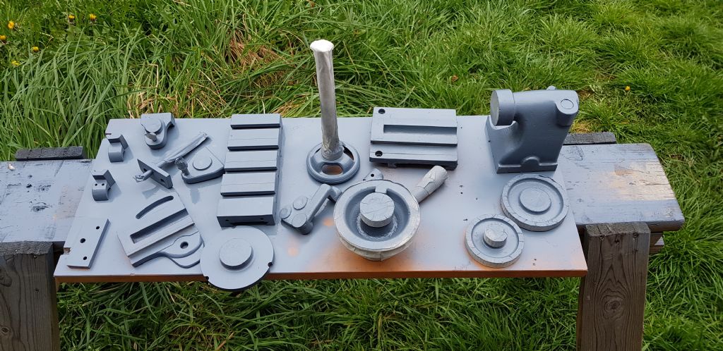

                                        Now the fun part.

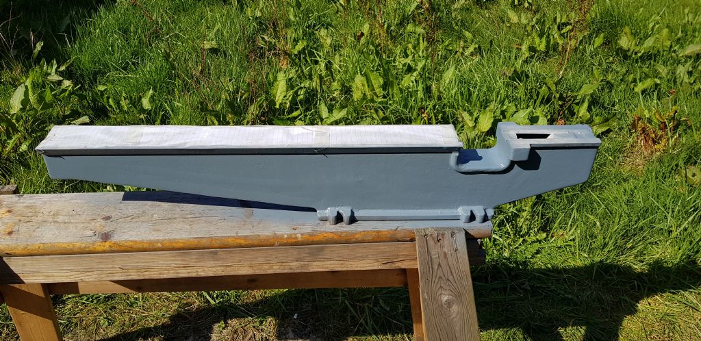

                                          A whole day to mask up. Less than a minute to paint.

                                            The missus just asked me why I was painting it Grey thinking

                                              I'm sure the Colour will be controversial

                                                  Curious – I can see the photo of the painted components under "A whole day…", but the three under "Now for the fun part" are barred.
                                                  Could it be because their image file-types are quoted as ".jp" rather than ".jpg"… ? Yet so is the parts image!
