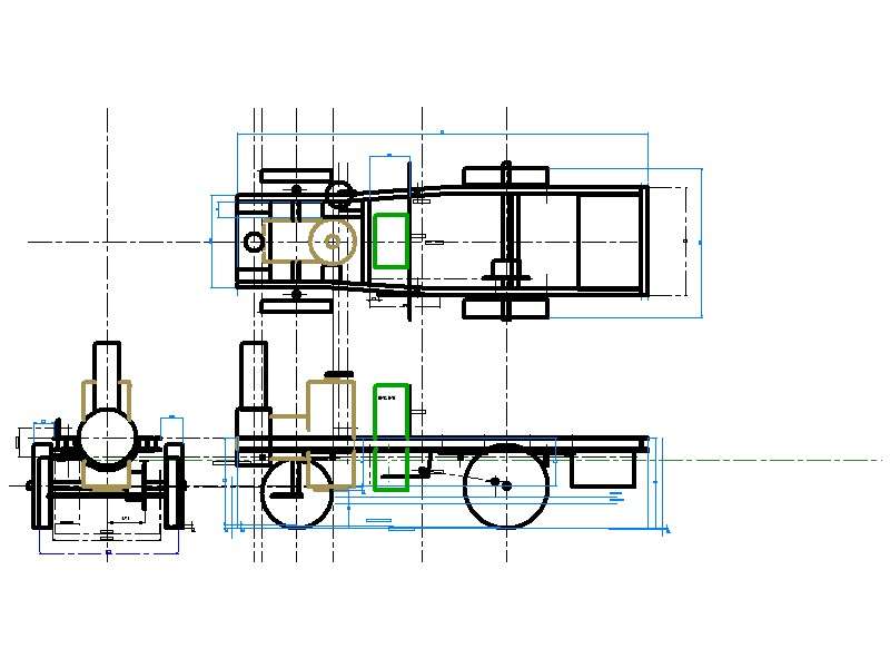

– and the functional problem of inordinately long external pipes from regulator to superheater thence back to the engine (aft of the boiler).
Essentially I was considering how to put a superheater on a miniature replica of a vehicle that never had one in full-size, and although the boiler has four flues for it, I do not now think it feasible practically or worthwhile thermodynamically.
I will try to produce a basic GA of the front of the wagon to show what’s where. I have a very rough, partial orthographic drawing in TurboCAD and might be able to do something from that. Attached below. I have not tried to create a 3D image: I cannot possibly do that in either Alibre or TurboCAD; but the latter allows orthographic drawings.
The green rectangle represents the overall outline of the engine including the cylinders. The boiler is in brown outline. The steam outlet and regulator valve is not shown but is at about two-o’clock in plan on the circular firebox top (the middle circle is the ‘stoking-shoot’ to use the original makers’ term). The engine’s steam inlet is on the rear off-side corner of the engine top – the cylinder block is itself rectangular.
So a superheater would need a pipe drop from the regulator to slightly above chassis top, forwards into the smokebox through the latter’s wide internal flange; return beyond the boiler then back upstairs to the engine inlet.
Sorry- you may need enlarge the screen to view the picture!

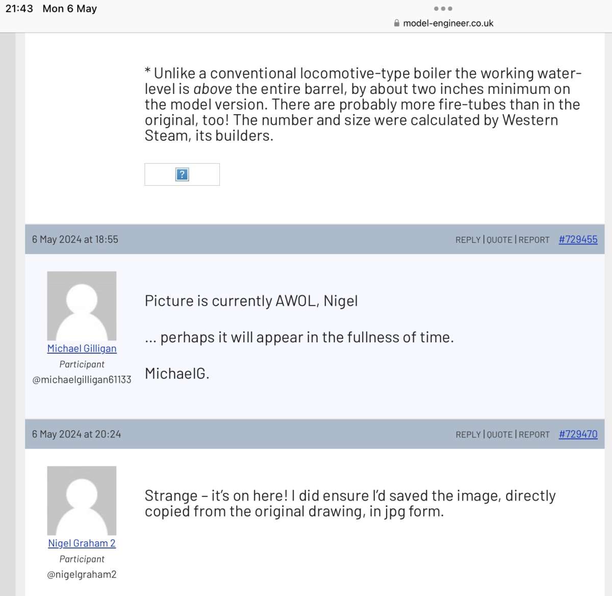

Oh – strange! The left-hand Shift key works On All Letters Except ‘T’. I needed use the right-hand key to start “TurboCAD” but the left one still works for the “CAD” bit. This has only just developed. Have I mistyped some arcane control combination?
* Unlike a conventional locomotive-type boiler the working water-level is above the entire barrel, by about two inches minimum on the model version. There are probably more fire-tubes than in the original, too! The number and size were calculated by Western Steam, its builders.
Picture is currently AWOL, Nigel
… perhaps it will appear in the fullness of time.
Strange – it’s on here! I did ensure I’d saved the image, directly copied from the original drawing, in jpg form.
I’ll try and re-copy it….
Somewhat simplified and tidied. Bunkers, footplates, seats, springs, most steering and transmission components and most smaller details omitted.
