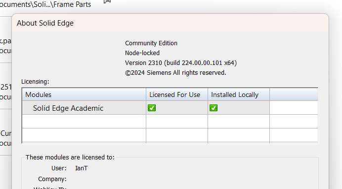

                            I am using the free to download ‘Community Edition’ which when you look at the “About Solid edge” box, reveals itself to be a locally installed version of the ‘Academic’ module. Hence my reference to it being the ‘Academic’ version.
                            I am long retired and my Student days ended beforte IBM announced the System/360 and no one had evem dreamed of Computer Aided Design. However, I did spend the second half of my working life in the Computer Industry, finally retiring from a large multinational software company. So I do have some understanding of why companies might like to attract ‘Users’ – that might one day become ‘Customers’. It’s a win-win situation….
                            So whilst there is some risk in using a “Free” commercial CAD product, I am happy to take that risk for the benefit of using a product that is clearly good enough to be used commercially.
                            Regards,
                            IanT
