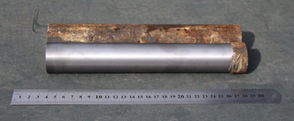

                  Two halves of a single sash weight, one still in the "raw" and one cleaned up and ready for use. Each one yielding a 10" long by 1.5" diameter length of silky smooth seasoned CI………..

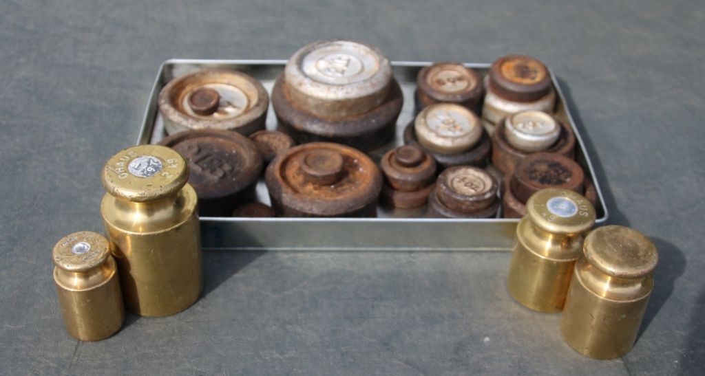

                  …………and another small selection of brass and CI ready for re-cycling.
                  Acquiring materials like these for next to nothing puts a big smile on my face. laugh
                  Rik (somewhat filthy after turning that bit down)

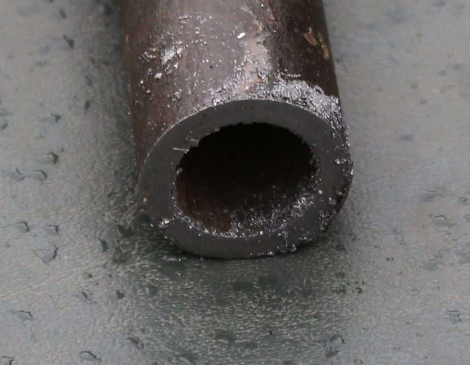

                                Thanks for the enlightenment John. Whilst on the subject, I dug up (literally) a bit of ancient old gas pipe which I turned a bush from some days ago. I used my best sharp knife tool and the stuff came of as ragged as a witch's knickers. I fully expected such old stuff to turn quite nicely so was surprised. Never can tell can you?
                                Rik

                                  The old gas pipe will be like water pipe, quite soft to allow the pipe to be bent easily, it will cut not too bad with sharp tools. Sometimes if you'r unlucky the weld will pop, I'v had that happen when I bored the inside, I rewelded it from the outside, and it's still in use as the power cylinder of a hot air engine built in 1992. Ian S C

                                    Ian – I think we might be talking about two different things. You'd never bend this stuff as the walls are to thick and its seamless as well. My best knife tool will slice through tool steel a treat but not this stuff.
                                    As far as I know, gas pipe over here does not get bent – it is threaded and then fitted with a cast iron bend. If I'm wrong I'm sure someone will take me to task. (Thinking about it, this might not be gas pipe at all – but it's still c**p stuff to machine.)
                                    Rik
                                    27mm dia.

                                      Looks exactly like the overflow pipe I pulled out of our bathroom. Galvanised and until I got it ought I thought it was lead. I did manage to bend it, just. I haven't tried machining it yet.

                                        All blindfolded darts at the bull. It is definitely the barrel from a Model 1847 Congolese Monkey Musket.

                                          You need to get some of the modern yellow plastic coated gas pipe if you can, that machines beautifully.
                                          Never seen a weld in it, got some short lengths when they were doing repairs around here, wish i had more.

                                            When they first started making and distributing coal gas for lighting purposes they used musket barrels joined up and sealed to carry the gas, obviously a bit hit and miss but cheaper that specially made gas tube. The way they keep digging up the roads to replace gas tubes I think they are still using the old musket piping!
                                            Clive

                                              Mmm That looks like a handy bit of tube.
                                              One of the tele co firms in Christchurch bought up the redundant gas supply pipes in the city, left them in place, and fed the optic fiber cables through them. Ian S C
