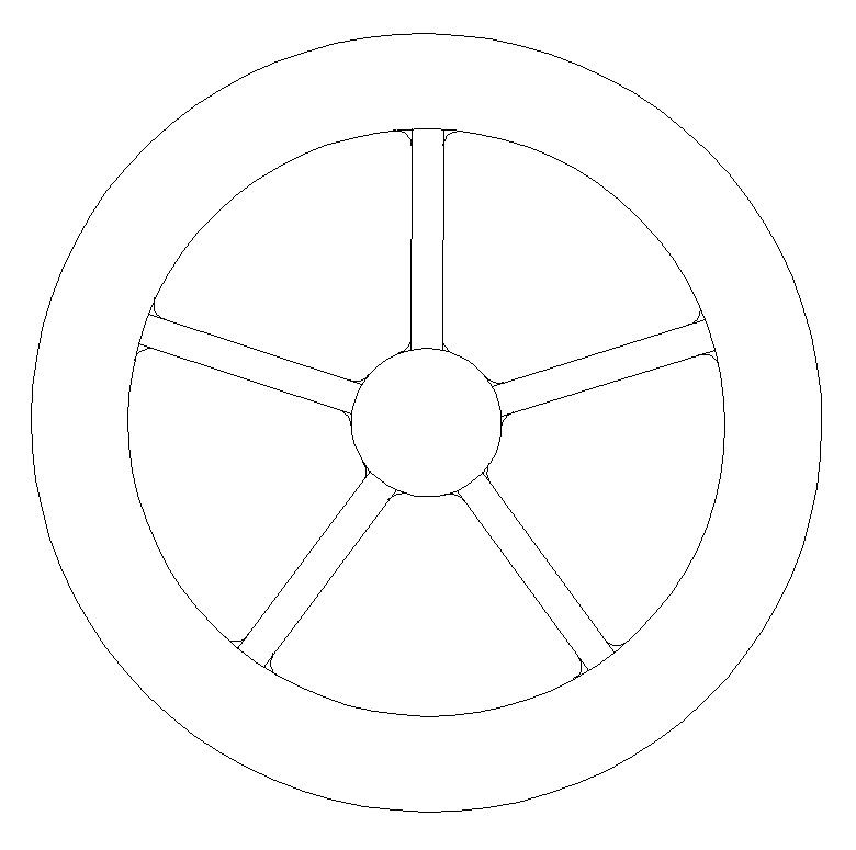

        You could probably get an old copy of TurboCAD PP on the cheap. This was done in TCAD V16.

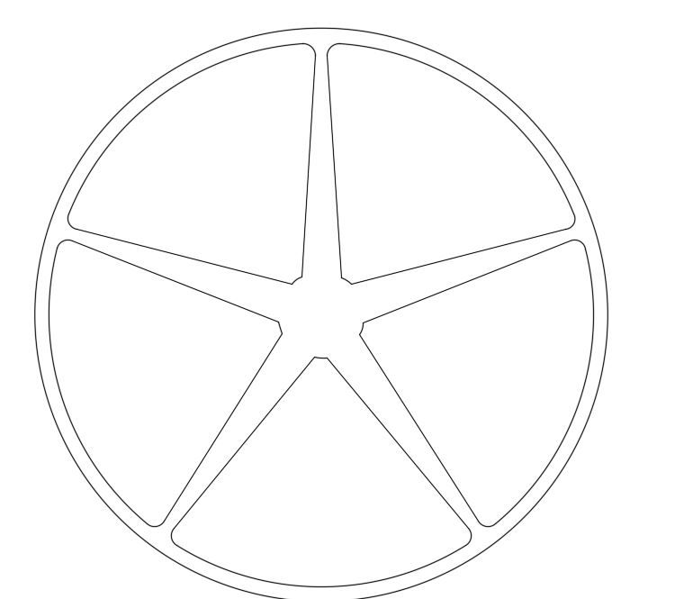

          Although mostly regarded as 3D Fusion 360 will happily produce 2D images for free

              Posted by JasonB on 30/06/2020 17:11:33:
              Thanks Jason, will take a look, thanks
