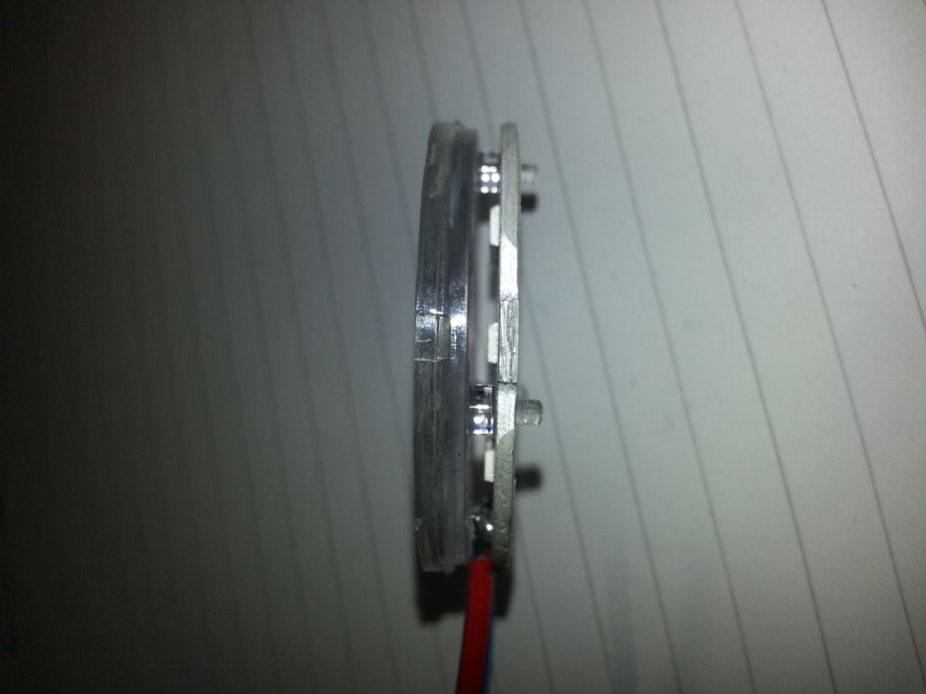

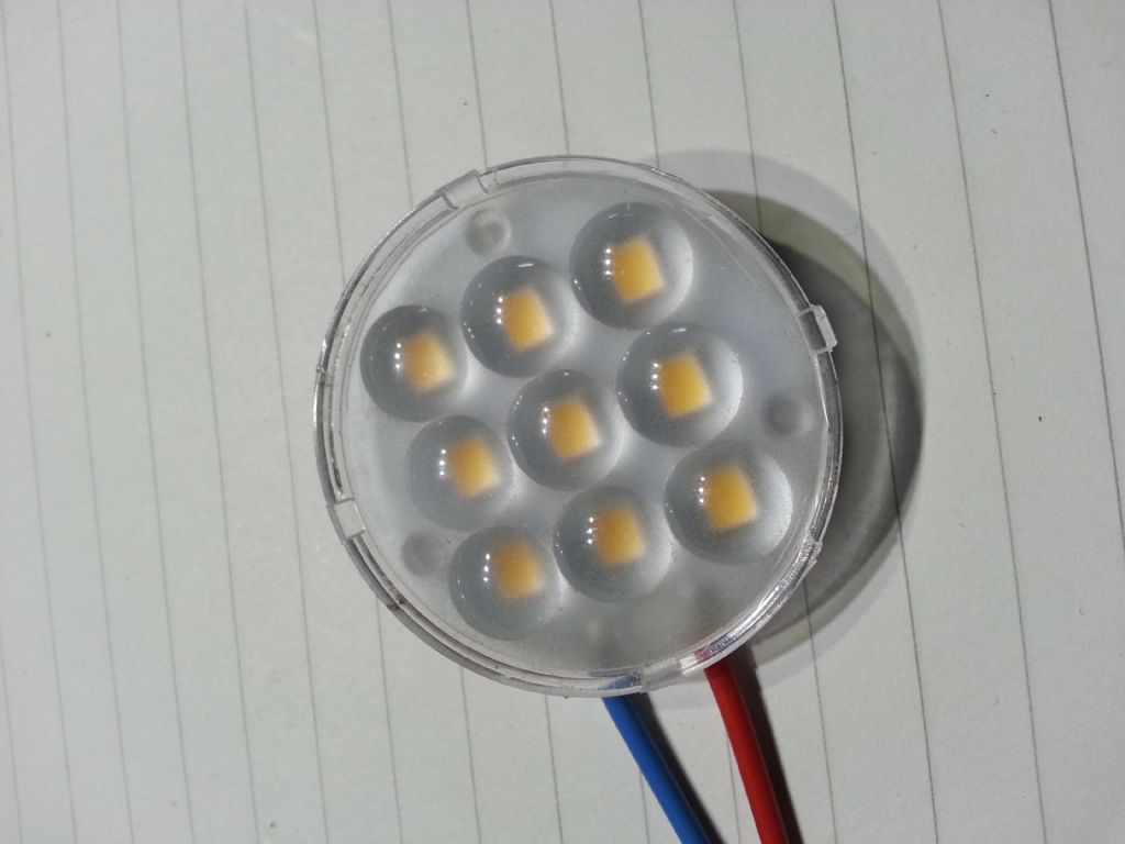

      Earlier this year I had a job that involved fitting 100 GU10 led spot lamps to a piece of scenery. whilst sliding the lamp unit in place one of them had the pins knocked off. I kept the damaged unit and filed it away. It surfaced last week during a clean up and I took it apart.
      What I ended up with was a disc 43mm diameter by 10mm thick comprising a circuit board and a plastic lens. Running at 9V it draws 120ma and gives a very respectable light. 20140824_130301.jpg
      Whilst playing about with it I accidently connected it to the wrong side of my power supply which caused it to get so hot that it melted the solder on one of the leads. Miraculously it survived!
      So should you come across one that is defunct it may be worth a play. We paid £4-00 each for them (in quantity).
