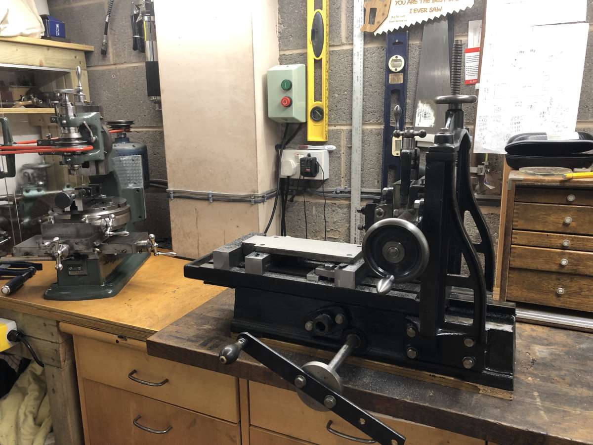

      I’ve recently been reading the Centennial Celebration Collection and came across a July 1899 article by Francis W Shaw, which describes the production of a small bench planer.  It looks like the article may of been part of a series but I can only view the one from July.  The description, drawings and image are very similar to a planer I acquired a couple of years ago, with no manufacturers nameplate (pictures attached).
      The article implies that castings and drawings to make the planer were readily available, but it does not say where from.  Can anyone shed any light on this machine?  Could mine be the Francis W Shaw machine, was this a ‘kit’ produced by many model engineers of the time?  Was it something that could be purchased complete or as a kit (like the G P Potts milling/grinding spindles) and if so who supplied it?IMG_2153IMG_2157

        What a beautiful machine, just crying out for an electric motor conversion!

            It is beautiful, and very useful, Baz… but conversion? Why?

              Simple, at my age and poor health winding that handle for half an hour would give me half a day out with the undertaker!

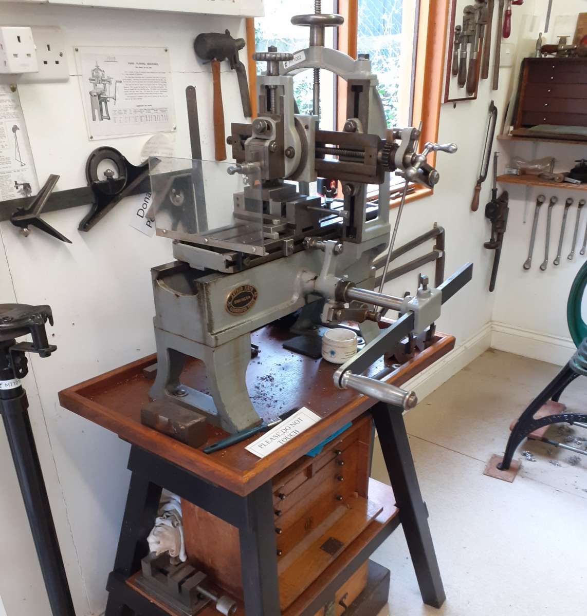

                There is what looks like the same machine at the Amberley Museum in West Sussex.
                The oval plate on that one reads ‘Arthur Firth, Engineer’ I think, but I can’t read the rest.

                  It looks as if the Amberley Museum machine is used occasionally, but perhaps only for demonstrations.

                      Put the two photos side by side and look closely at them.
                      On the black one, there is an additional shaft in front of the operating handle. On the black one, the columns bolt to the side of the bed casting; on the grey one they bolt to a flat area on top of the bed casting. One is auto-travese, the other is manual traverse.
                      The curved brace joining the two columns is similar on the two machines, but after that the differences appear.
                      In today’s world, motorising one of them might be easier than in the past. I think it is true to say that to reverse the bed movement on both machines requires turning the handle in the opposite direction. That means any motor drive would need to reverse each cycle (and go faster on the back stroke to the cutting stroke). The motor would also need to spin a variable number of revolutions to vary the stroke as there are no reverse trip dogs, only a feed dog.
                      With a three phase motor, this would be easier than with a single phase (as single phase motors do not like frequent reversing). With a stepper or servo motor, it would be easier again – in essence, the software that has been developed for dividing head/rotary tables forms the core of the logic. In them the number of divisions determines the number of steps (motor pulses) output; in a planer drive, the length of stroke would determine the number of steps.

                        It is worth taking a good look at the two pictures and trying to determine how they could be made to operate with continuous handle rotation.
                        That implies a reversing mechanism of some type (q.v. Whitworth quick return in a shaper). It also needs some form of control to tell that mechanism when to operate at both ends of the stroke (stop going forward and start going backward; stop going backward and start going forward).
                        Looking at the space available and details visible, it is hard to conceive such a mechanism. I wonder what is the analogous trade to the barmaid but which works in a circular clockwise and anticlockwise manner. Maybe a seamstress who does as much backstitching as standard stitching.

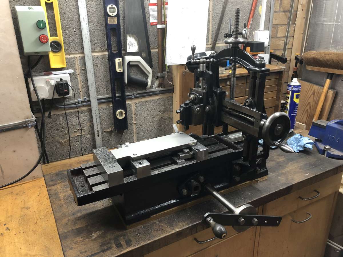

                          Thanks for all the comments and feedback.
                          For now I’m happy with the manual operation.  Progress is slow and I might add some power later, but would want to design something that didn’t alter/damage the original structure.  At the moment it is light enough that I can slide it off the bench onto a purpose made trolley to create space in my very compact workshop, so happy to sacrifice speed for flexibility!  However, a automatic step over mechanism is rapidly climbing my priority list.
                          I use the planer regularly and can attest to it being much less strenuous than my Drummond shaper.
                          The Arthur Firth and Tom Senior planers definitely seem to share a lot of same styling, although mine does not have the T slot on the side of the table to adjust the travel stops.  There is also a page on lathes.co.uk for Hesketh Walker planers, which also includes a picture of a similar styled machine but with power and auto step over.  From the text on that page I had thought mine was a Hesketh Walker or Liverpool Casting Co model until I found the Francis Shaw article (although I do wonder if the picture on lathes.co.uk has got mixed up in the formatting).  I wonder if there is some link between all of these that lead to an evolution of the design.
                          If anyone has a full set of 1899 editions I would be interested to know if there where other articles by Francis Shaw on this subject.

                            With regard to DC31k’s observations…  The columns have tenons that are a snug fit in grooves machined into the bed casting.  These positively locate the columns for height and squareness to the bed.  This is exactly as described and drawn in the 1899 Francis Shaw article, although the Arthur Firth configuration looks a lit easier!

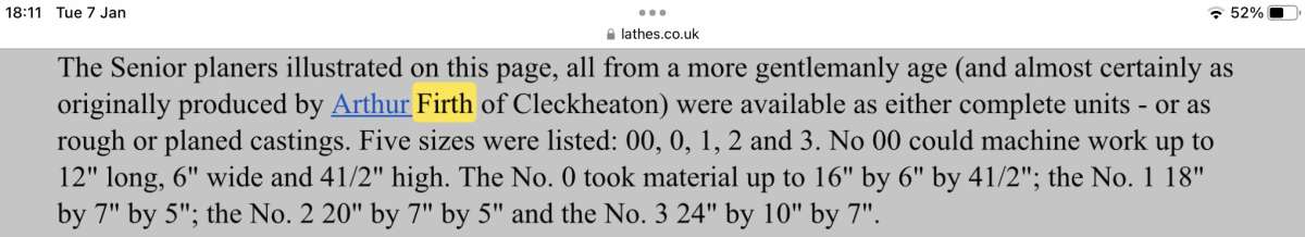

                                  No, David … I was [I hope] referencing the machine under discussion.
                                  [ Confused now … I will check later ]
                                  Edit: __ Perhaps “everybody” was already aware of this:

                                          Then I looked back at the Amberley photograph and realised, no, the shaft is too long for that. It is to clear the mechanism projecting from the end of the cross-slide, with the handle at full stretch! Not ever so good practice, that long overhang, though. It seems to call for an out-rigger journal, perhaps on the stand itself.

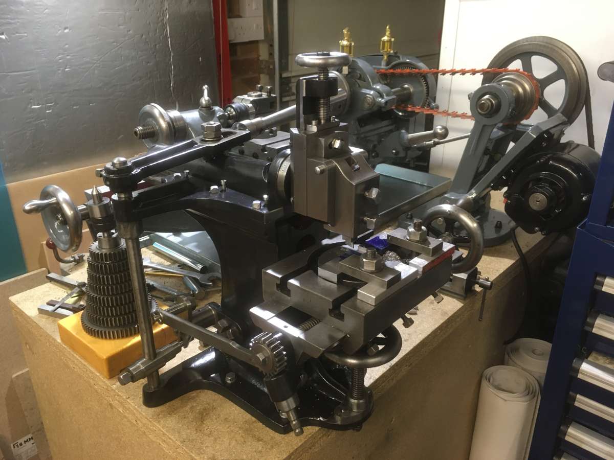

                                            Nigel – With the planer you do have to rotate the handle both ways.  I find it more awkward to get into a good rhythm with short strokes and the shaper is easier for that type of cut.  However, for longer cuts the planer is easier and faster.  On CI I can take cuts around 10/12 thou and plane 9″/10″ length cuts across ~5″ wide in around 25 minutes with a very fine cross feed to get a good finish.  I usually use the shaper for mild steel but cuts much over 5 thou are hard work, so I tend to rough parts out on the mill and then take 1 or 2 thou cuts on the shaper, with a shearing tool in order to get a nice surface finish more in keeping with the machines I’m restoring.  I think the pinion shaft on the planer is extended simple to give good clearance of the bench and enable space for an optional step over feed mechanism (note also the extension of feed screw).  Also, to work at a good speed for a right handed person, you need to crank the handle with the right hand whilst having your body twisted around to constant hold the feed screw hand wheel with the left, to increment the feed on every back stroke.
                                            Bazyle – I think the long handle on the shaper is purely a mechanical consideration in that you need the leverage to cut.
                                            I wouldn’t be without the shaper or planer, but they are not for everyone!
