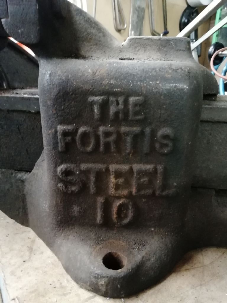

      FORTIS No 10

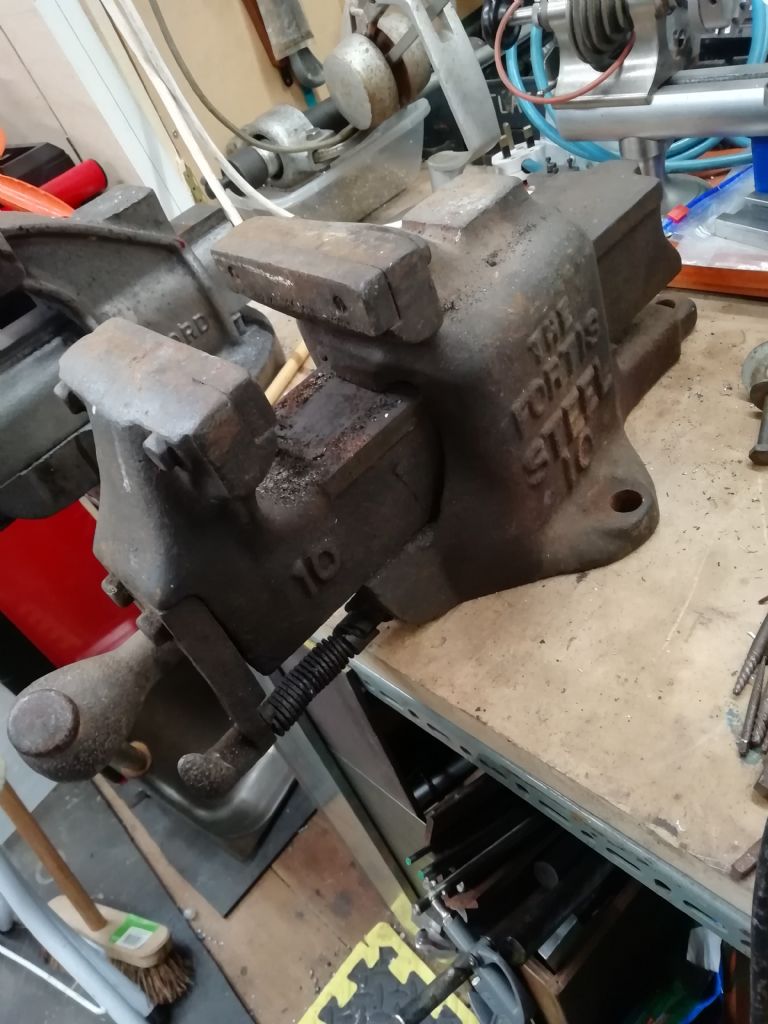

      I just acquired this vice which I intend to restore and wondered if anyone knows what the original colour would have been?
      Cheers
      Roger

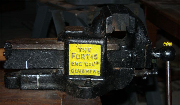

              This is going to add confusion, but… In the training dep't of the firm where I worked years ago we had Fortis vices that as the firm was almost obsessive with the care of tools and machinery I'm sure they had never been repainted.
              Some were dark green, others were blue/ grey, I'm sure if they had been repainted they would have been in one colour. Interestingly there were a couple that had a split moving jaw that could be set to act like a V block for holding round bar vertically in the jaws ( these were green). I was kept on for a while to help clear the place after it closed and I found the original sales pamphlets and order letters in a file, believe they were made in Coventry, but this was late 70's so might have that wrong!. The place was set up just after WW2 but can't remember the dates on the orders.

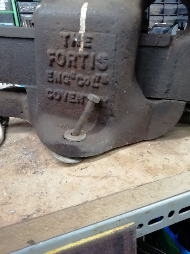

                  Hi Dave, you're right, Coventry it is.
                  If I can't find the correct colour I might go with what I've got – Denham grey or Record blue devil

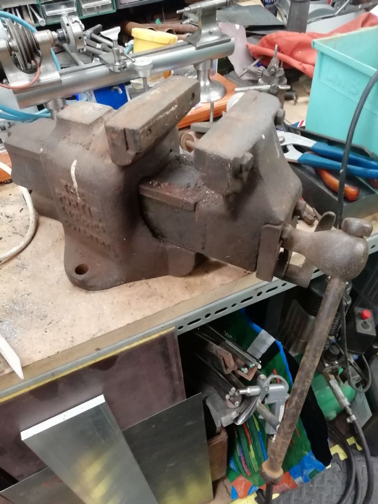

                              More photos of my vice:-
                              The removable jaws are seized up and have been dosed with penetrating oil in an effort to remove them, watch this space laugh

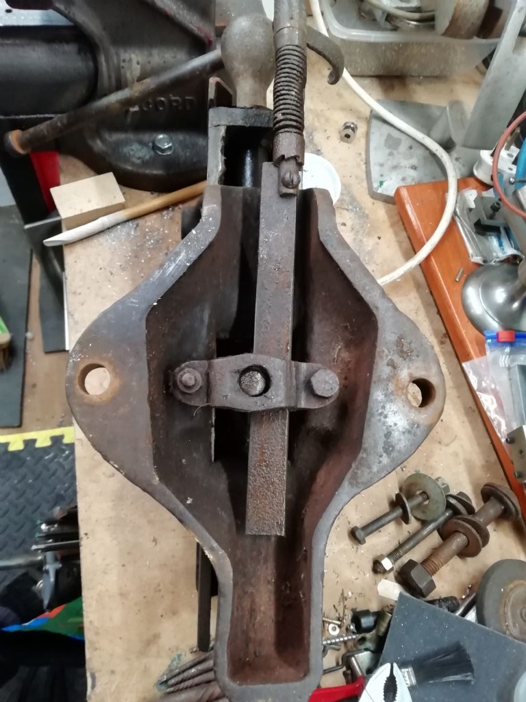

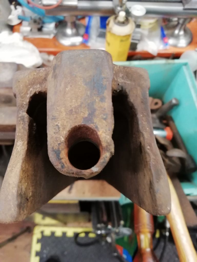

                                                  Is this ok? It's the support for the shaft at the back of the vice, if not, as it's steel, it would be ok to mig weld to increase the thickeness and redrill the hole?
                                                  #601098
                                                    Posted by Rockingdodge on 09/06/2022 11:53:07:
                                                    My advice is 'if it ain't bust don't fix it'.
                                                    Although you have a solid workman-like vice, I don't think the maker was overly concerned with the look of and finish of the innards. And even less time was wasted on War Production equipment unless operation was effected.
                                                    What matters is strength, alignment, and smooth operation of the moving parts, not the non-functional underbelly. Manky insides aren't unusual: whilst my Record is better than your Fortis, it's also rough where it doesn't matter.
                                                    Different story if the look is caused by extreme wear and the vice doesn't work properly because of it. In that case might be worth fixing.
