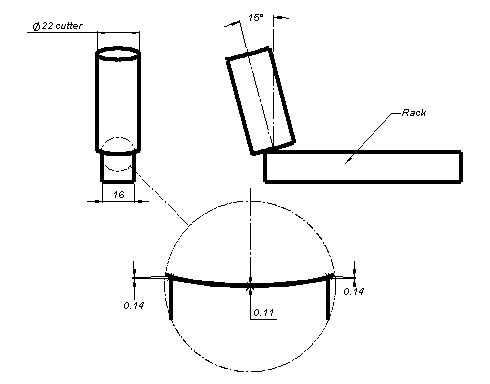

Rack cutter ground up, as it's brass it's just a single lip engraving type cutter with 40 degrees included angle.
Found a jig to hold it, not the same one I used last time but similar. Nice sharp shell end mill sorted and the angle needed.
