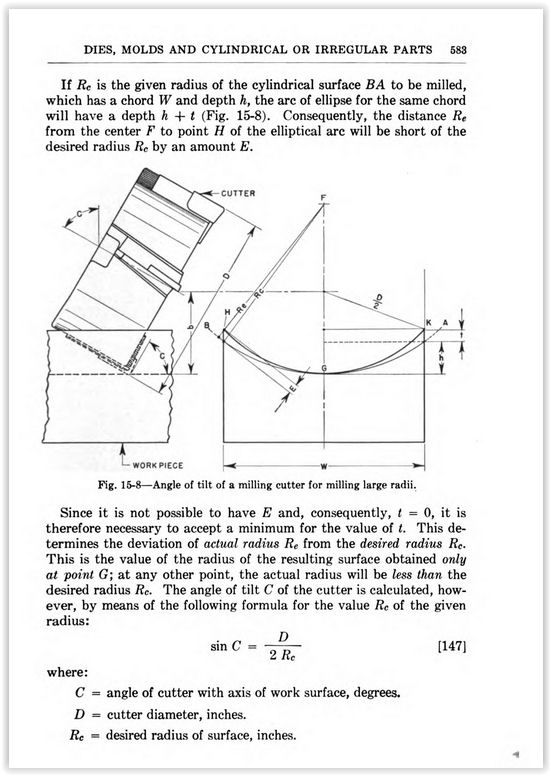

              I just turned this up with a quick google search
              sin C = D/2Rc
              where C = angle of cutter with axis of work surface
              D = cutter dia
              Rc = desired radius of surface
              Exquisitely covered in A Treatise On Milling and Milling Machines, Third Edition (1951), Page 583

                    Phil,
                    Bugger it, my copy only has 406 pages

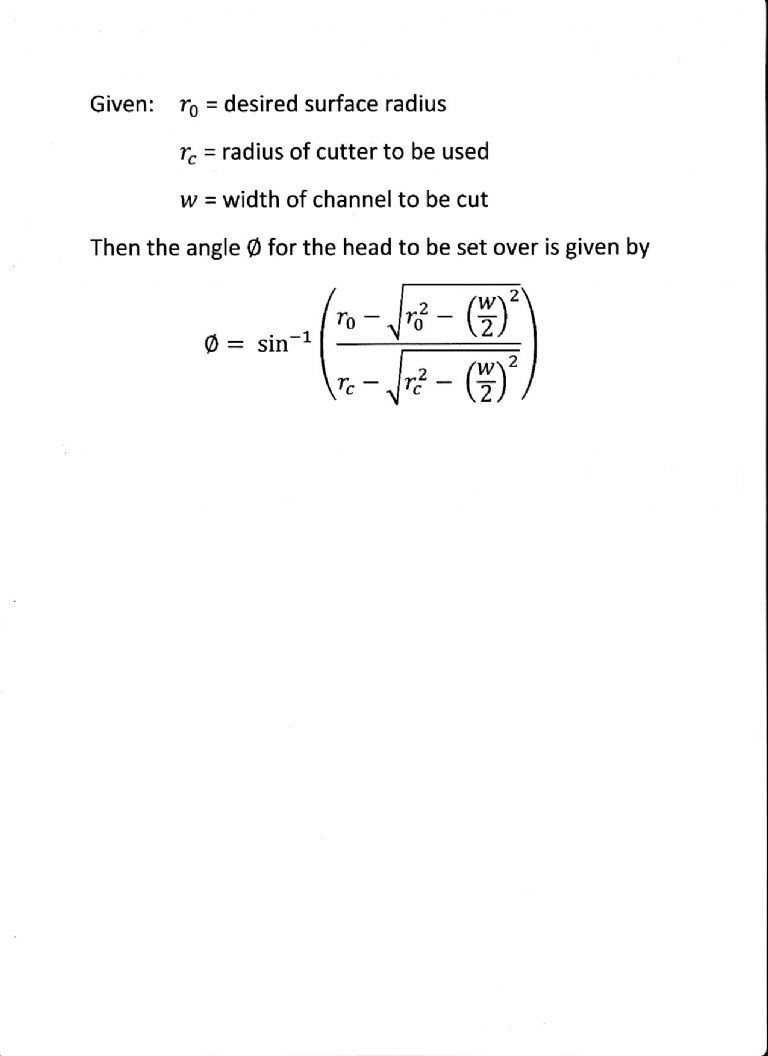

                            JS, as you probably know, the above formula are only approximate. I think that I have sorted the exact equation, as shown below. As you can see, the second-order effects only become significant when a reduction in the cutter radius approaches (channel width / 2) . In your case w/2 is 8mm and your cutter radius is 15mm, so the error in the approximation is small (~23.7deg vs exact 21.9xxxdeg), leading to a channel width that is approx 0.25mm narrower than your 16mm rack. Alternatively, if you advance the cutter until it occupies the full 16mm width, the channel depth will be marginally greater.
                            But in the greater scheme of things, it will hardly matter. The only real use of this is to emphasize that the simple approximation is just that, and to illustrate the effect of reducing the actual cutter radius too far.

                            Roger Head
                              @rogerhead16992
                              Phil P
                              "Exquisitely covered in A Treatise On Milling and Milling Machines, Third Edition (1951), Page 583"
                              Any chance that you could scan/copy/xxx that bit, and post it?
                              Thanks, Roger
                              #215907
                              Phil P
                                @philp
                                Roger
                                I didn't find it in the book myself, I just googled it and that is what came up.
                                I probably do have the book but I will have to check when I am at home.
                                Phil

                                                Page 583 extracted.
                                                Les
