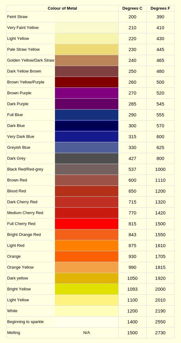

                                  Air quenching is mentioned for M42 in the link I posted. That's 10% cobalt. 5% and M2 / plain HSS is available and all will be different. The link also mentions 2ndry hardening and shows what happens with double long term annealing. It's weird stuff.
                                  This shows the hardening problem, it's for steel but HSS is likely to be similar in relation to burning
                                  HSS is heated to 1280C for hardening so my recollection of using 1300C in a muffle looks to be correct. 100C higher and probably oh dear.
