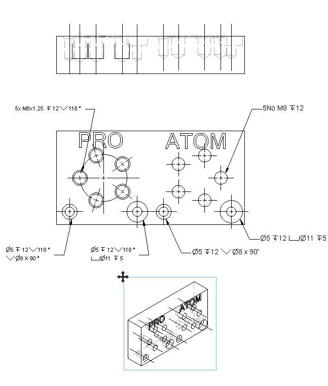

                      I think you have misinterpreted my comment, I am not talking about modelling a thread I was looking at producing patterns of standard drilled, tapped, counter bored and chamfered holes on PCD's grids and lines with the simple dialogue, this to me is a basic 3D cad function but I guess this low end version is aimed at 3D printing.
                      #390266
                        Most of those things can still be done with the basic ATOM but it will need a couple of separate steps rather than being able to do it all from one dialogue so it is not as you say "little use" to model engineers it is just that you have to pay more for an easier to use version.
                        The only things you won't get with ATOM is a call out automatically put onto a 2D drawing, work out the tapping hole diameter for you and a tapped hole will not be shown as double lines. For personal use this would not be an issue for most and even if sharing the files as I said earlier many old model engineering drawings don't show the holes as double lines (Stuart for example) so it is just remembering to add the call out to the drawing.
                        #390271
                          Here is a part with the holes in one side drawn using whats available in ATOM and the other side with the hole function in Pro & Expert.
                          3D modeled part looks exactly the same. On the drawing the Pro callouts came up based on the model, ATOM I typed them on. You can also see in both the plan and side elevation that the Pro threaded holes ares gown with twin lines and the pro ctr lines of the holes are on the PDC .
                          I would say both are quite usable for model engineers, you pays your money for what you feel you need but definetely better than "of little use"

                              Posted by Graham Waterworth 1 on 10/01/2019 00:14:40:
                              Not sure what the problem is, it's easy to create a pattern of features in Atom3D. Just create one and then use linear or circular pattern.
                              Or are you looking at a different package?
                              #390322
                                Posted by Neil Wyatt on 10/01/2019 11:38:56:
                                ……………..simple dialogue………………………
                                This is the main Difference, with the full monty you can do the drilled, tapped, CSK/CB all in one drop down which does simplify things.
                                You can get all those things the same with ATOM on the 3D model with a bit more time and effort. You get a slightly better 2D output with pro/expert.
                                For example in ATOM you would need to know or look up the tapping size to draw the circle and then cut extrude the hole, add a chamfer or sketch and cut a counterbore, point the end and type the callout on 2D. For Pro and expert you select thread form & size and it has a tapping size in the library*, you can select flat bottom or drilled hole, CSK, CB etc from the dropdown and size them all from there. PCD or other pattern is no different to enter for either
                                * It will not put tapping size on the 2D drawing so you would have to look that up in the workshop anyway if you did not know
                                Edited By JasonB on 10/01/2019 12:24:02
