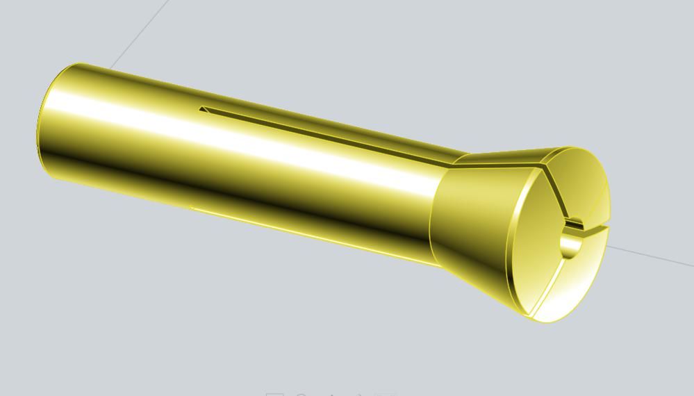

      blowlamp
        @blowlamp
        Making a collet in MoI using simple steps.
        I later exported a DXF of the drawing to ECam, which generated the gcode to make some on my little CNC lathe.
        Martin.

                I was trying to keep it slow but simple. You don't have to jump to those boxes with the mouse – for most of the time you can just start typing and MoI will oblige. You can TAB between boxes if you wish.
                MoI isn't a Parametric Modeller so it's not driven by dimensions, but sizes are fully editable and there is some history that allows some manipulation of solids/surfaces from their control curves.
                I had another go at the collet to make it quicker to draw and include a slotted collet like yours – straight out of MoI, but in 24k gold. wink

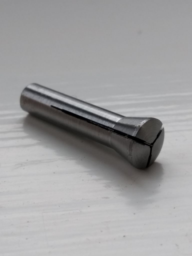

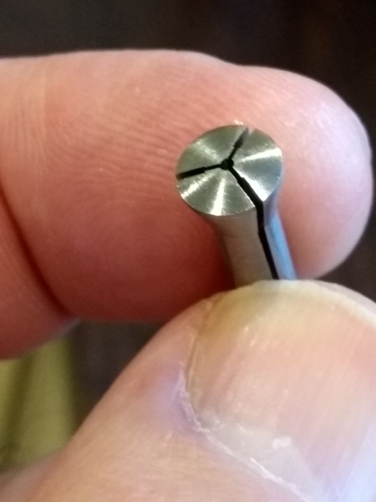

                            blowlamp
                              @blowlamp
                              Finished parts.

                                Thank you Eddie, that was much clearer. Did you drill the centre before or after turning the profile? If after, how did you hold it?

                                  blowlamp
                                    @blowlamp
                                    Thanks for the feedback. yes
                                    I drilled the holes first to maintain concentricity and before cutting the profile so as not to start drilling on a curved surface. A spotting drill was also used in an effort to keep the holes on centre and prevent wandering.
                                    In retrospect, I think I'd have been fine either way because of the spotting drill's rigidity, although doing it the way I did let me drill a little deeper into the waste to ensure the tip of the 'bore-size' drill was fully contained at the start.
                                    After parting off, they were held backwards in an ER11 collet and drilled @ 2.7mm to about 7mm from the front end and then tapped M3.35 x 0.8mm pitch. I had to make a tap due to the non-standard size.
