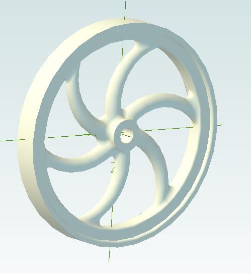

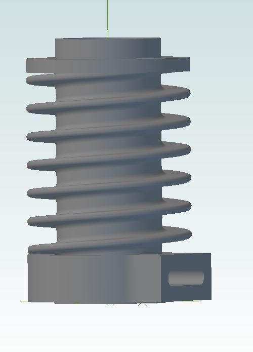

                          Blowlamp, a couple of examples. Both drawn with Alibre BTW
                          The flywheel has curved, tapering oval section spokes all filleted into the hub and rim.

                          This cylinder has a single helical fin that is tapered in section, rounded on the edges and filleted at it's route. Expect this to need 4th axis

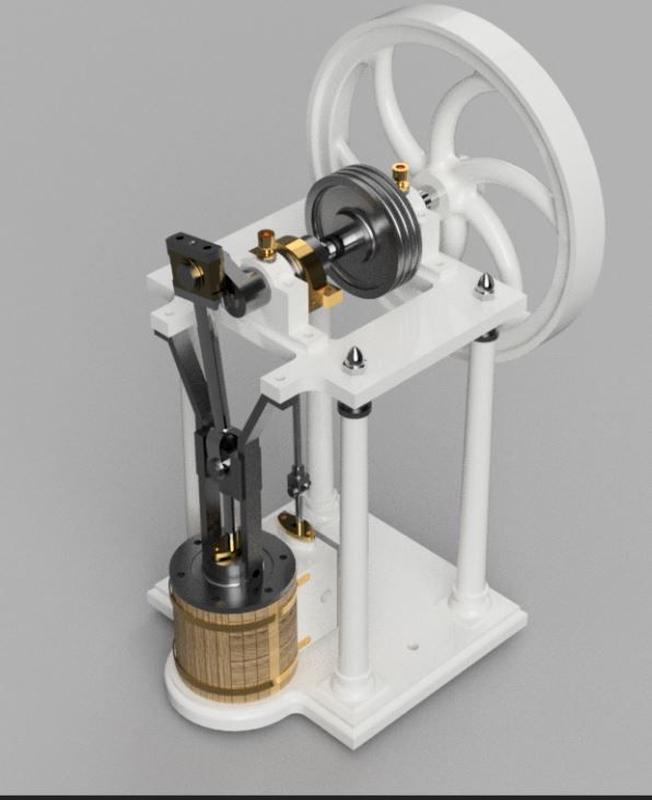

                          As Andrew says the ability to assemble parts is good, you can check for any clashes, make a quick adjustment to a part and then back to the assembly which will have that alteration, I used it a lot on this one to make sure the conrod did not foul the guides which is easy to you by holding the mouse on say the flywheel and turning the whole engine over to see the parts move.

                            I'd rough the flywheel using 2.5D commands and finish the spokes using 3D. I'd agree that the cylinder would need a 4th axis, although as drawn it's impossible to machine. The ends of the helical fin need filleting, or else you need a zero diameter cutter. smile

                              Thats what I thought andrew two basic 2.5D to first make it like a solid fluwheel and then remove six bits of waste and a third using a ball nose tool.
                              Well spotted on the fillet, I am playing around with ways to do it manually ( 7.2mm pitch and a 72:1 rotary table) though which would allow me to slip the helix over the central cylinder so no fillet needed but would prefer it from solid which will mean having the cutter diameter at each end where the helix runs into the flat.

                                I'd machine the flywheel slightly differently. I would machine the OD, bore and recesses on the lathe to ensure everything runs true. Then I'd rough and finish the spaces between the spokes followed by the ballnose mill to finish the spokes. I might drill a hole in the waste area between two of the spokes to act as a locator when turning the flywheel over to finish the spokes on the second side. Because of that hole I may not completely clear the material between the spokes from the first side. If I did do that I'd predrill some holes in the middle of the waste to allow the swarf to be washed away when machining the first side of the spokes.
                                Andrew

                                  For the cylinder fins :-
                                  If you do not have a 4th axis and could be bothered to make a form cutter? You could helically mill it in the vertical plane. Several basic cam programmes have this facility. i.e. Estlcam.
