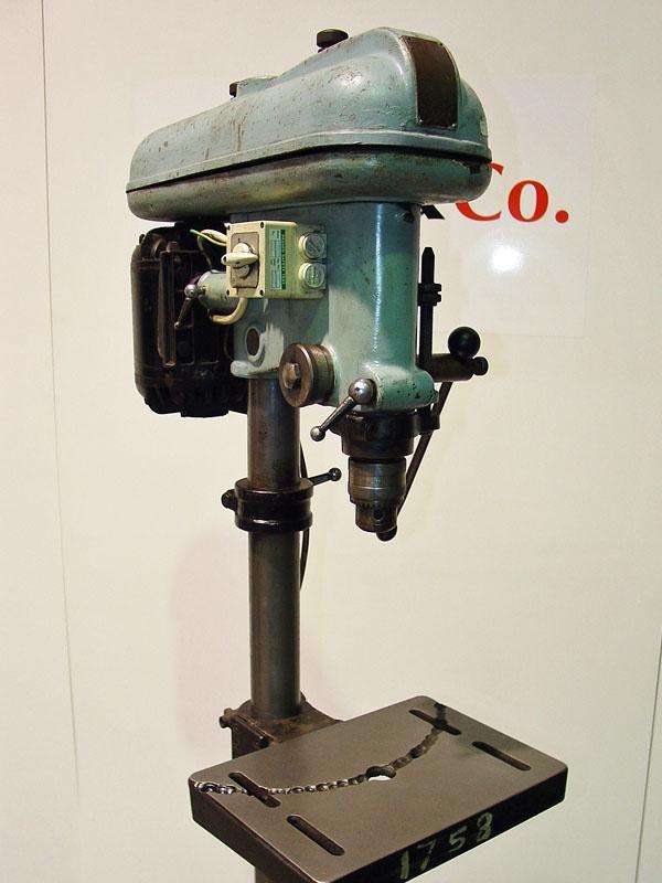

      I have aquired, cleaned and changed the bearings on an old neglected Fobco Star pillar and am having problems with thread sizes.
      I am missing the knurled top bolts that hold the belt cover in place and am looking for a suitable replacement, unfortunately I am a wood butcher and a total noob on thread sizes. Also the grease nipples seem to be a strange pitch?(Pipe thread?).
      Any help would be very(very) much appreciated.
      If anyone happens to have these spare I would be very interested.
      Also is there anywhere the locking handles can be sourced?
      TIA Jamie.

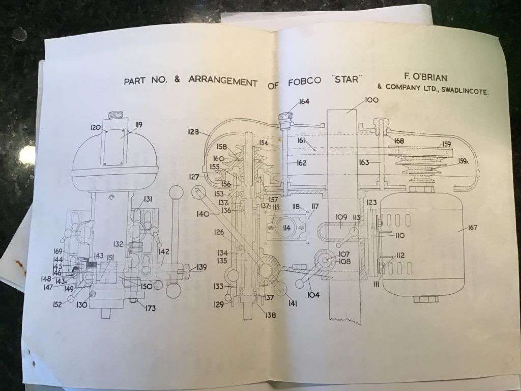

                                  I have the pair of depth stop nuts, the grease nipples are ok apart from one that seems to have a small dent and does not work so may be ok changing out to another one(the quill grease point seems to work fine luckily).
                                  The locking handle I am missing are the ones for the motor, one seems to have taken a knock and is bent and I am sure it is ready to snap.
                                  The only other thing I seem to be missing is the knurled locking nut for the handle that moves the quill up and down during use although I think I may be able to get my hands on this from a seller.
                                  I am missing parts 164, 168, 139 and 113 in the diagramme below.

                                  bernard towers
                                    @bernardtowers37738
                                    I think I’d be looking for a new table as well!
                                    #729484
                                    Craig Brown
                                      @craigbrown60096
                                      Jamie, I will have a look at what I have tomorrow, might have it all, I will message you.The collar for under the head allows you to undo the head, to rotate it, without it dropping.
                                      Bernard, I don’t think that is his drill, just an example
                                      #729566
                                      Astroboy
                                        @111122223354
                                        Haha, thanks Bernard. Yeah I think that would be on my list if that were mine. Mine is in good condition on top but the side has got a piece missing. I can live with it though as the top face is in perfect condition.

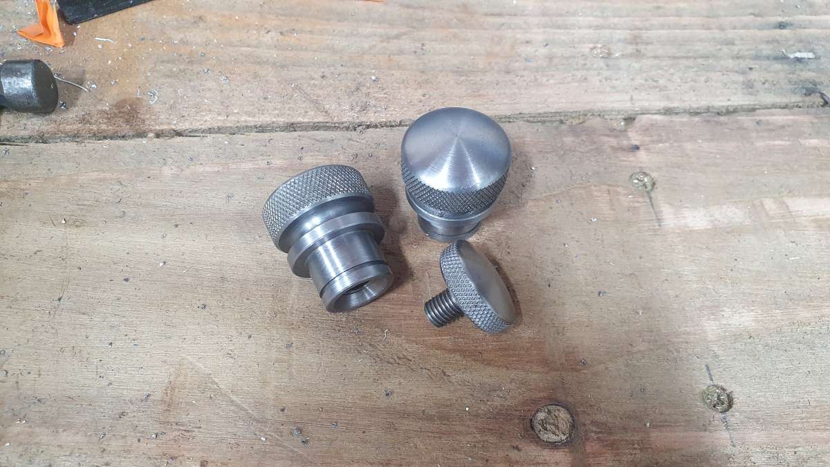

                                          Craig Brown
                                            @craigbrown60096
                                            Jamie I have sent you a PM but doesn’t look like I could attach a picture so this is what I have and can make some ball handles if you require.
                                            20240507_200524

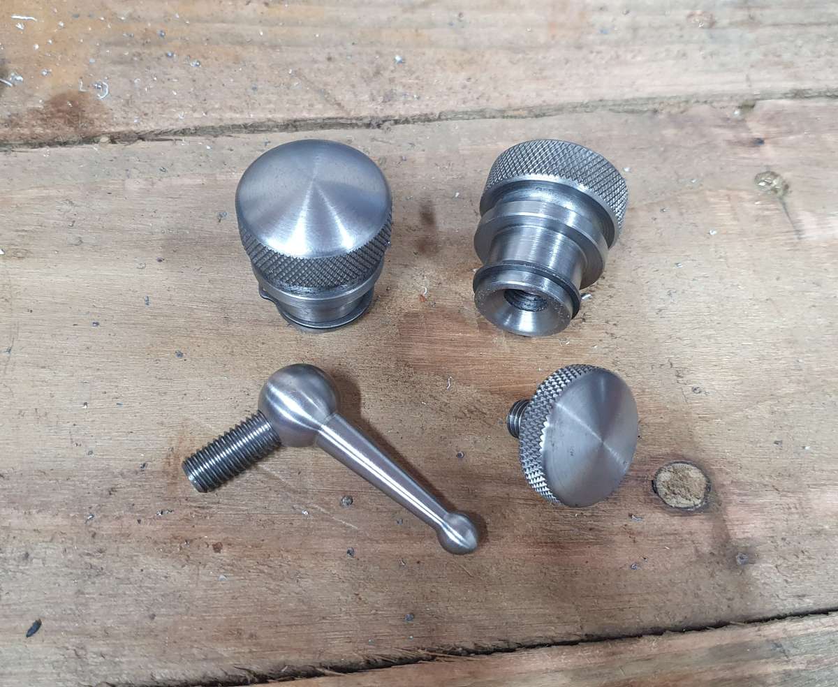

                                            Craig Brown
                                              @craigbrown60096
                                              20240508_203710
                                              Now with added ball handle
