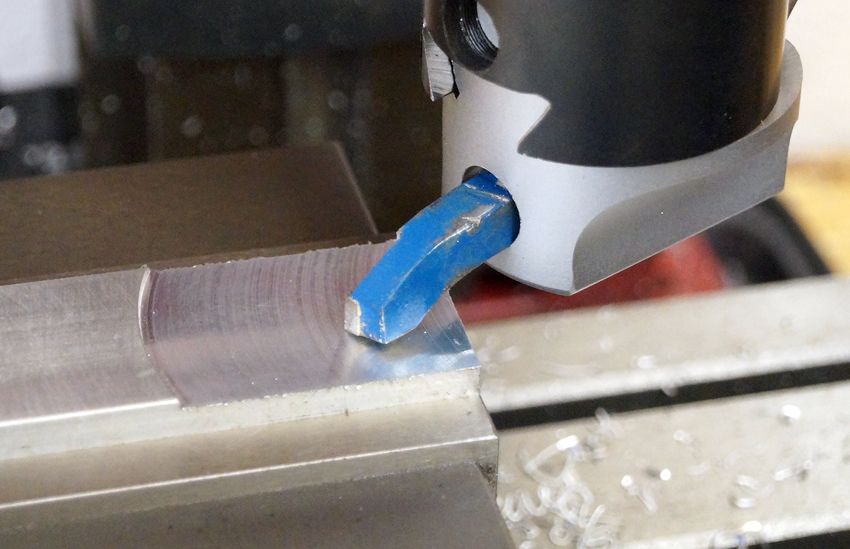

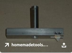

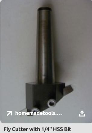

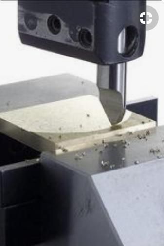

      Hello,
      Could you please give me a hand to better understand these 3 different types of flycutters ? Have become confused and perhaps misinformed by my internet searches. Would appreciate any commonsense comments debunking any known urban myths that us newbies may not have the skills/knowledge to dismiss.
      Alternately any known links or previous threads greatly appreciated.
      Flycutter 1 : Utilises a standard boring head, seemed to me to be a clever idea but have read that it can wreck the dovetail on the boring head and that the total amount of stickout below the quill isn't a good thing either. Possibility of the lower dovetail block getting loose and getting thrown off becoming a dangerous projectile ? Would be fairly easy to make this from a solid cylinder of steel thereby avoiding any of the dovetail associated problems.
      Flycutter 2 : Traditional shape plus HSS left hand grind toolbit. How/Why did the angled shape evolve ? Is there a best angle ? Why is this better than the orientation of the cutter in Flycutter 1 ? Does this simply relate to your preferred way of grinding the cutting tool.
      Flycutter 3: Single carbide bit mounted on a bar, fairly easy to make. Could use a circular carbide insert as well to give more cutting "points". Even easier to simply remove 2 teeth from a standard facing bar , although this seems to be very rarely discussed as an option – why is that please ?. Also possible to use a piece of HSS instead of a carbide insert – this leads to the idea of putting a piece of HSS in a tangential orientation and people claim this can give a much greater depth of cut in small machines.
      I have also seen Flycutter_2 using a toolholder that holds a circular carbide bit. Seems to me that if the insert is circular the angled toolholder shape of flycutter_2 isn't necessary.

          First anything that uses carbide was originally done with HSS, and before that plain carbon steel. Not everything that can be done with HSS can necessarily be done with carbide though.
          Secondly it is often difficult to understand which way the tool is cutting, and hence the required geometry. It looks like it cuts downward (for your photos) but the cut is actually sideways.
          Number three is the starting point – dead simple and the tool is anything to hand either screwed into a hole or under a clamp.
          Then when you have thought about the cutting direction and want to be posher using a full new square piece of HSS the angled version in 2 reduces the amount of grinding if you get it right.
          Number 1 is 'cos you've got one and haven't got round to making 2 or 3.

            The heavy cuts and interrupted cuts of a flycutter are not what a boring head is designed to cope with. I would not use that idea except maybe for light cuts in a pinch if I had no alternative.

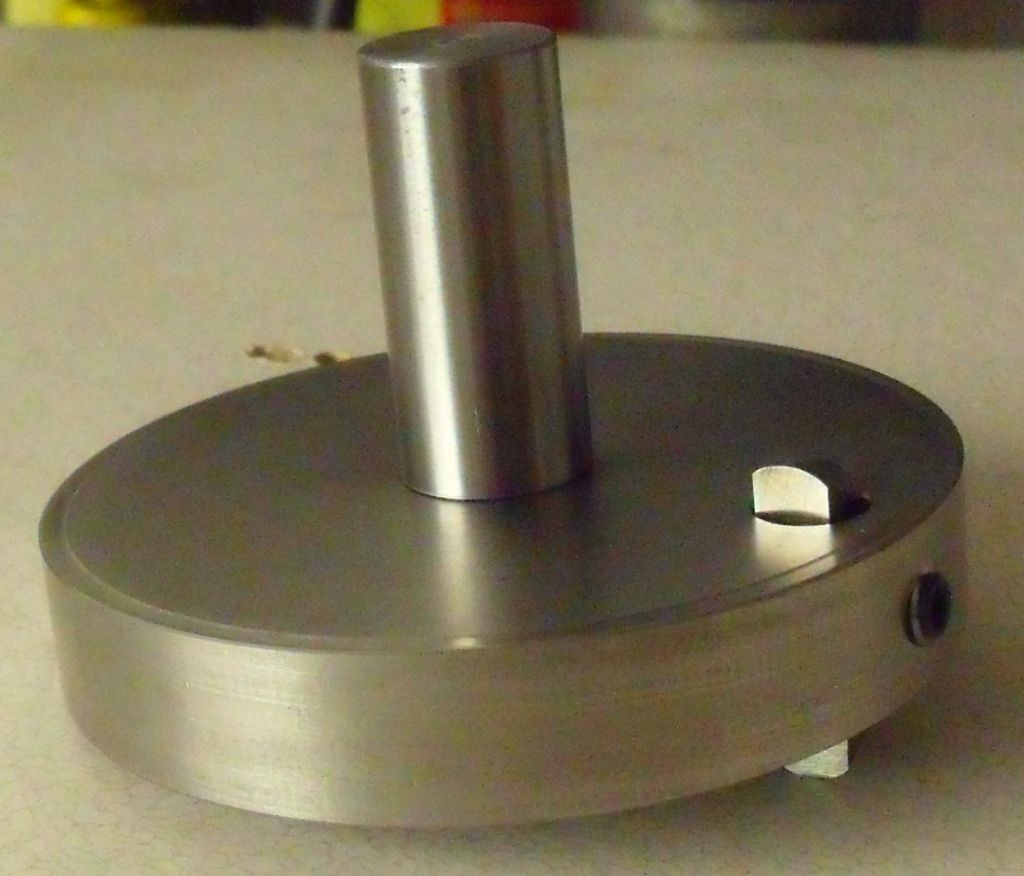

                  I have a small fly cutter which is a piece of 1 inch silver steel turned with a 1/2 inch shank. It is cross drilled for a 6mm diamiter carbide cutter held in place with a 6mm grub screw. I have ground the end of the carbide so that I can slightly rotate to give different angle of rake more for aluminium less for cast iron it works well for me.20170316_071854.jpg

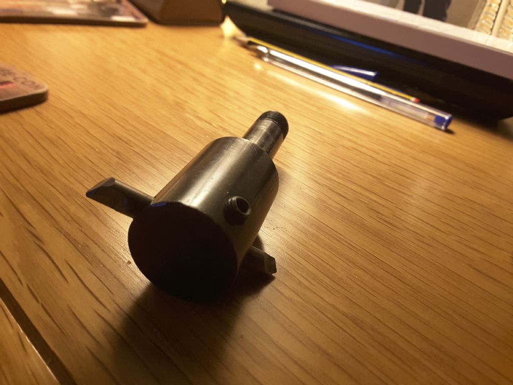

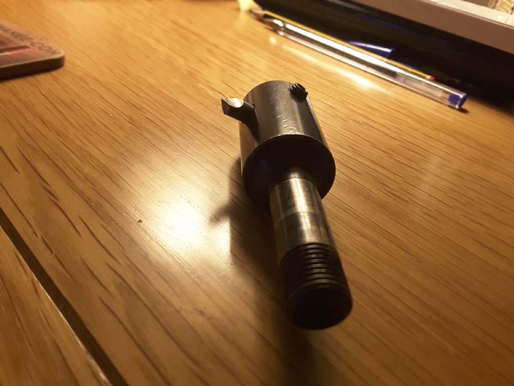

                    I wondered about that too but in making my flycutter I used the boring head with a carbide tipped tool (side mounted) to flycut the 20 degree angle on the head of the cutter. It was a brazed tip tool though not an insert tool and it worked absolutely fine, in fact it made me wonder as to why I,m making a flycutter as the boring head with a suitable cutter works a treat. However I would rather not use the boring head for fly cutting and keep it for its intended use.
                    Picture below of the boring head with a modified carbide tipped lathe tool, as mentioned it works and cuts really well but it is only a stand in until I finish the flycutter.
                    Edited By Ron Laden on 06/12/2018 08:12:36

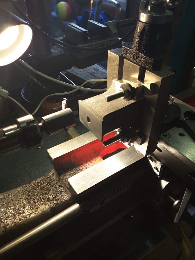

                          A flycutter's whatever you make it to be, and the workholding conditions are as important as the flycutter configuration itself in how well it works.
                          I generally use a standard lathe boring boring bar with a 3/16" square HSS toobit set by caliper to whatever radius I'm wanting to achieve – though obviously that's not usually critical when generating flats. Equally obviously it has limitations on depth of cut when doing it in a lathe.
                          But it will do some quite surprising things:-
                          … as when I was wanting to cut (IIRC) a 1.407" rad to a specific depth in an arc-shaped reinforce.
                          I don't think there's any more fixed answer to what's the best flycutter than there is to what's the best anything else – it depends on what you're trying to do, to what and with what. The best flycutter for the job is the one you've got, that you can make do the job.
