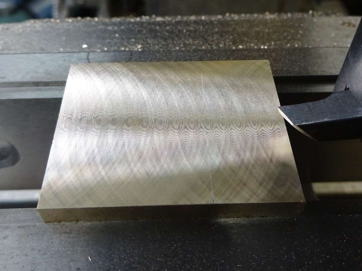

                          #745330
                            A mill that is in tram should give a very slight back cut but it should not be so deep that it removes the cutting marks from the leading cut. You should end up with an almost holographic effect where the (((( shaped leading cut and the )))) trailing cut cross each other.
                            One I prepared earlier on the X3
                            P 49

                              A great picture that shows the effect well Jason. Only a guess since I’ve never measured that back cut swarf, but it likely cuts a few .0001″ at most.
                              There was a post on the PM forums yesterday about using a mill to fly cut automotive cylinder heads. One of the pros there mentioned tilting the head by 1/2 a degree to prevent that back cutting. Personally I don’t agree, for cylinder heads and how they seat or hold against the head gasket, it’s well known you don’t want an extremely smooth or almost reflective surface. One with some slight ridging grips the gasket better once the head is fully torqued down. And fly cutting is only one operation you’d do on a mill, I don’t have any issues checking or re-tramming my mill, but I’m not about to move the head off tram just for fly cutting a part and then move it back.

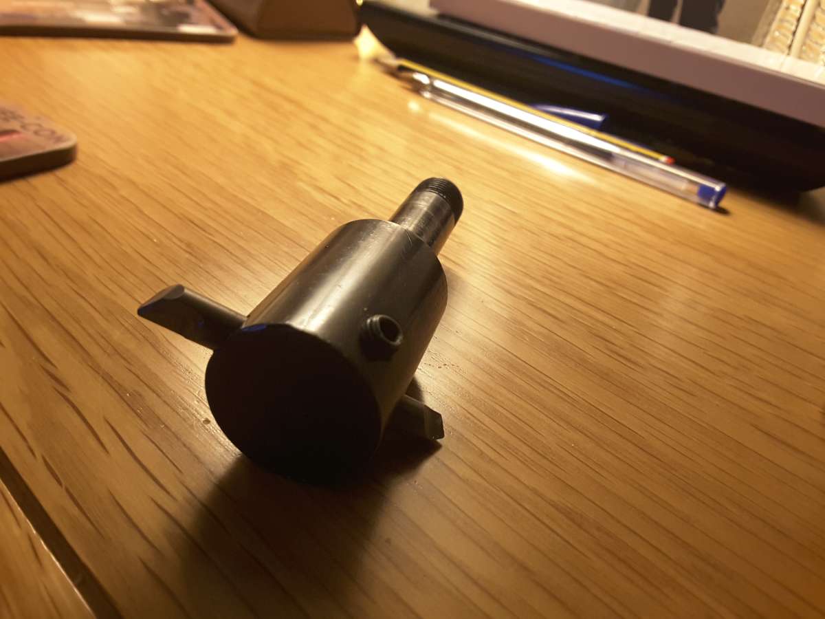

                                      I have a simple fly cutter I made when an apprentice and it has two cutters, one HSS and one tungsten carbide. It is a piece of 1″ siver steel with a 1/2″ shank cross drilled for a Cutter hole at an angle and a grub screw hole to clamp the cutter.  Its my go for skimming cutter especialy when getting a nice finnish.
                                      20181206_080315
                                      Make your own similar fly cutter justs keep cutting.
