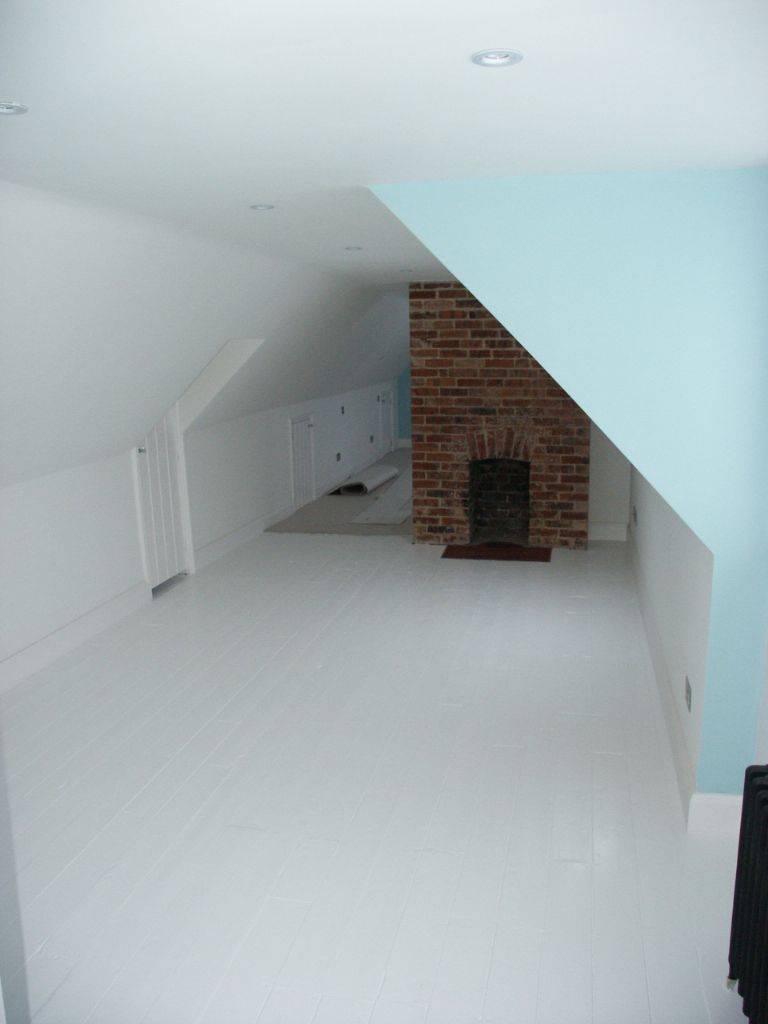

                          pict0155.jpgGood old Dulux Trade oil based gloss, Did a floor for one of my clients daughters about 10 years ago and its still OK, unlike the carpet in her adjoining bedroom that has been replaced twice due to makeup, drink spills and don't ask what else. Luckily 90% of the time its covered in disgarded clothes etc so does not show.
                          Edited By JasonB on 02/08/2019 13:12:44
