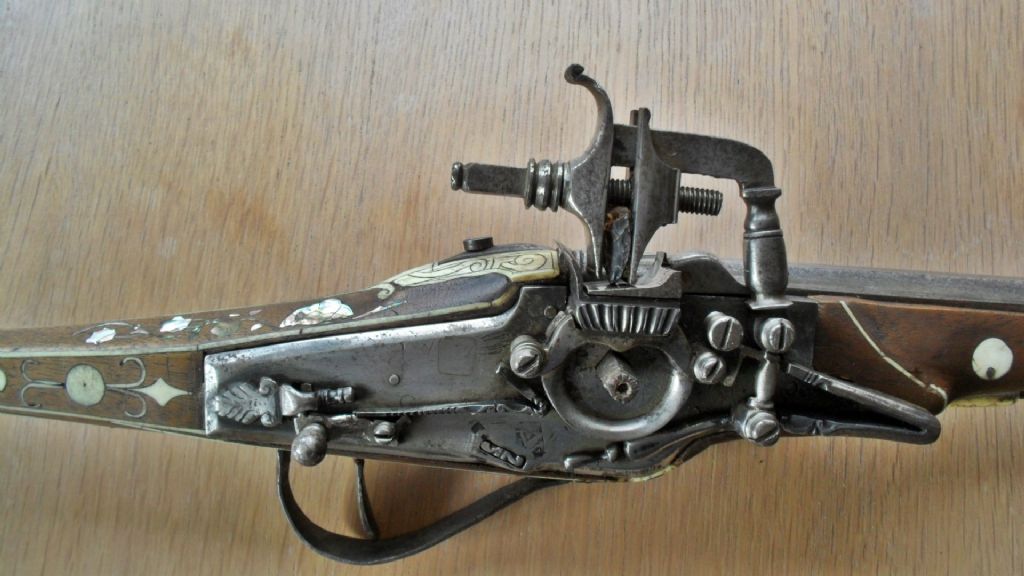

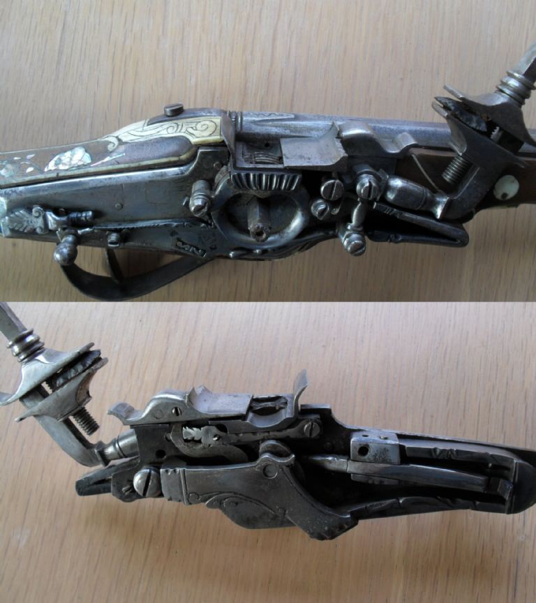

            Here are two photo's of my Wheelock, I need to get in the loft to bring down the gun and take a complete photo showing the entire length and also the back of the stock with incomplete inlay.. If this was an original Wheelock from this period it would be worth £20.000+
            #550278
              Thanks, Vic yes
              Lovely work

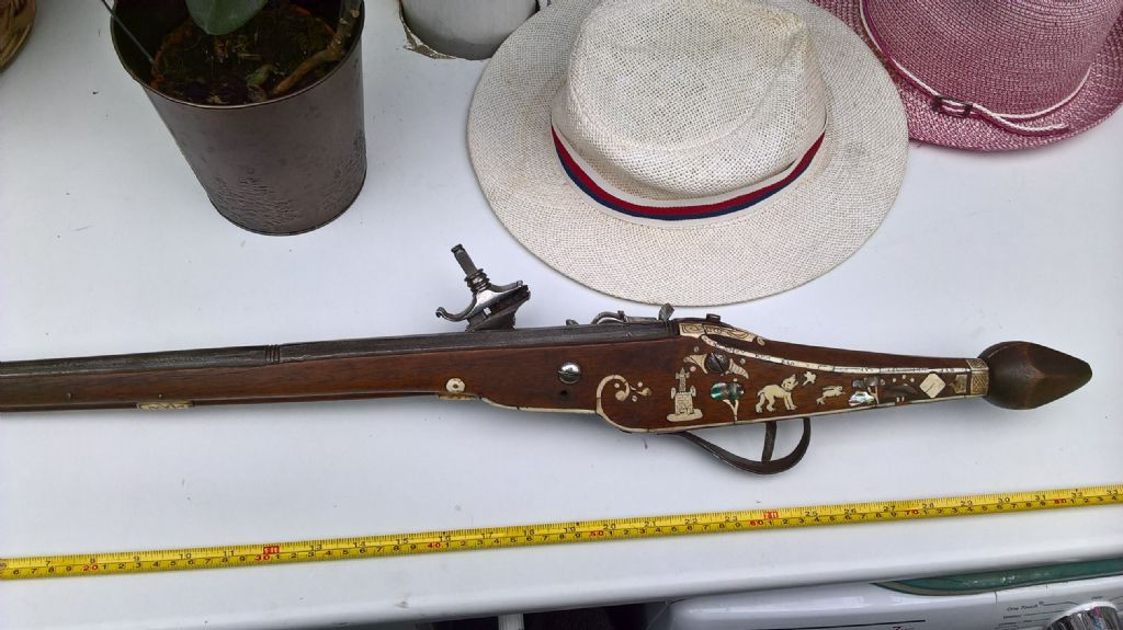

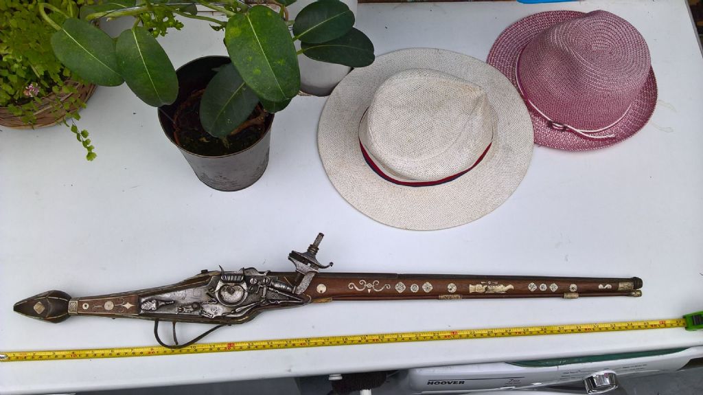

                I've been up in the loft, here is the guns full length, just about 3 feet as was the original I copied, also the back of the gun which is sadly unfinished, perhaps I should resume doing it as I still have a pile of old bone handled cutlery that I originally used.length.jpg

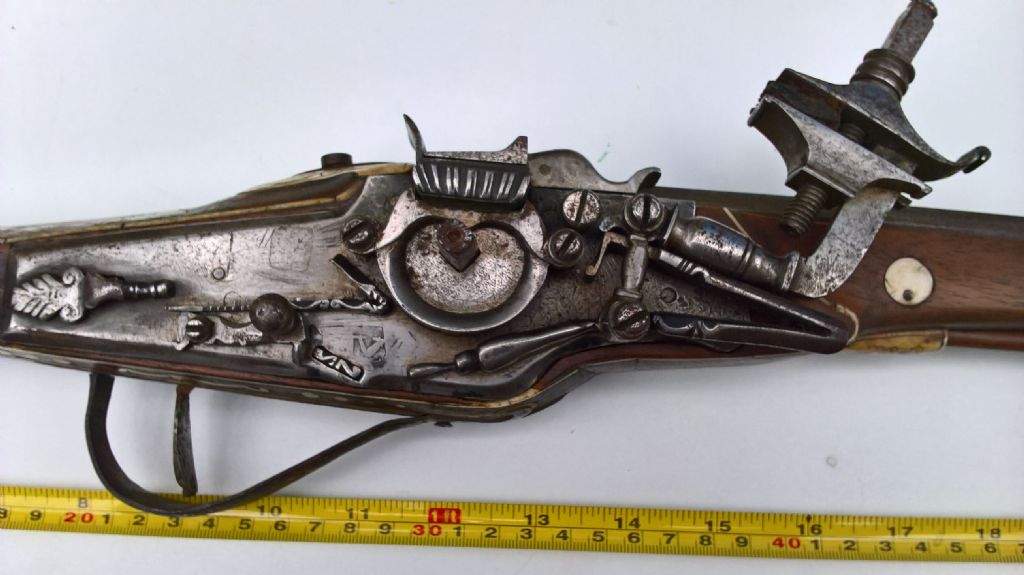

                    Also a close up of the lock, You can see what I made to look like my initials VN this is the end of the main spring support which passes through the lock plate. Other interior support parts also pass through the plate into a square hole and are then hammered to expand before being filed off flat, also visible is the letter 'V' stamped.
                    The original locks would be made from iron and not mild steel as I used, this has a different appearance

                        Vic, definitely finish it and don't put it back in the loft. It looks really good.

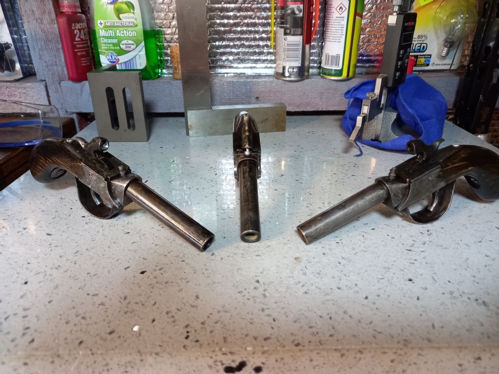

                                        20210612_135224.jpgThe three pistols I made would not even fire a cap, the internal hammer spring is from a clothes peg, the barrel is screwed to the body and is only bored out 25mm. It all works but has no power from the trigger, they are just a working copy of a original pistol. I got the idea to make them as I had to make a spring for the original pistol which was broken, it looked quite a easy task to make a working copy.
                                        Driving a car has more potential to harm, just seems strange that it seems acceptable by the general public seeing a driver on the mobile phone or on medication and not report this to the police. If I hold my hand made pistol out of my surroundings I could be shot on the spot

                                            They look really good Bob,

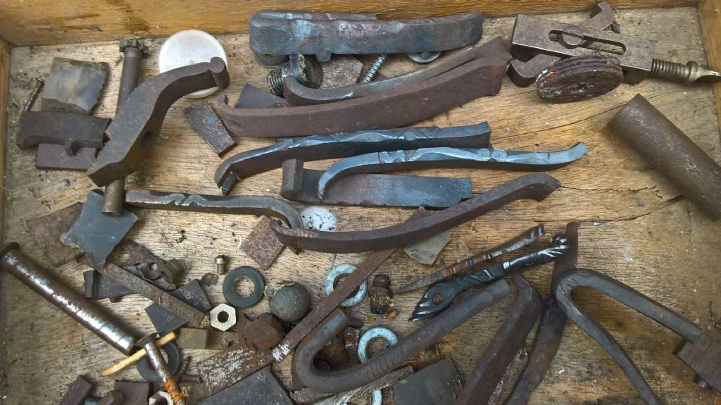

                                            how did you make the hammers? I used a combination of forging, sawing and filing to make mine, all my threads are Whitworth which replicates the coarse threads they used.
                                            here is my box of failed springs from my early days of lock making, mostly caused by following instructions in old books on how to temper springssprings.jpg
