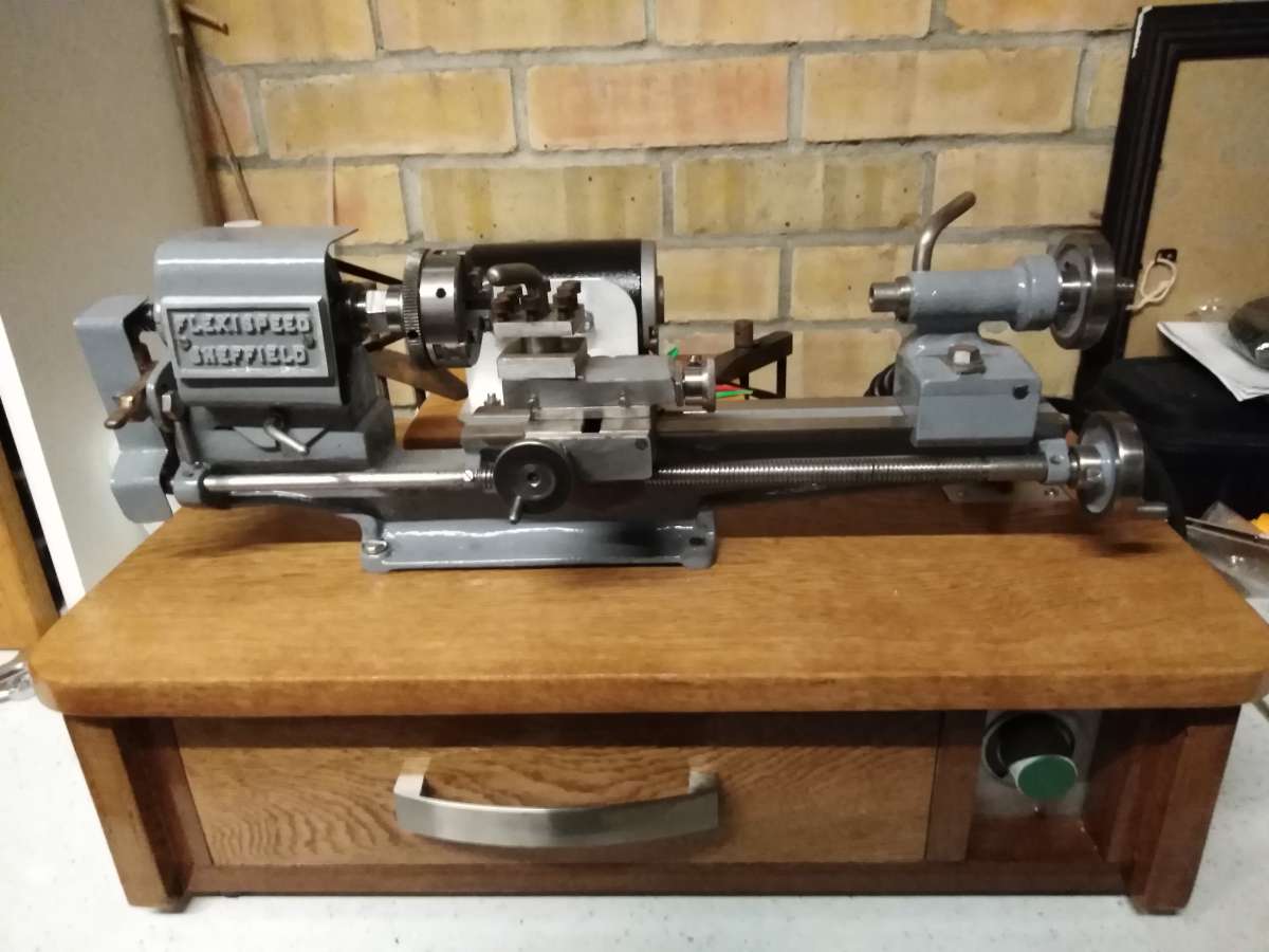

                  A few months ago I posted several threads related to restoring a newly acquired Flexispeed Mk 2 lathe and had lots of useful replies – thanks.
                  So an update for anyone interested (e.g. James A).
                  Although delayed by other projects it has progressed quite well. Photo attached.
                  IMG_20231207_121706
                  – Now fully reassembled.
                  – Equipped with a new brushless DC motor with variable speed control.
                  – Fitted with a new M14x1 3-jaw chuck by means of an adapter allowing the original spindle to retained unaltered.
                  – All mounted on a custom made cabinet (albeit with the motor mount being a temporary measure for now).
                  I’ve used it for a recent clock repair job and find some “fettling” is required.  Cutting performance is poor. I think the main culprit is the drive belt.  Having tried a couple of solutions I’m hoping the one currently on order (8mm Optibelt VB) will be the solution.
                  The other problem was, what I originally thought was a tailstock misalignment problem. But it’s actually a problem with the MT0 Jacobs chuck (retained from my now departed Flexispeed Mk 1). That causes the drill to be off-centre (below) by at least 0.5mm.  SO the next challenge will be to some how fit a new short MT0 to that chuck.
                  So, not quite “there” yet but reasonably positive and worth the effort.
                  Andy

                    I think that you have made a really nice job of restoring the Flexispeed. It looks almost too good to use now. I like the cabinet that you have mounted it on, I hope that you keep it that clean in the future. My machine is positively filthy, I’ll have to see about giving it a clean after seeing yours.
                    Sharp tools are the order of the day for the Flexispeed, also only machine material of known specification. Free cutting steels, brass CZ121, aluminium HE30, gunmetal and most grades of cast iron, provided there are no chilled areas, work well. I never had a lot luck with phosphor bronze and some grades of stainless steel, also parting off was something that I tried to avoid.
                    The drive belts on the Flexispeed are a bit of a problem nowadays, the original pulleys were machined to take an old “A” section belt which was 3/8 inch x about 7/32 inch deep, the modern equivalent the “Z” section is 10mm x 6mm, which I have found to be a bit too deep when trying to go to the largest pulley, not really enough clearance between the pulley flange and the headstock casting. I am loathed to take a file to the casting, I have considered machining new pulleys to use a Poly-Vee belt to make speed changes easier, but so far it’s only an idea.
                    I think you were correct to carry on with the original thread, it keeps all the information together as well as showing the progress of your project.
