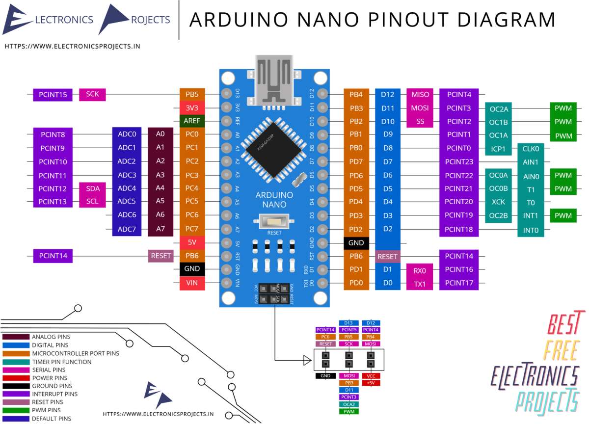

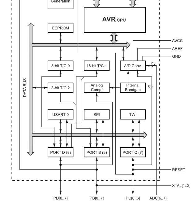

              Here’s the ATmega328P’s block diagram:
              at328block
              Bottom left is a box labelled ‘Port D (8)’, meaning ‘I am an 8 bit register connected to 8 pins, that do digital Input-Output’.  The pins it services are listed on the arrow below – PD0 to PD7.   Next diagram shows how they relate to physical pins on an Arduino Nano, not always logically – PB5 is D13:
              Arduino-Nano-Pinout-Diagram-Image
              The advantage of writing directly to PortD is that eight pins will be switched together simultaneously on the next clock tick. Super-fast and synchronised, wonderful, and the code is simple.
              DDRD = B11111111;  // Set all pins controlled by PORT D to HIGH
              DDRD = B0000000;  // All pins set LOW
              The problem with my DDRD example is that PortD is also connected to Timer/Counter 0, and USART0. (Universal Synchronous/Asynchronous Receiver/Transmitter)   As Arduino Nano Pins PD0 and PD1 are dedicated by Arduino to Serial Transmit and Receive, my DDRD code example collides with a system function.  Eek – don’t do it by accident!   The chip’s other Ports are also shared with other system functions, so proceed with care, and watch out for weird bugs – probably indicate a collision under the bonnet!
              Good explanation of how to read and write ports directly here.
              Excellent technique, but I was James, I’d save it for later.  In his application, I doubt it matters if the second, minute and hour pulses are staggered by a few tens of microseconds.
              Also, when speed matters, the DirectIO library is a good compromise. digitalWrite() wastes a lot of time by checking for conflicts every time it’s called. DirectIO checks at compile time, and doesn’t worry thereafter.    On the downside, DirectIO isn’t quite as bomb-proof, and it uses a C++ template, which is a step harder to understand in the first place than a function.   But easier than writing directly to a port register.

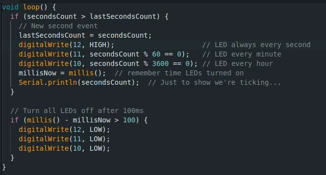

                                      No success here yet, so I’m going to ask for Peter’s help!
                                      I wrote the code needed to set a DS3231 Real Time Clock and for it to output 1 second pulses.   These show millis() is inaccurate, at least for accurate time-keeping.
                                      The Arduino catches the seconds with this Interrupt Service Routine, which as can be seen is very simple.  It lags the RTC by however long it takes the microcontroller to save what it’s doing when a second event is detected, to jump to the ISR, increment the counter, and then restart whatever it was doing before.  Microseconds or less.
                                      jaisr
                                      loop() detects seconds events by comparison, so again quick.  But this breaks Peter’s original code: this doesn’t work:
                                      jaloop
                                      The reason is that working in RTC seconds means millis() inside the ‘if’ counts in close to round seconds so the less than 100 test is never true!
                                      So what’s needed is code that satisfies James’ original question, flashing LEDs when the seconds, minutes and hours roll over.
                                      Latest version here if anyone wants to play.  Note the code that sets the RTC’s start time is a temporary bodge.  I’ll update it later so sets time properly.

                                            This is the best I can do for the moment.
                                            jaledflash
                                            Full code here:
                                            • Optionally sets the RTC with a unix timestamp typed in by the user.   (If pin 4 is grounded at boot. Otherwise assumes the RTC was set correctly earlier.)
                                            • Uses Duncan Webster’s interrupt to count the accurate second pulses emitted by the RTC SQW pin.
                                            • Uses James’ compare technique in loop() to detect second events.
                                            • Uses Peter’s modulus arithmetic to switch the LEDs on.   But I had to use the compare technique again with millis() to turn them off 100mS later.  May not be the simplest possible solution.
                                            • Contains most of the code needed to get a DS3231 RTC module to work, including how to extract human readable date-time info.
                                            Many improvements possible!  For example, setting the RTC involves the user getting the latest time off the web, which might be a few tenths of seconds out, plus however long it takes a slow-mo human to cut and paste it.   Better to write a program on the PC that removes the need for a web search and human delays; then the RTC would be set to better than 0.1s*.   Also the way I set time may not suit James, who mentioned buttons.  His method is extremely common; no need to connect a kitchen cooker to a PC to set the clock!
                                            The seconds are considerably more accurate than the 0.1s pulses measured out by millis().   The seconds come from a good temperature compensated crystal oscillator in a competent Real Time Clock module.  millis() is based on a wobbly ceramic resonator – fine for most purposes, but not a precision time source.
                                            Probably mistakes too…
                                            * Note for time-nuts!  By default UNIX machines frequently correct their clocks by polling NTP time servers on the web, so bog standard Linux is unlikely to be more than 100mS off Atomic Time.   Windows, by default, is less fussy, and can drift further off, especially if running on older hardware.   When accurate time is important look up how Windows is tweaked to poll time more often.
