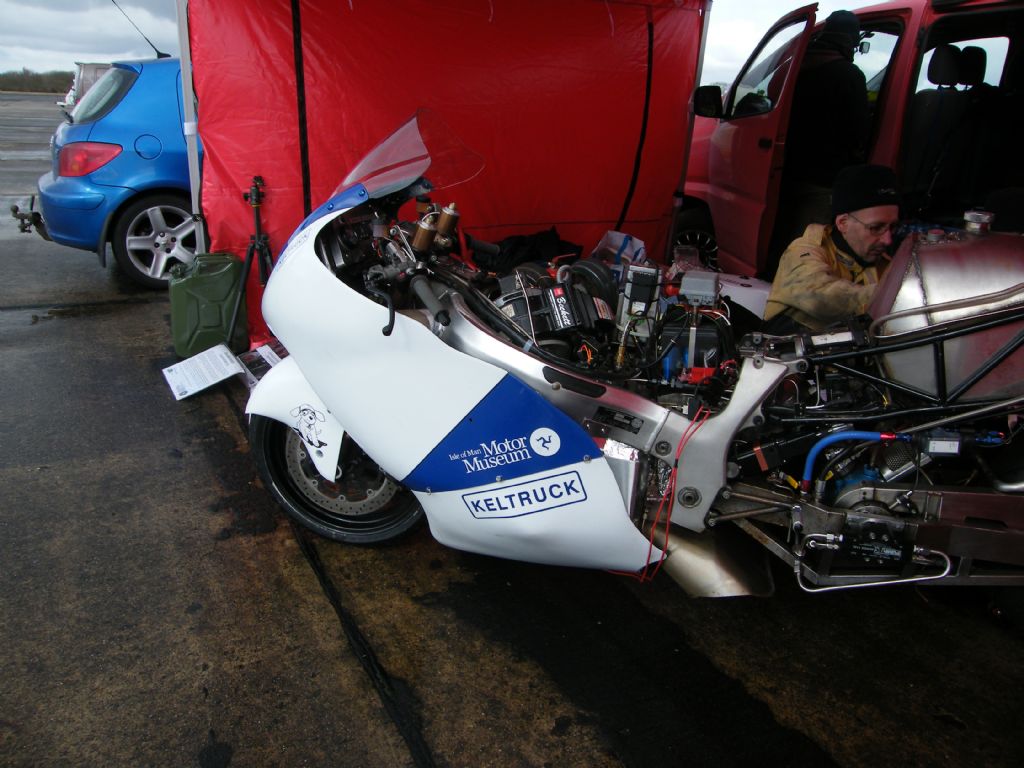

                                      With my new full scale project I know there will be some hassle for its generator it can depend on your insurance company have found you must stress it's a generator.
                                      There are plenty of certified safety valves about but I found any pressure release at speed causes overheating of the tube.
                                      If the various mechanical control systems like Dobles or modern electronics can be used that might be an answer.
                                      If you can get Doble Steam Cars, Buses, Lorries and Railcars by J.N.Walton it's worth reading but can be a bit pricey. .
                                      The photo taken of a steam bike this year is a mixture of old mechanical technology and modern electronic control systems.

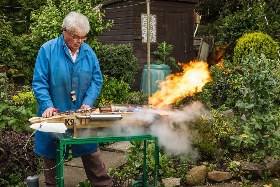

                                              Posted by JasonB on 04/06/2018 07:59:09:
                                              Thanks for the confirmation Windy.
                                              Still not sure if Jon would want to risk sitting behind a flash steam setup like yourssurprise
                                              Can anyone spot the difference between that photo and the one on the cover of MEW 231?

                                                In an older (80s, 90s?) ME or MEW there was someone who proposed a 'revolutionary' steam generator for models that used stainless pipe.
                                                #356520
                                                  Posted by Neil Wyatt on 04/06/2018 19:30:12:
                                                  The one on the cover was taken slightly later after the washing line had burnt down.
                                                  Poor photo editing as the top of the pole was not removed
                                                  Edited By JasonB on 04/06/2018 19:38:45

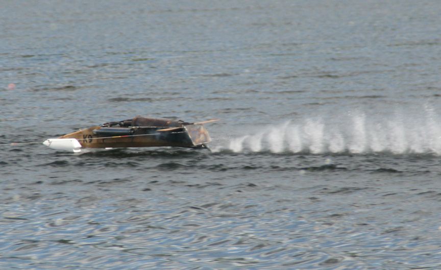

                                                    I am only testing the waters to see if any one might be interested.
                                                    Due to certain health issues I have decided to sell my Flash Steam Tethered Hydroplane.
                                                    As far as I know it’s the Worlds Fastest at the present time.
                                                    It would be sold with any spare parts including generator coils, history, engine set up details.
                                                    Have an enthusiast who is interested and he would be given first choice if he can better any offers to buy.
                                                    Please note this is not a show machine purely functional with battle scars after 130mph plus take offs.
                                                    Have the video’s showing that and many other fast runs.
                                                    Keep this in mind it’s experimental if run after every meeting you have to strip and rebuild it also things might need repairing or making.
                                                    Flash steam hydroplanes are not for the faint hearted to compete with one means you need a machine workshop not just a few spanners and the will to continue developing it a full time job.
                                                    Might be used just as an exhibit in that cases no work required.
                                                    Being a Yorkshire man I do not have time for tyre kickers only genuine interested people will be shown it time waiters will get the boot.

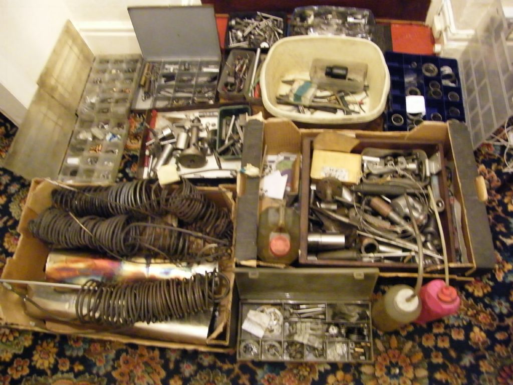

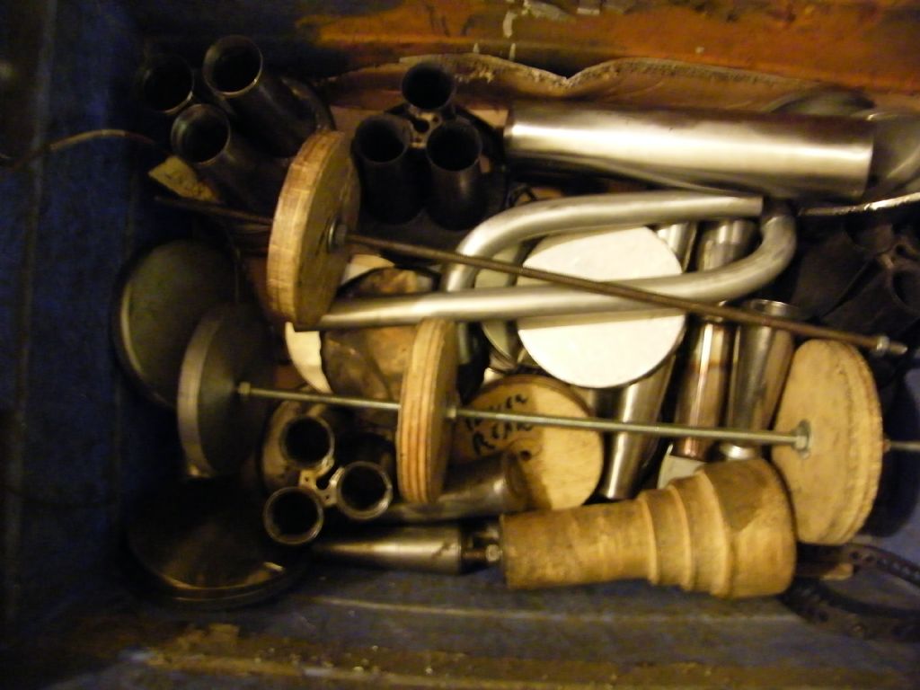

                                                      There are years of accumulated parts engine spares, special tools simple jigs three generators and parts that I can’t remember what they were for.
                                                      Despite feeling dodgy on my pins at times I find riding a motorcycle at Elvington after many years no worry and have been offered a ride on a 150mph machine.
                                                      This is to prepare me God willing for my full size flash steamer there is a great deal more work to do yet as time is moving at a fast pace.
