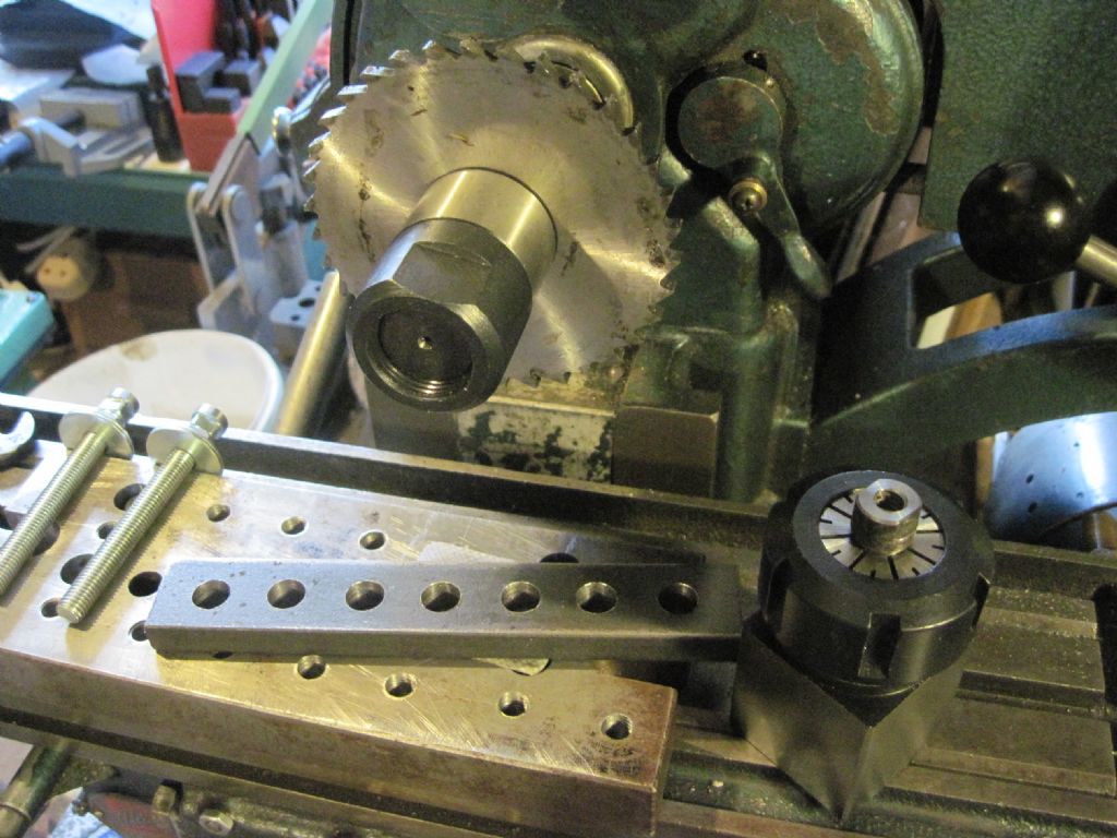

                        I had a similar problem with my small Atlas MF – which also only has a single central bed 'slot'
                        Fortunately, I had a steel plate (from a die casting machine) that had some existing holes that I tapped & added too. It's normally attached by two special bolts that fit the open ended slots (pre-existing) you can see but in the photo I needed to set the ER32 collet block back a bit for the horizontal milling and I used two of the fixture 'holes' for the table t-nuts instead.
                        Here I was milling flats on a part held in the ER collet. I did originally purchase a slotted table for this purpose but it's been used elsewhere as this (longer) lump seems to do the work just fine. Mine is about 25mm thick but it could be half that without any issues I think. I haven't bothered to thin mine down as yet.
                        It's also very useful to make a clamping bar to match the plate holes!

                        PS The slitting saw in the second photo was being put on for another job when I took the photo to show the clamp bar etc from the previous work. This is a useful workshop diary/reminder – as my memory sometimes fails me. I sometimes find bits that I know I've made but cannot for the life of me remember why!
                        Digital photos really help me jog my memory these days! wink
