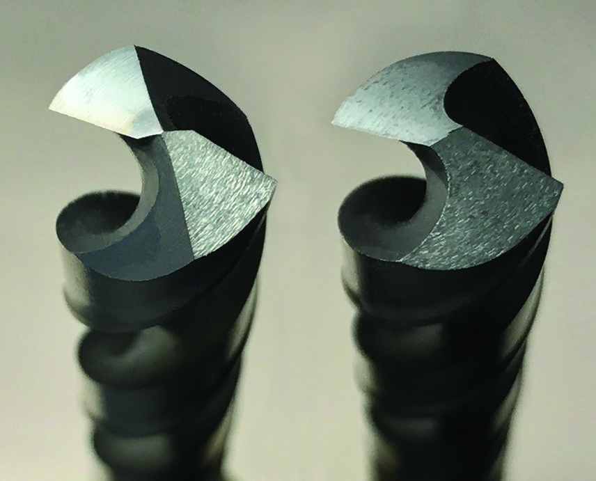

              blowlamp
                @blowlamp
                Posted by duncan webster on 28/05/2022 01:47:30:
                Having had awful trouble trying to drill ally bronze how do you do it? It seems to shrink onto the drill and seize. Gave up eventually
                Try using a split-point drill, like the one on the left.
                Martin.
