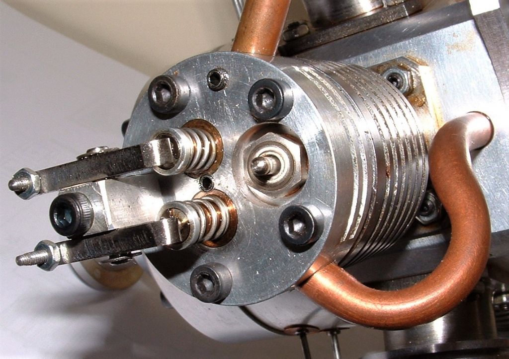

                      The method I used to retain PB guides in an ally head on a model engine was to drill and tap halve in the guide and halve in the head and insert a grub screw.
                      The guides were fitted into a heated head so what I did was belt and braces.
                      Emgee
