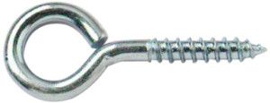

      Chris, you could possibly use a screw-eye, not tried this but cant see why not.
      Lead is so soft just drill a small hole to depth and screw in. you could use thread-locker but probably not necessary.

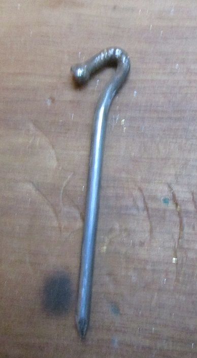

        Posted by Journeyman on 27/01/2020 10:30:43:
        Likely to be much safer than the previous repair yes
        … which looks like a rather ordinary wire nail
        [Chris] If you do pull the nail; please let us know how short the engagement was.
        P.S. not all screw-eyes are created equal … try to get one with ‘full’ threads

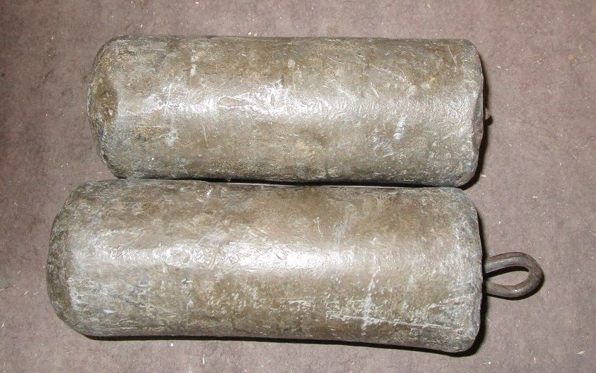

            Unless I have missed some important detail … we don’t yet know how the original was fixed, nor indeed the full shape of the eye on the other weight in the pair.

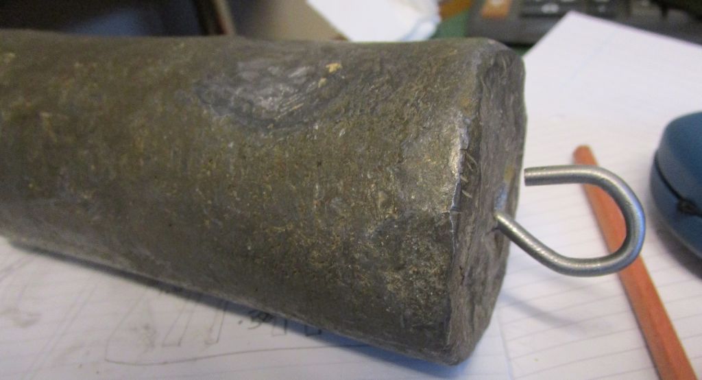

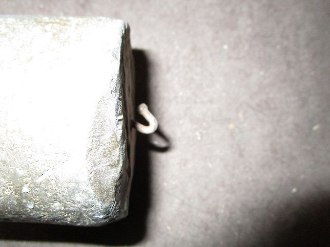

              Posted by Chris TickTock on 26/01/2020 09:06:48:
              hi guys photos to help see the issue. Remnant of previously probably sheered eye bolt is the issue as it makes drilling difficult but no real alternative other than leave alone which goes against the grain with me if something is reasonably doable.
              Chris
              This is what we know ^^^

                hookreplaced.jpgnailfrom weight.jpgOK I decided to do something about the nail as it looked awful and possibly dangerous. This is not a top class clock by any means but there are limits. note nail pulled out easily, there was nothing left sheered in the centre so i got lucky. I drilled a 10mm hole to put a nut on so hope is at least safer.
