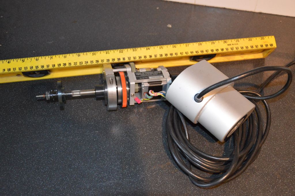

        I have just purchased this superb mechanism from a fellow microscopist, who saved it from the Skip !!
        For very good reasons, it has a Five Phase [ten wire] Stepper Motor; so I now need to find a suitable Driver for it.
        Can anyone please suggest a modestly priced Driver Module, or a suitable DIY circuit ? … Frankly, I am out of my depth with this one.
        Edit: Here is the datasheet [in German ] … it's the one in the Right-hand column on the first page.
        Edit: and here is the explanation of why 5-Phase is Good.

        #166935
        jason udall
          @jasonudall57142
          Michael..
          I have had to do it ( 3 phase) .
          I had to do it with an audrino …
          The programme is simple enough.
          You will need 5 1/2 H bridge drives..but it depends on voltage and current requirements. .but the ( iirc ) l293 provides 4 half bridge. .at 2A each coil..
          Simple break out boards exist…
          Biggest trick will be getting the adjacent nodes sorted.. ( they are generally used in the five sided version of “DELTA” rather than star..)…
          Let me know if you need further. ..the programme is simple enough but you need to already doing the audrino thing…again if you need help…

            #166946
              Jason,
              Many thanks for this.
              Last night, I did eventually find a helpful article … but my electronic construction skills are not in his league!
              I would certainly welcome your guidance, and will send you a P.M. this afternoon. I have no experience with the Arduino, but I am very willing to learn, and I know there is plenty of tutorial material around.
              In the first instance, I'm sure that full steps will suffice: I am led to believe that the unit came from a custom-built laser scanning microscope … so my humble aspirations in the field of optical photomicrography should be an order of magnitude [or two] less demanding.

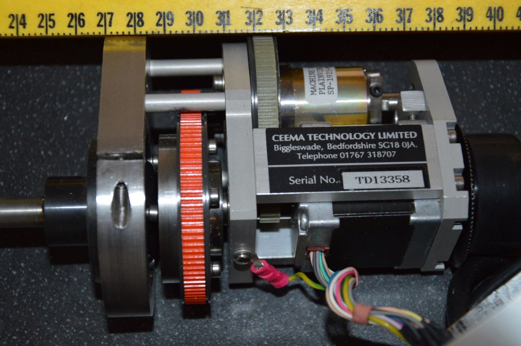

                        #166982
                        jason udall
                          @jasonudall57142
                          Btw looks like either an encoder or a rapids motor hidden behind thestepper….
                          #166983
                            Thanks again, Jason
                            I will send a P.M. with my eMail address, which may be more convenient.
                            #166986
                              Posted by jason udall on 19/10/2014 11:46:07:
                              Its actually a clutch; and the two "gears" that are visible are flat belts [or maybe timing belts, used inside-out].
                              These two photos were provided by the seller … I will take some detail shots next week.
                              Edit: Machine Components Corp. were very helpful in identifying the "slip clutch" for me … as a special item, which is not in their regular catalog.
                              Edited By Michael Gilligan on 19/10/2014 12:00:34
                              Edited By Michael Gilligan on 19/10/2014 12:01:06
