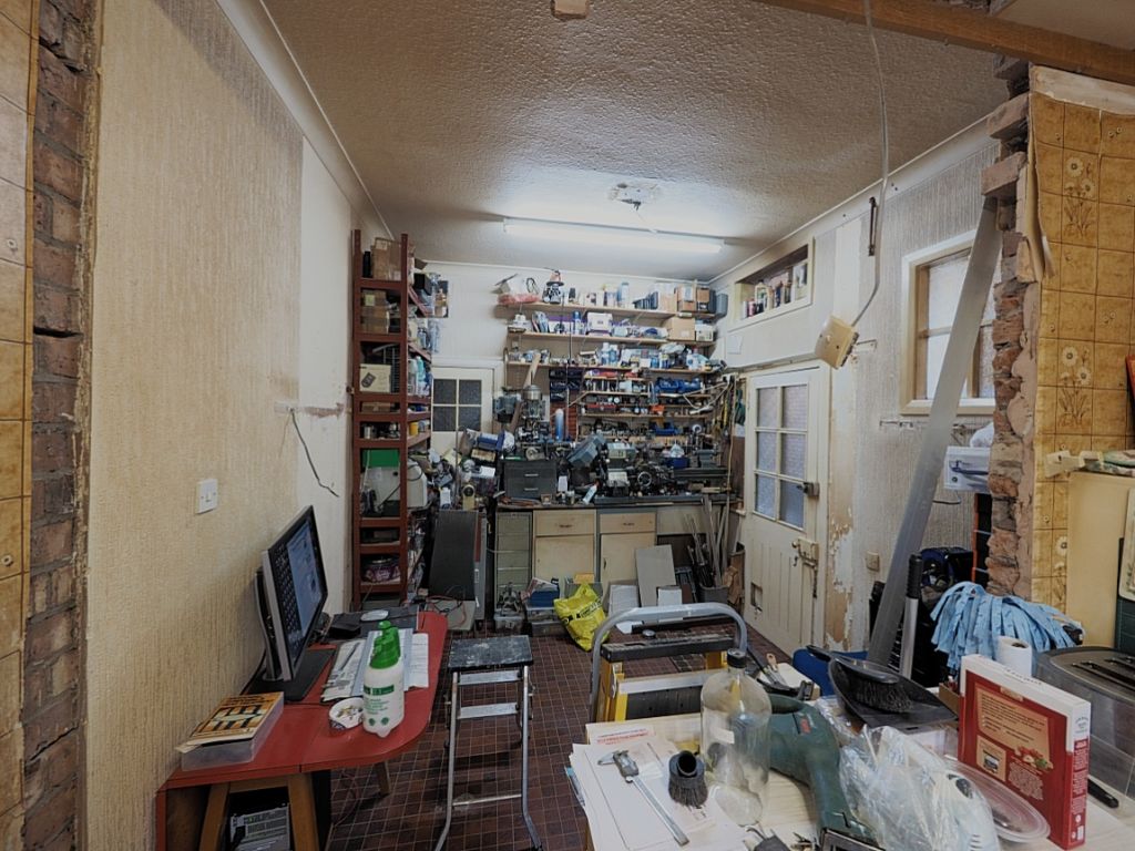

Photo with me new wide angle lens. The depth distortion is pretty impressive.
It looks like Panasonic do what Olympus do with 7mm focal length and jpg correction – it's probably actually 6.5mm. More width is available from raw. I'd didn't fancy the size, weight or price of the Olympus one.
I finish up with a workshop 5' 4" deep with room for more racking. The false ceiling behind the shot is removed as we need to extend it.

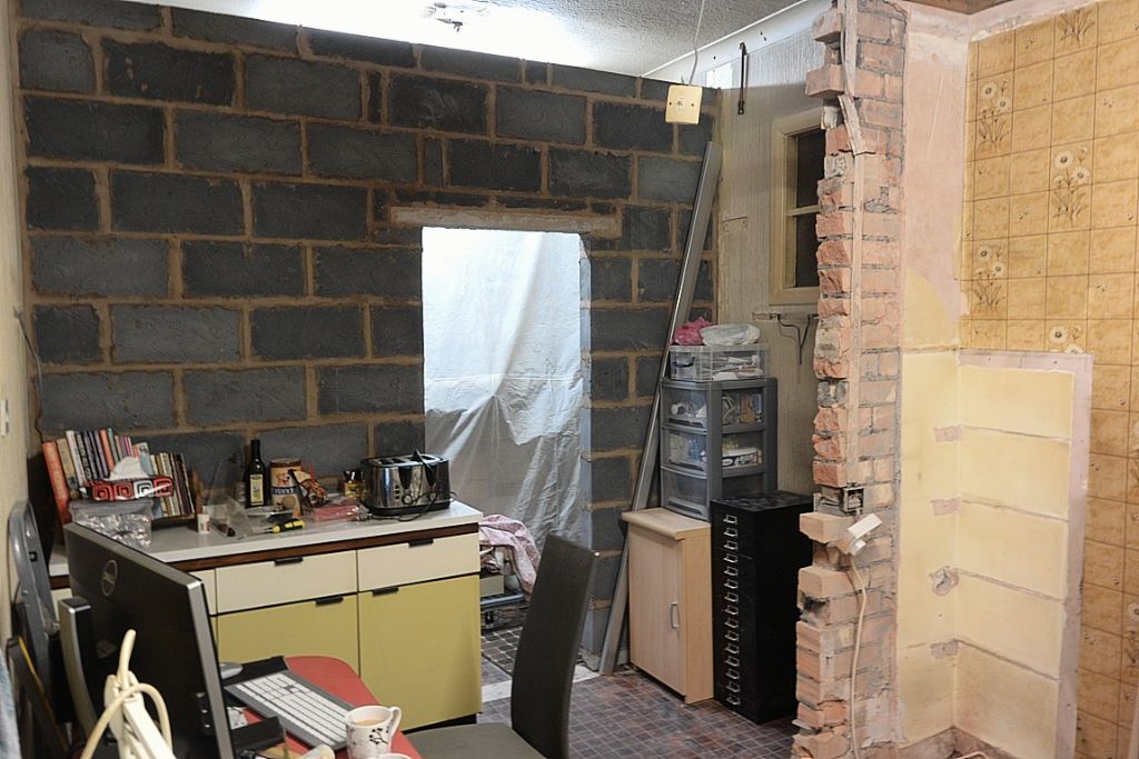

Had to wait a week for a wall builder. 2 blokes most of a day. Cost £600 plus a pair of low step ladders but I gained 7 sheets of plasterboard for the ceiling and 2 sheets of 9mm plaster board for making good walls. I will need some more of that. Doh – should have asked him to bring half a dozen.
Here's me workshop wall.
Talking to the builder he says that they mostly "dot" walls these days. This involves covering the wall with dots of adhesive and then pressing paster board flat onto it. I might compare the cost of that plus a sealer Wickes do against getting a plasterer in. I can try it out on the ceiling / wall repairs.
I've trimmed some wall plaster back. As I thought the wall underneath is flat and vertical. The plaster was out due to work done after it had been build. It can be fixed up true for the kitchen cabinets using timber and plaster board.
