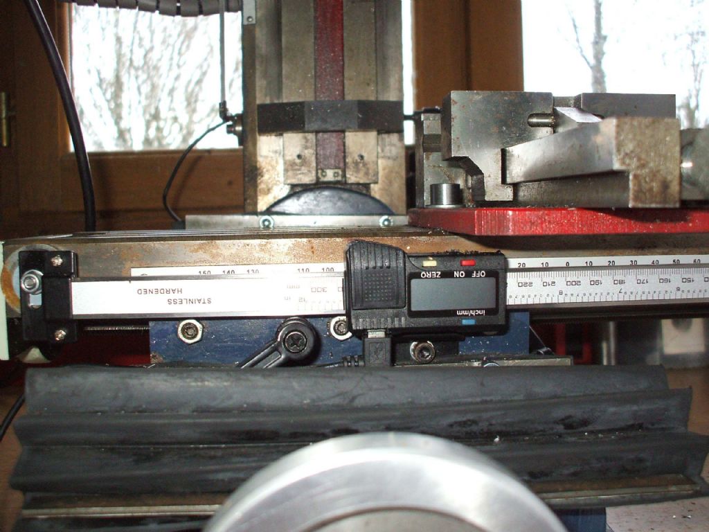

                          Hi Andrew, I fitted my Arc one on the front of my mini mill with a guard over it, OK it hides the gib adjusting screws up a bit, but are still able to be adjusted, albeit a bit fiddley and I made an extended locking screw to lock the x axis. Photos of how I done mine DRO for mini mill none of the two Arc ones have given me any trouble.
                          Regards Nick.

                            When I fitted my first mill with Capacitance scales from ARC, way back in 2012, I fitted the X-axis scale to the front with no problems with access to the gib screws or interaction with the bellows:
                            X-axis DRO
                            You will note that the scale is mounted upside-down. That was so that the vice didn't get wiped off the second time it passed the read head – yes, that happened the first time! I used the scales with a remote readout, so the whole kit was powered from the mains through a wall wart. No dead batteries! I see that the design is subtly changed in the intervening years and seems better suited to such an installation now. Photos of the other two axes are either side of the photos of the X-axis (above) in my album: X-axis dro installation on Amadeal XJ-12 mini mill.
                            That mill, by-the-bye, looks to be very similar, dimension-wise to your Sealey 2502.
