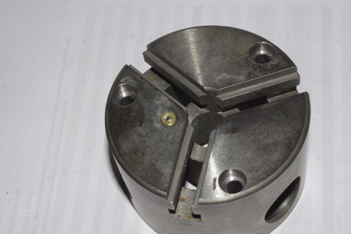

      I have great difficulty changing chucks on my little lathe. There is not much room to get 6mm nuts between the headstock and the spindle flange with my very arthritic fingers. The original chucks got changed for Sanou 80mm three jaw scroll and a 100mm four jaw independent which are slightly better. The 100mm was made front mount and the rear register was bored to fit exactly the same as the original 80mm four jaw. I was thinking that with a 90mm diameter by 20mm thick steel bar offcut, a split backing plate could be made with tapped holes inline with the spindle flange holes. The backing plate would have SHCS clamping the halves together across the split. I could get a piece of en24t in this size easily, or possibly use aluminium with Helicoils in it. Making the 80mm front mount is a piece of cake, simply drill the body through the rear mounting holes with a 6mm and counter bore for SHCS at the front. The holes are outboard of the scroll and not near the jaw slots.

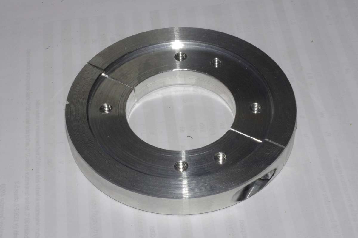

            Too late for any widgets, I made the ring from Aluminium, using up about 3/4″ of the end of a 4″ bar that I had bought, but cannot remember why, old age getting the better of me. The 80mm chuck body got the front mount modification. The ring was cut in half after everything else was complete, including the 6 off 6mm threaded holes. The photos show the plate viewed from the side that sits against the lathe spindle flange, the other side is plain and the threads are 10mm in length. The length of thread in quality aluminium did not require Helicoils for the ammount of chuck changing I will be doing, and the SHCS are 62mm long, both chucks are the same thickness._IGP3477_IGP3478

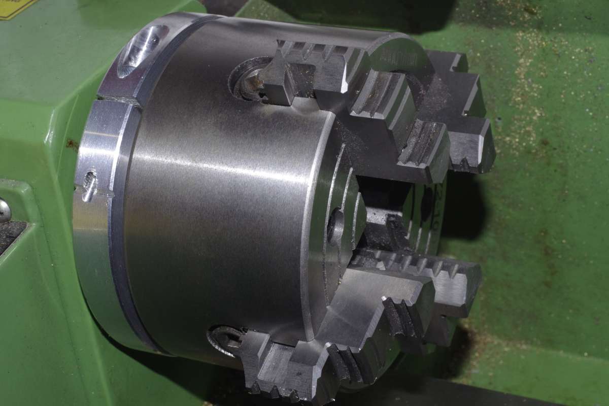

            old mart
              @oldmart
              This is what the 100mm four jaw looks like with the backing plate. One thing which has helped chuck fitting is to drill the holes through the chuck body for the 6mm SHCS to 1/4″.
              _IGP3493

              Ian P
                @ianp
                I dont have a minilathe but I understand that normally there are studs sticking out of the back of the chuck that pass through holes in the spindle flange. Seeing your front mounted chuck conversion (which make a lot of sense) why not just drill and tap the three (or four) holes in the flange itself so the split aluminium parts is not needed?
                If the flange does not have enough meat for decent threads then it would be straightforward to make ‘hank bushes’ and set them in two halves a large ‘washer’ that sits behind the spindle flange. The washers would stay on the spindle during chuck changes if the flange holes were slightly countersunk to accepted suitable reduced head countersunk fixings. I am assuming that the flange and half washers would be drilled and threaded for 3 and 4 jaw chucks. so whichever particular chuck was in use there would always be the unused threads available.
                Or am I missing something?
                Ian P
                #777065
                old mart
                  @oldmart
                  The spindle flange already has six holes of about 7mm in it and for direct threaded holes to be added could be done in situ with a round drilling jig, and careful positioning. I don’t know how hard the flange is for tapping, that would be a factor. Doing this mod to a spindle that was removed from the headstock would be simpler. The alternative would beto increase the size of the existing holes for captive nuts. There arealways a variety of solutions to these problems.

                    #777292
                    old mart
                      @oldmart
                      The picture of my front mounted 100mm chuck does not show that the chuck had been turned and bored in a larger lathe to get the correct counterbore to fit the mini lathes flange as well as producing the front mount holes. The 80mm size four jaw independent chucks fit right on with the rear mount, but I don’t know whether they could be made front mount like the 80mm three jaw scroll type.
